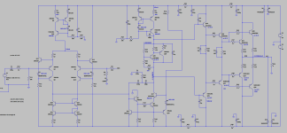

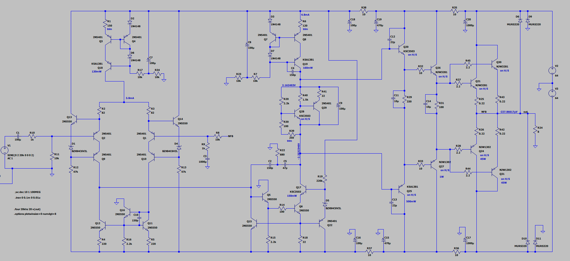

Reference discrete amplifier inspired by Wolverine and Cordell book

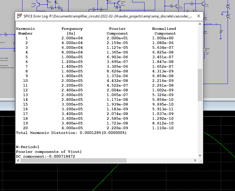

At this point I feel like it is mostly about fine tuning performance at 20kHz.
Comes down to finding balance between nice clipping behavior and low THD20 rating.
Reducing LTP degeneration resistors to 82R gives lower THD20. I tried reducing down to 47R but that is where it is breaking into oscillation.
Bootstrapping VAS cascode aids in negative clipping behavior.
THD20 reduced to 0.000128% as a result.
THD1 stays at 0.000009 just like before.

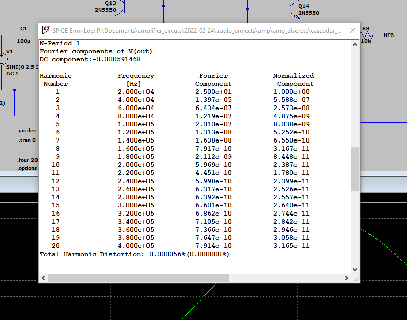

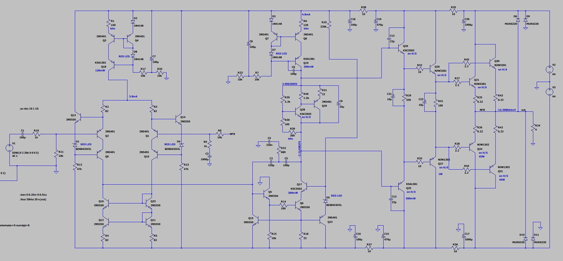

Changed supply voltage to 64V.
Changed load to 8 ohms.
Changed input A to 2.5V
THD20 is now 0.000056%
THD1 is back to 0.00001% 😭😂
included trace inductance and some output capacitance to ensure ef3 suitability
That will be the next step. I have Cordell's book as reference it provides EF3 equivalent schematics with stray capacitances and inductances specified. Will be fun to tinker with those.
By the way, is it better to add cap multipliers comparing to beefing up CCSs? Meaning for PSRR?
Red led is less noise then zener
Looking nice! You are way ahead of me obviously in the amp design and simulator.
But the idea behind using two transistors were to bootstrap each cascode independently.
It can also be biased by just using zeners or LEDs.
I tested for clipping and it looks like adding booster cap around 150p to the BC junction of the CCS transistor helps to reduce oscillations.
Increasing cap to 470p completely gets rid of oscillations while clipping, but increases 20khz THD.
I replaced CCS transistor with another diode as it is more practical to use higher power dissipation transistor instead of dual SMD package like I planned before.
Your OPL looks really nice and flat! I wonder how did you get it?
Thank you for input!
Red LED is less noisier then zener. I don't see any advatage to bootstrap the each cascode independently.
What you call OPL is LP (Loop Gain).
THD at 1kHz simulated is 0.000072% and at 20 kHz is 0.000110% for this conpensation method I used (OITPC). Be careful how you use TPC, revers the caps order.

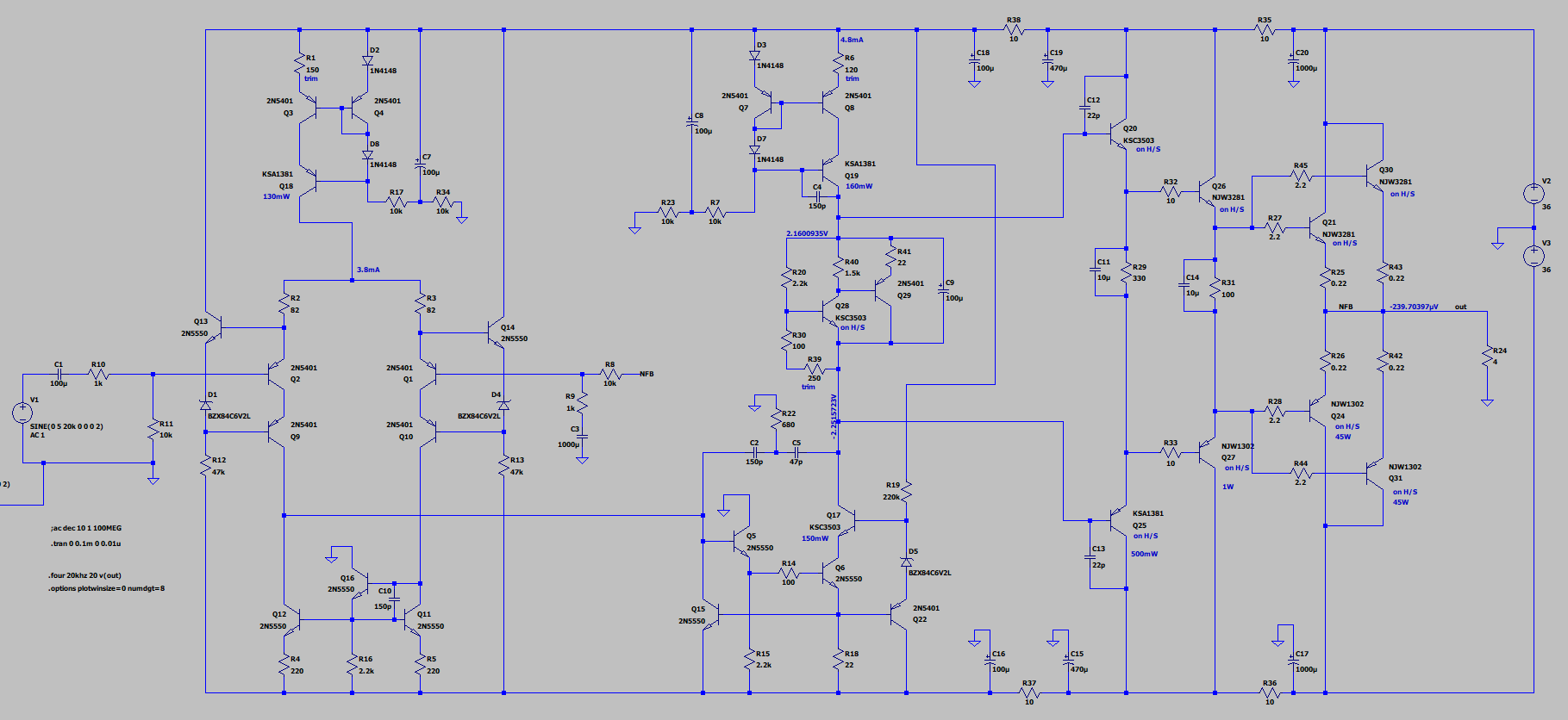

Fun continues!
Cascoded Constant Current source supplies current to cascoded and bootstrapped Long Tailed Pair that is in turn loaded to the cascoded Current Mirror. Ah, the perfection!
Voltage amplification stage is beta enhanced and cascoded. Cascode is bootstrapped too! (I think if I implemented that correctly???)
VAS constant current source got cascoded as well!
Red LEDs everywhere!
Useful in a sense that they can help when debugging the actual board.
Vbe multiplier unfortunately cannot be cascoded and complimentary feedbacked instead...
Can EF3 OPS be cascoded? lol
On compensation:
Two pole compensation.
Increasing R15 (VAS E resistor) from 2.2k to 10k got rid of a peak in OLG around 1 to 10 Hz region.
Adding 220n cap to the ground removed second peak.
Clipping:
100p booster cap across VAS CCS BE helps to recover from positive clipping
Q15 in conjunction with R18 limits negative clipping
R14 helps to reduce excessive current applied to Q6 base.
Any comments?

You still cal it open loop gain (OLG), it is in fact loop gain(LG), means just value of available negative feed back.
By the way, insert protection resistor betwen Q5 collector and the ground, it serves in case of cliiping to limit the collector current.
