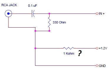

Thanks Eldam! Now I understand.You must add a 0.1 uF minimum cap (film or ceramic) between rca and spidf in+ (but if you are absolutly sure than your streamer has already one before or after its pulse transformer in serie on the signal : if any doubt put the 0.1 uF cap or more in serie - DC pulse signal must be avoided and a pulse transformer is not enough here-)
Thanks Soren!I wouldn't remove the 330R, it's still needed as the LVDS receiver is 100R input impedance and SPDIF is 75R....
So it looks like this?:
Do I need the 1K resistor?
