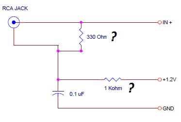

What is the "strategy" if the commercial has already an output traffo with its spidf ? We keep just the 330 ohms shunt and the 1.2 V PS layout ? (believe I already asked that but had a silence !)
I wanted to ask the same.🙂
You can then connect it GND to GND, Signal to where the trafo + connects, but with a series capacitors, any value around 0.1 uF.
The important when using the LVDS receiver is that it need to be biased around 1.25V as the common mode input range is 0-2.5V.
Could someone do a drawing of this? It is not absolutely clear to me. Thanks!
Is it like this?

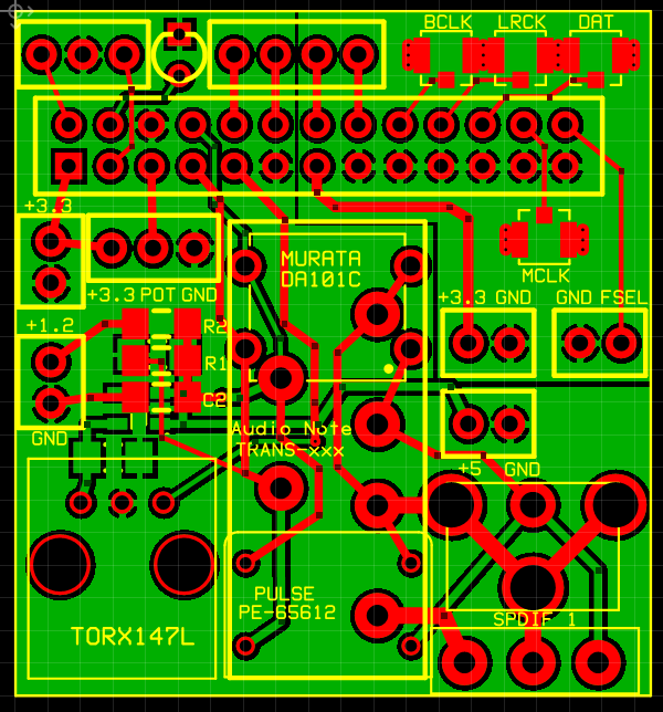

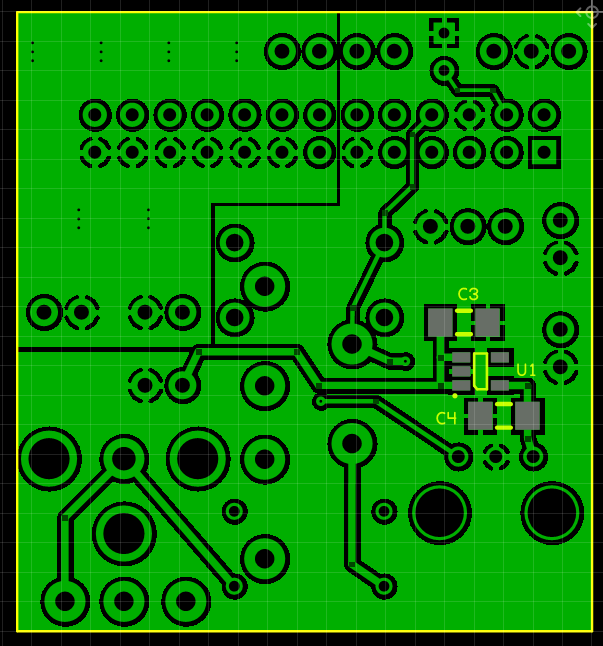

Attached is the last layout of the board where in addition to the Audio Note I added the transformers Murata DA101C and Pulse PE-65612.
@AR2, I can't found the datasheet for the SC947-02LF. If you have it please send post here or send me by PM.
The U.FL connectors have been moved back on the top side.
The board is 39 x 42 mm and doesn't need any standoff, will be solid just plugged in the 26 poles connector.
I will produce anyway a small quantity to have it when I will receive my DAC. The board is so simple that I don't think that I will have any debug to do.
If you have any interest I can run a GB... increasing the number of board will decrease the unit price.
In case, in order to don't make confusion in all the technical discussions on going here, I will open a thread in the GB section.
Enrico

Is it like this?
You must add a 0.1 uF minimum cap (film or ceramic) between rca and spidf in+ (but if you are absolutly sure than your streamer has already one before or after its pulse transformer in serie on the signal : if any doubt put the 0.1 uF cap or more in serie - DC pulse signal must be avoided and a pulse transformer is not enough here-)
My understanding is the 330 ohms has to be removed ! (as Soren didn't talk of it in the answer made to me !)
Enrico
You might want to send the schematics to me, just to check....
I wouldn't remove the 330R, it's still needed as the LVDS receiver is 100R input impedance and SPDIF is 75R....

DA101C and PE-65612 pads are quite similar, I think PE-65612 pads can be removed.
There is a datasheet for SC trafo on PC's site (not the exact model but solder pads should be the same):

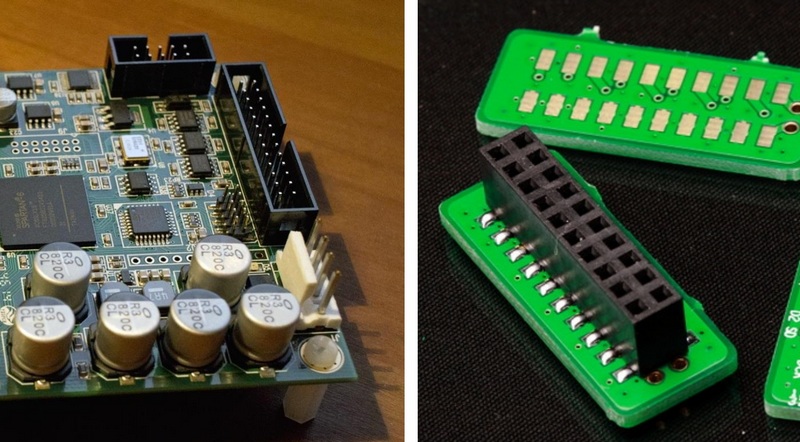

BTW, is your board equiped with a female connector so that it can be plugged into Soekris DAC's male input connector (see the pics below) ? May be 1 or 2 standoffs are needed at the Coax/Toslink connector side to provide stability. Thanks.
