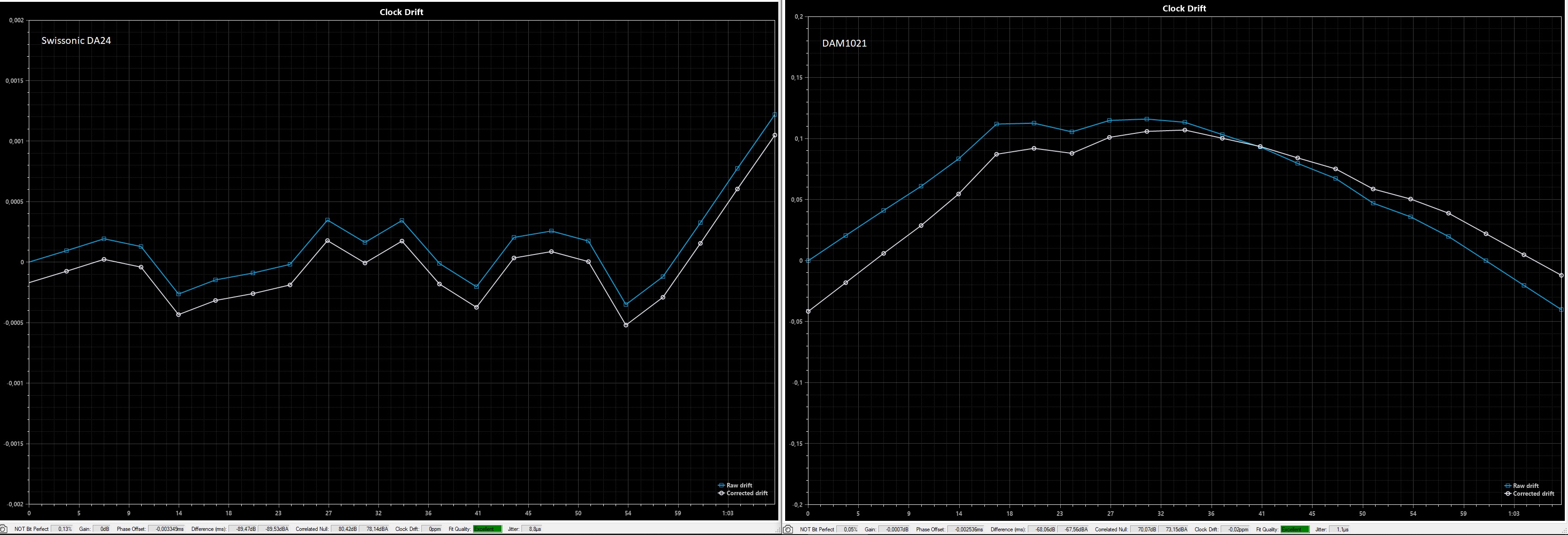

Here's a comparison of the clock drift of the DAM1021 vs. an old Swissonic DA24 converter via an DAAD roundtrip using a PCM4222EVM (AES/EBU output) as the AD converter and a couple of RME soundcards, both clocked via the PCM4222EVM's two AES/EBU outputs.

The DA24 loop has the theoretical disadvantage of using two different sound cards with their own receiver chips and reclocking contraptions.
Nevertheless, as can be seen in the image (comparison generated via the free DeltaWave software) the DA24 is two orders of magnitude (100 times) better in terms of following the incoming clock (y axis is deviation, x axis is time in seconds). The DA24 is also faster to readjust over time.
This is just one snapshot, but it is representative of what is going on from previous measurements in various scenarios I have made.

The slow PLL on the dam1021 is on purpose, the FIFO takes up any differences.... The audio clock is supposed to be constant, a fast PLL is a disadvantage which can add jitter, especially if you don't have a FIFO, like that old DA24 probably don't have.....
So I see no need to change it, or to add options to adjust it. What will happen in next firmware release is the the clock adjustments will be in smaller steps....

My suspicion, with a hint of proof available, is that the DAM digital PLL algorithm can not end up in a none adjusting state even if it was fed a 1 ppm oscillator. NB not talking jitter or phase noise but frequency stability. It seem to hunt and go around the center in a trial strategy... it seems like its Q > 0,5 i.e. its not critically dampened.
50 ppm for a 49 Mhz clock is approx 2500 Hz. This is about 2,5 Hz for actual pitch which at least I can detect. DAM buffer is said to be 44 samples i.e. 22 in any direction meaning 0,5 ms. 2250 Hz is 0,4 ms - so if the if the algorithm was adaptive it should be able to leave the Si be if the DAM was fed a 50 ppm clock.

The stability is usually not the cycle to cycle stability but over a certain period of time, e.g. per second, per day, per year, ...
For the SI514 the 50ppm is the "total stability" ... for 10 years??? ... not very clear in the specs.
Your 2.5 Hz is the total stability of the 48kHz sampling frequency.
However the 340Hz sine will also be "totally" stable with 50ppm = 0.017Hz.
And if thats the variation in 10 years, well 😉
"However the 340Hz sine will also be "totally" stable with 50ppm = 0.017Hz."
Yeees - but if someone pokes the osc a few times per second or every other second and change its frequency by several hundred Hz - what happens then to the "stability" of the clock? Oscillator still on 50ppm of course... that's the crystal I suppose.... ehh?
If I recall my measurements correctly the "poking" it is not a few 100HZ but a few Hz. The oscillation due adjustment had a amplitude of about 10Hz of a 49MHz clock. So 0.2ppm. And 0.2ppm of 340Hz are 68uHz - but no idea if that's audible.
