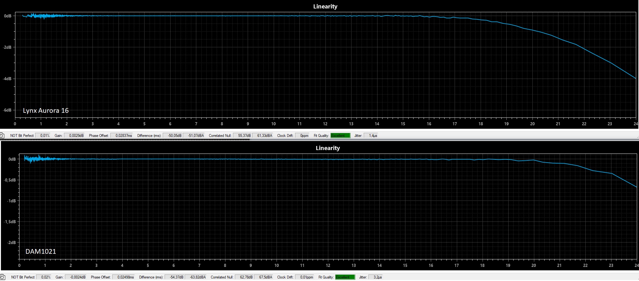

Here's a comparison of the linearity of the DAM1021 vs. the Lynx Aurora16 (studio multichannel converter utilizing the CS4398 DAC chip, until quite recently one of their flagship offerings and sporting 120dB SNR and -107 db THD+N).
I made these via DeltaWave, utilizing the one recording of the DAM I've got that was actually in sync, using a DCS 904 (discrete ring ADC, now sadly discontinued and beloved by the classical recording community in the 90s and 00s).
It clearly shows the superiority of the DAM1021 wrt linearity.

It's a linearity measurement, not frequency response (if that's what you think it is supposed to be).
And yes, it's not related to the latest discussion, but I thought it would be nice to show something positive. And it is with your filter. ;-)
Are you saying that the DAM is off by half a dB in level for a -24dB signal?
8-o
Guess you've never seen a linearity test before. Those are bits. So it's off by half a dB at -140dB
Well, the graph lacks guides ;-) and you wrote linearity without qualifying wich kind of linearity - I thought it was some funky x-axis frequency scale... no, this style I never saw before.

Mine is the best version availibile in a Rev5 board (dam1021-12, I think it's a mix of 0.01 and 0.02 resistors).
Signal goes from the DAM1021 single ended outputs into my own output amp/buffer/balancing stage and then back into the DCS904.
The sucessor to the Aurora, the Lynx Hilo measures better than the former has in my test, even though it uses the same converter chip:
Lynx Hilo DAC/ADC Review and Measurements (part 1: DAC) | Audio Science Review (ASR) Forum
But my DAM1021 measures far better in my test than any converter's measurements I have seen so far. Looks like it stays within 0.1 dB up to 21 bits (-124 dbB).
The DAM1021 is better at 24 bits than the Aurora16 at 20 bits and abberation at the highest levels is far lower (y-axis has 3 times the scale for the Aurora measurement). That's really something.
