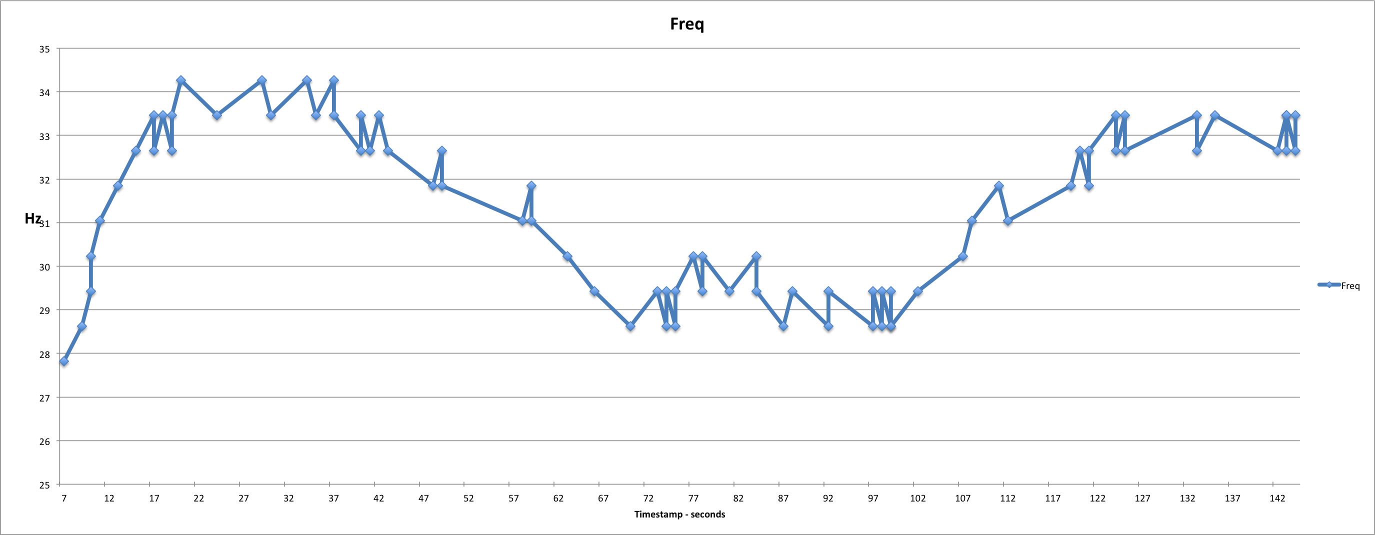

My explanation is that the DAM memorizes its last internal clock frequency (the 22.57..MHz + adjustment) for a given sample rate family (say 44.1kHz).
If the incoming frequency matches, by coincidence, the stored frequency the DAM clock will stay stable.
If the incoming frequency has some offset (but is stable) the DAM will adjust its own frequency in the attempt to match the incoming frequency. However there adjustment will result have some overshot ... it adjusts in the other direction and enters in an undamped oscillation of small amplitude.
I was able to reach a stable state by changing the sample rate forth and back when the oscillation was at its crossing point, so that the exact frequency of the incoming signal was "stored". This is of cause only a "solution" for experiments.

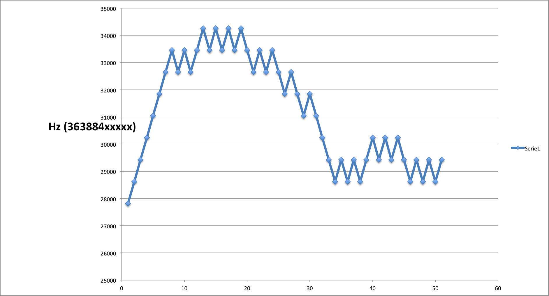

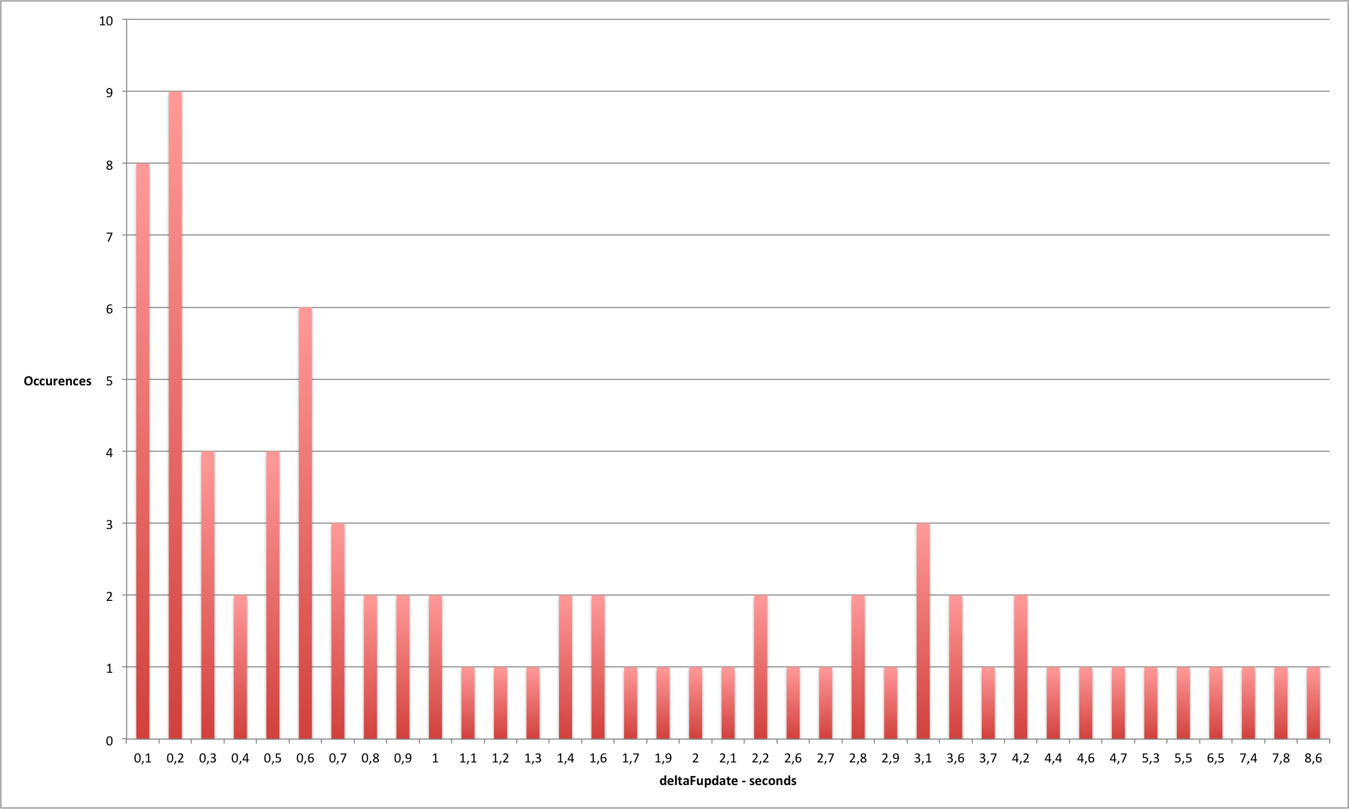

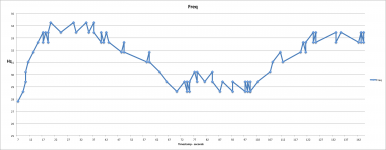

I'll repost my findings form a i2c trace I received form a fellow forum member...
The fastest update seem indeed to be 0,1 Hz as Sören stated. 400 Hz came from somewhere else...??
Have to admit that now when I'm looking at these I cant really say what the right-most one shows 🙂 ...
