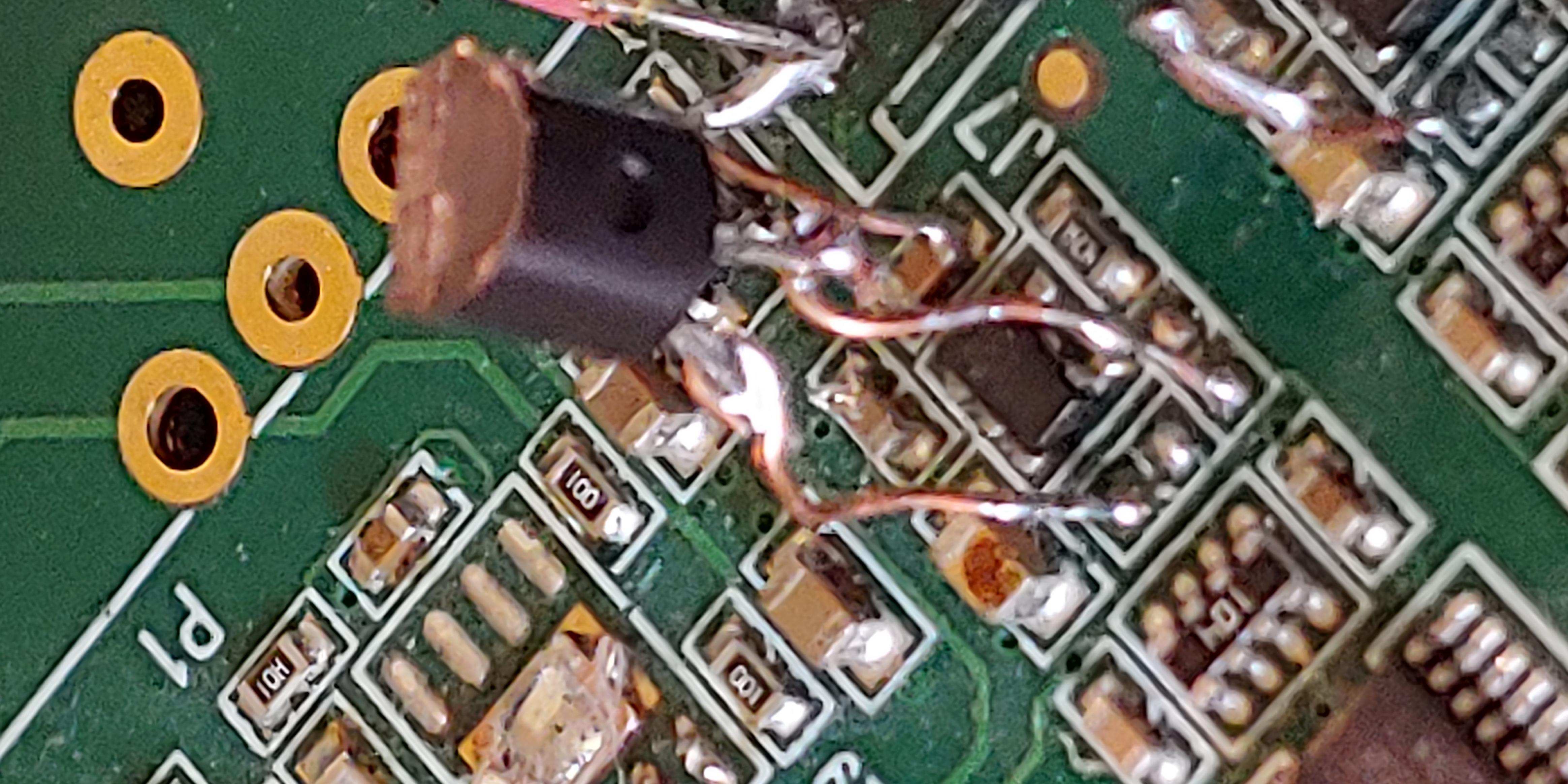

I think I've about hit my mod limits. Just finished the transistor mod, but too tired to tell if it was a major step up or not. The lower mids are fuller and music sounds almost a little slow, more natural but maybe too easygoing. Tomorrow I will do vref cap mod and then that will be it for the 1021.

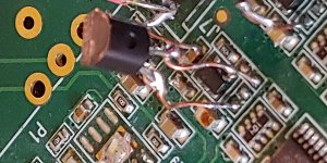

Tips for anyone doing the transistor bc550/bc560 mod:
1. It's actually one of the easier mods to do because the parts being removed come off easily with heat from the soldering iron and from there you are just adding to the board not taking away.
2. I trimmed the transistor leads and soldered more flexible thin wire leads on the legs. This way I didn't have to worry as much about bending the legs in just the right way or breaking off pads since they are so stiff.

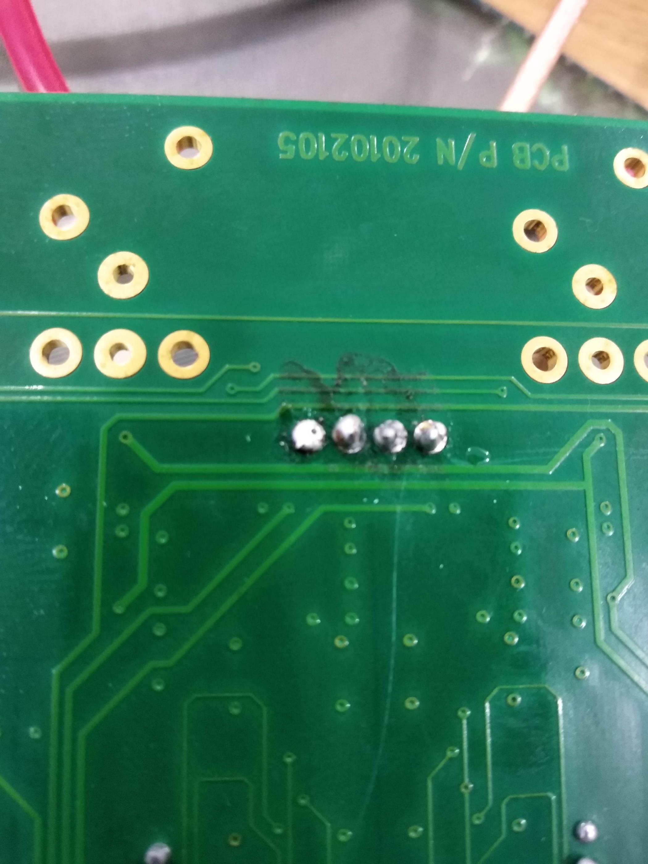

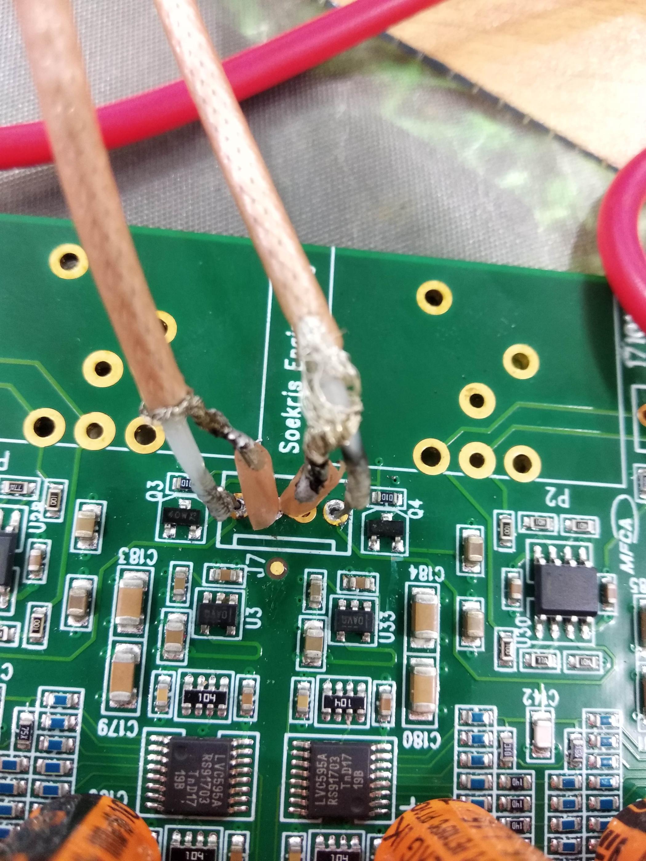

I have got my DAM 1021 board and started assembling. One doubt / problem I find, that is when I measure J7 output after soldering, I get shorted alert with meter. I desoldered and checked by meter without any cable soldered , it is again signaling a short in all 4 connections. Is it a problem or it is ok. I have not connected with the power. I have thoroughly checked, no soldering is creating the short. Badly need your help, regards
Muting jfets to gnd. jfets are normally on, so about 30 ohms shorting....

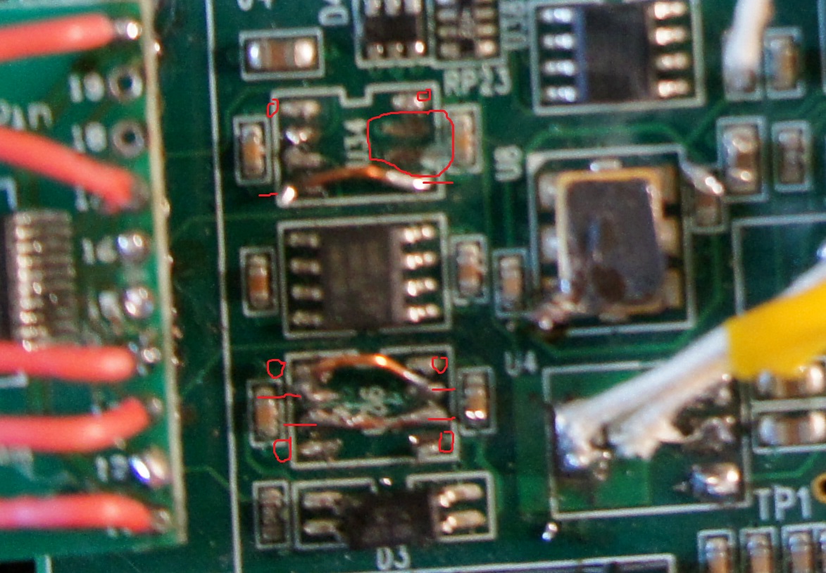

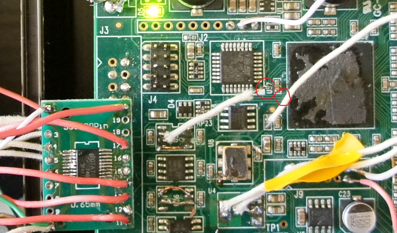

Hm, got an SOS here. I was in the process of removing the isolators when I accidentally pulled up two of the pads. Anyone know where I else I connect the BCLK out? Guessing the STM32 but not sure which pin...
Never, mind found a way to connect by poking the vias by the Xilinx with a needle. If what I hear so far holds up then doing a flip flop followed bypassing/removing the isolators is the best mod I've done.

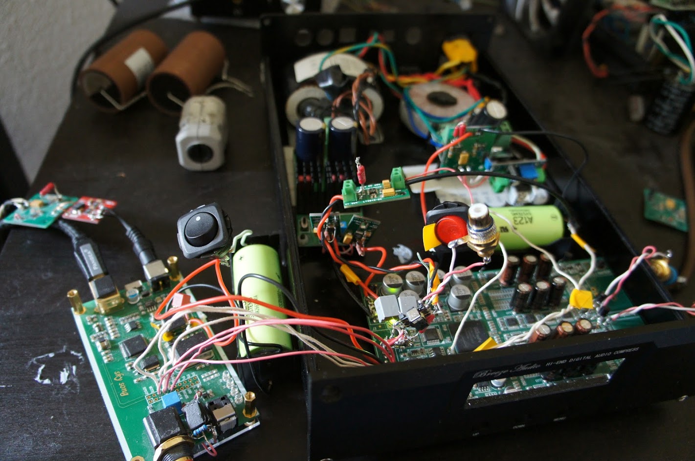

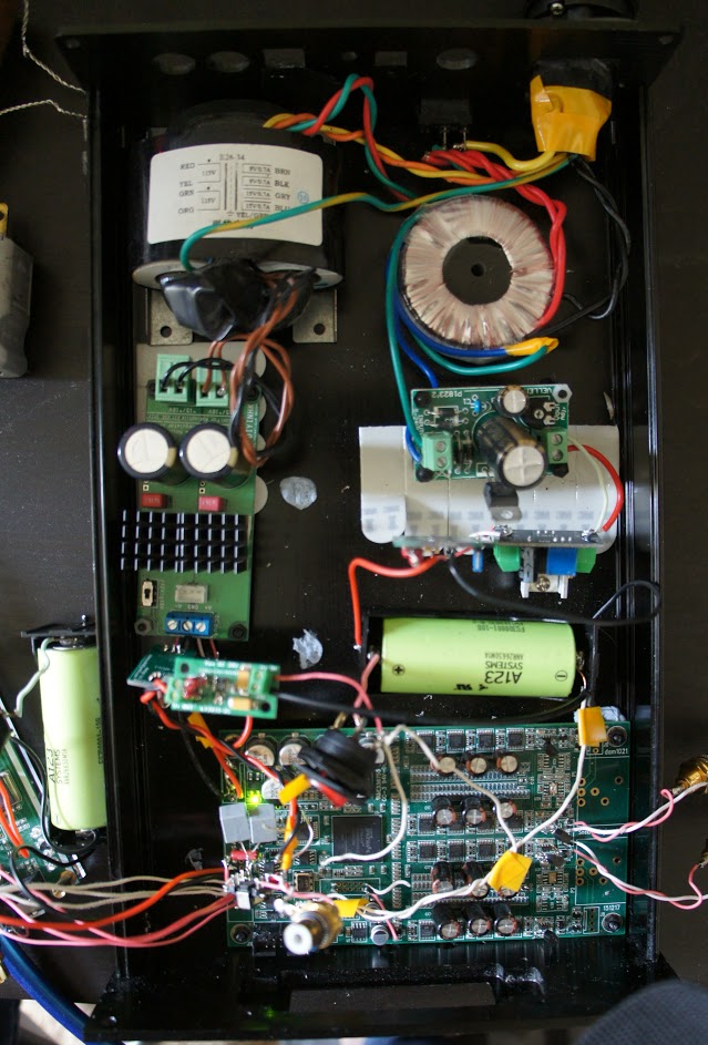

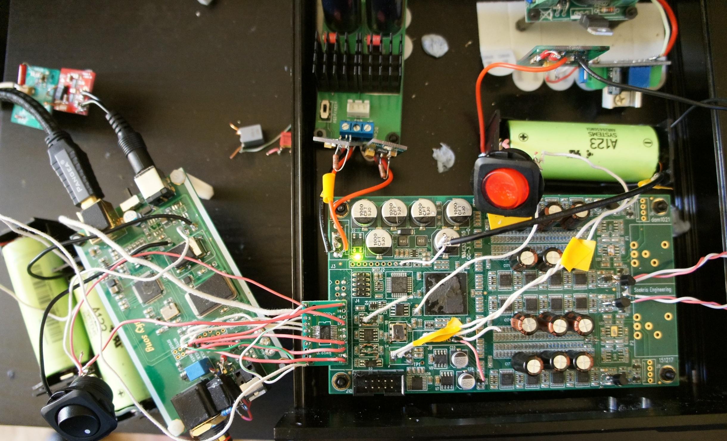

To recap all my Rev3 mods (Pic below):
Removed buffer, output caps, added Paul's filters (2016)
Added 12,000uf Nichicon HE to Vref (hopefully not too low ESR)
BC550/60 Superreg Mod
Lifepo4 3.3v/1.2v in place of Regulators
Lifepo4 3.3v to clock
Removed Isolators
