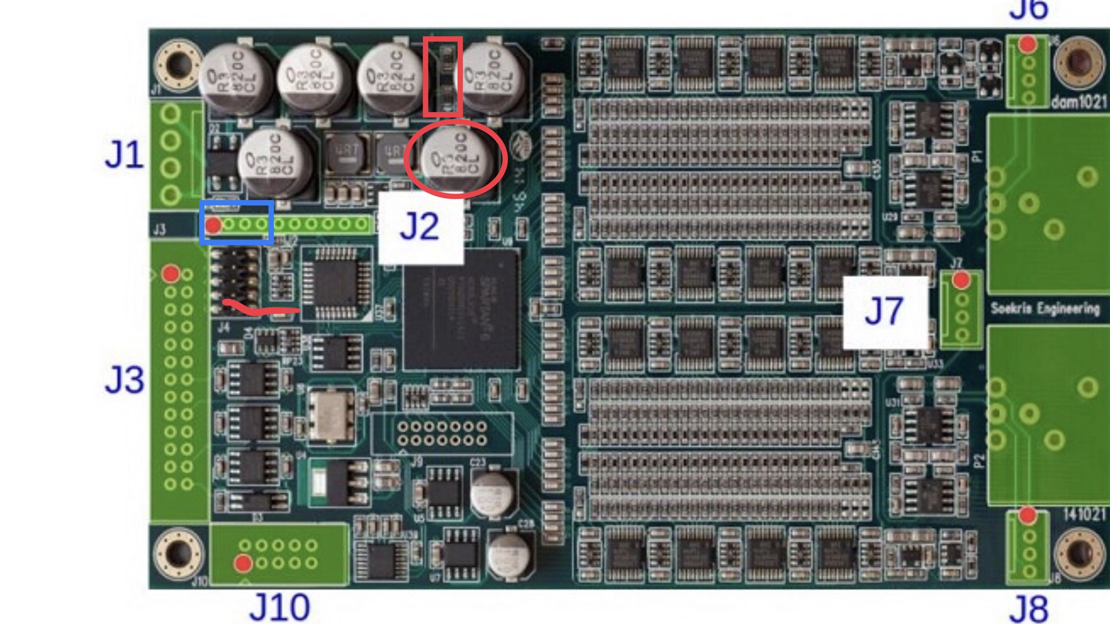

Hi Soren,
Those capacitors I mentioned are marked as in the picture below.
I am feeding the DAM by +-9.88VDC and PWR- at J2 is -9.54V.
Suddenly today when I turn on DAC to measure voltage again, voltage at center pin of Q3,Q4 is +-9V, and I got normal output level again.
Not sure this issue comes again, in the worst case, can I remove Q3,Q4 to get normal sound?
Thank you.
Hi I had same issue few weeks back. It turned one bad resistor on negative rail before second 1000uf cap, it was no power on it. It was no power betwen ground and negative poer pins on J2 marked blue in the pic. Bad esistor location in front of last 1000uf cap marked square red.
