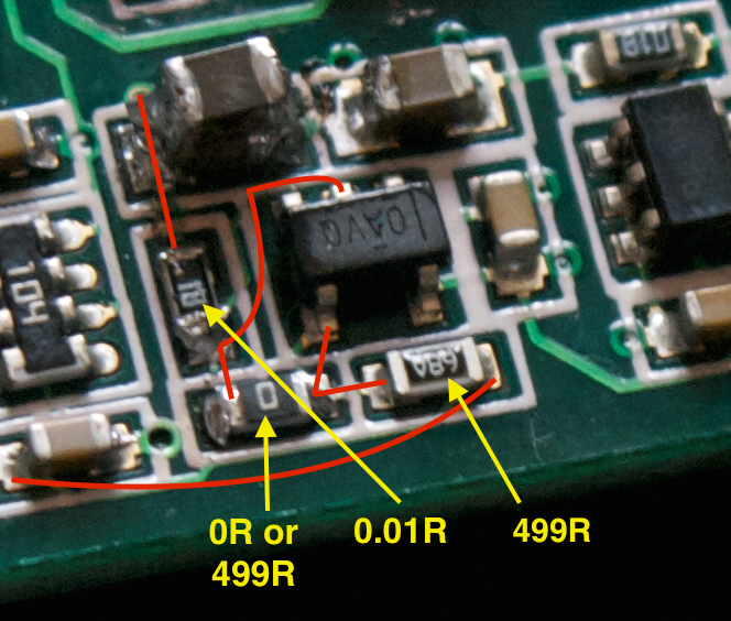

You did in that way?...so 499R-499R-0.01R or 499R-0R-0.01R....That people knows what is important mod that you talk about.

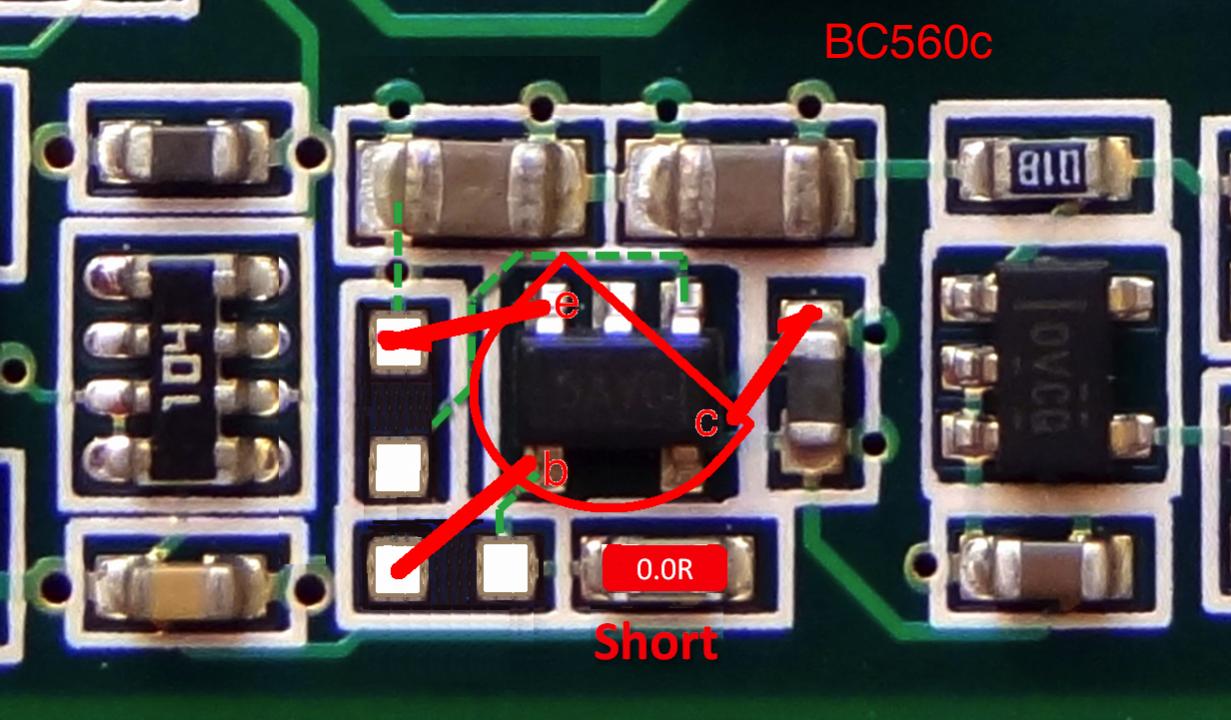

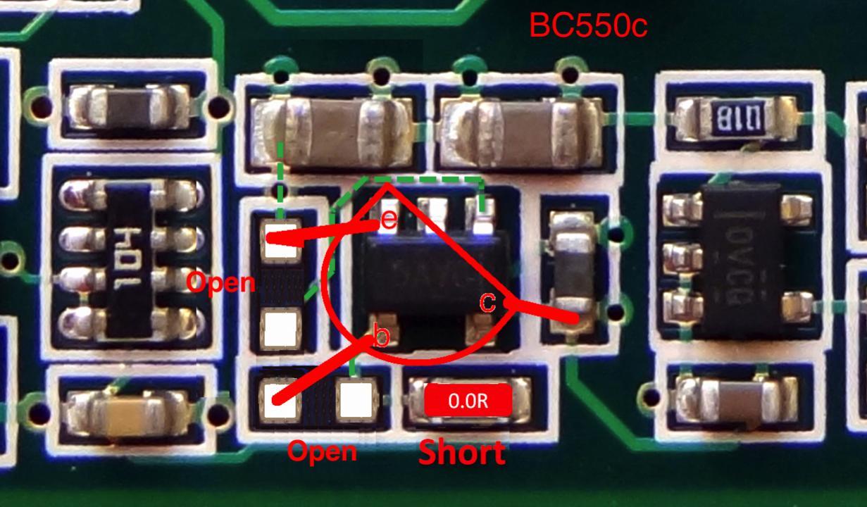

And can anybody make sound result (diffeerence) vs BCxxx -Transistor VREF modification?
Well the guy who invented the 0.01R mod said don't do it. So, don't do it.
Soren said he tested the transistor mod and didn't like the fact that it needs extra current to stay low impedance. But let me know if there's great ABX results from it...

499-499-0,01R mod or 499R-0R-0,01R mod?

I think the low-res mod is defined as using 0.01R for the series resistor. 499R and 0R are two variations. I think rev2+ have 499R.
