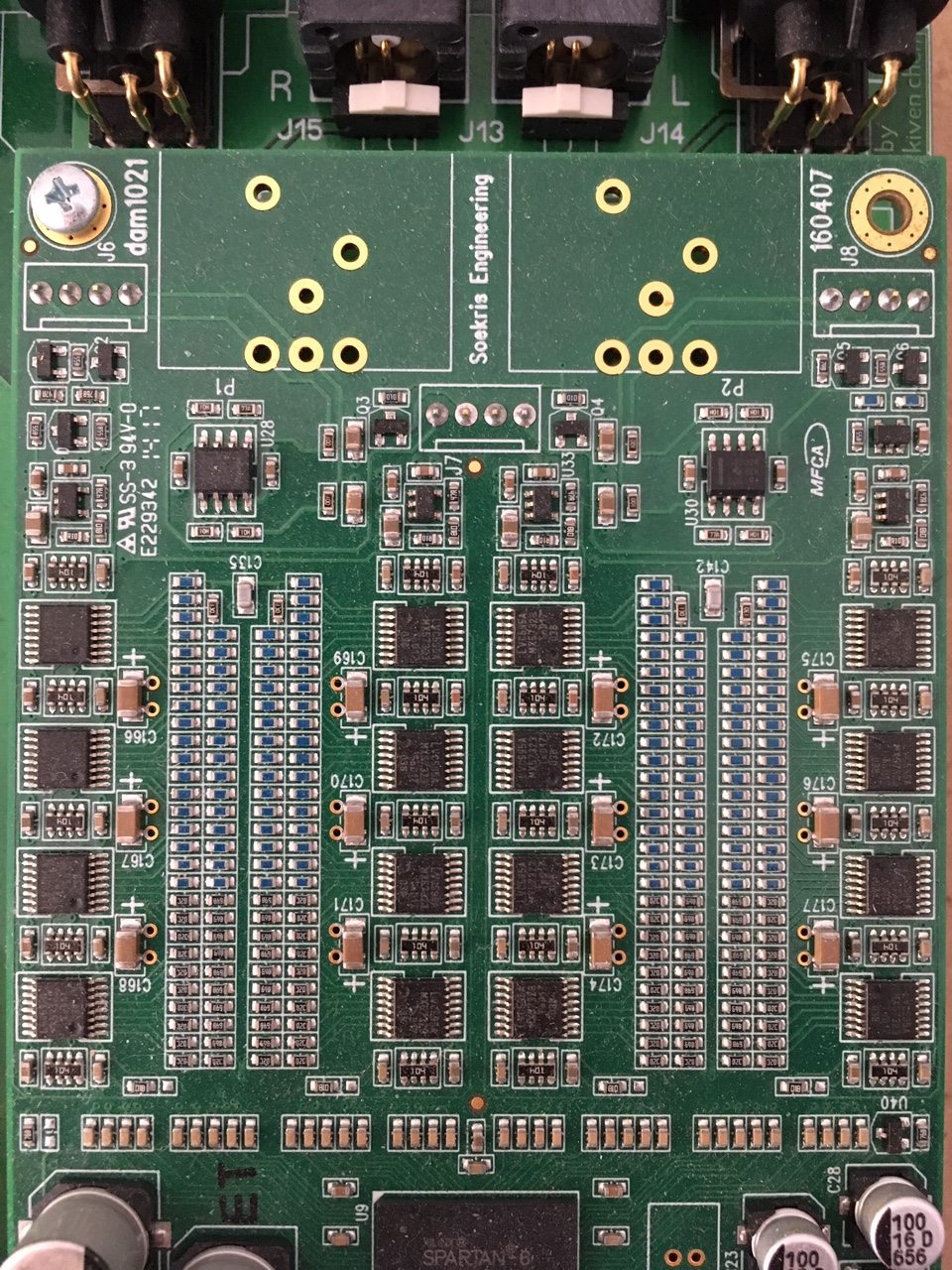

That's Dimdim's mod for earlier revs. If you have rev.3+ there should be vias in the middle of the board which would make things easier. If you haven't made the purchase, consider dam1121 1921/1941 😉
How do you do the caps mod for the 1121? I don't see any vias on that board...

Ask TNT or Jogi... I think you might just have to parallel it on the ceramics. My honest opinion is that before I did the vref mod, the bass sounded very thin compared to my (!) laptop output. It was punchy, but something was wrong. Now it's all proper. Of course the dam1021 is more real sounding and detailed in the bass, still punchy with the 1.19 linear filter - which was what I had before the vref mod too.
I would also consider the vref caps as part of Soren's design, though he would obviously deny that. 1941 has 800uF+1000uF per rail at least. 1541 has 1000uF. Note that this "technical reason", which is totally valid by the way (check the measurements posted earlier or on hifidruino), will skew your perception before and after the vref mod since you can't do ABX. I don't think my strong recommendations above need to be qualified, however. This is advice from my failed experience playing with the filters. Anyways, something interesting to think about and keep in mind 🙂

Once i get to work on one of these i plan to remove all ceramics, replace them with ecpu and probably leave a couple of empty pads for adding electrolytics.
I don't believe that is technically sound (intended!!) These are for HF decoupling - your replacement will not do that job on those frequencies. Don't forget to do before and after measurements - also on the outputs!
