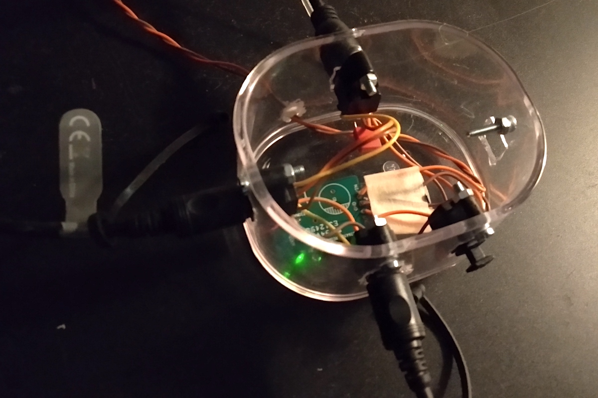

I play 192/24 with 5m cable with the above receivers.
Built a 1-> 3 (4) duplicator to use with my toslink-in mono blocks + Hypex DLCP.
Pure passive/optical splitters (1->2) could not do 5m - only 1 meter.
