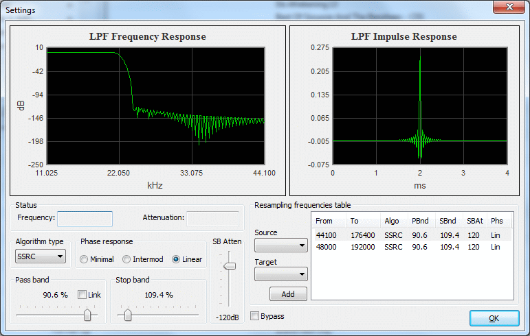

TNT, I went back to partypak0.99 eqv5 again. It seems to have brought back the clarity but retained the naturalness and definitely improvements in bass from the caps mod. The change can perhaps be regarded as drastic. I would encourage anyone to try both and see the difference. I was running 1.19firmware 1.20FPGA.

Upgrade to 1.19 fw again. Sound wasn't distorted and too soft like 1.20 FPGA. What I can say is that compared to EQHQv5 apo the new 4k linear has noticeably more bass and is perhaps softer in the treble. No idea if that's good or bad.
Baffling that I didn't notice the soft sound with 1.20 FPGA before the caps mod - I listened to it for quite a while. Regardless, the vref caps still added to the bass significantly, and most likely dynamics too. With Paul's filter, bass is neither boomy nor loose. The 4k linear is fine too. I don't know which is supposed to be better, but I'm happy with Paul's filter that is known to be technically superior with 2k taps constraint. The sound could perhaps be characterized as harsh, but I'm not audiophile enough to be able to tell if it's something that can be fixed without coloration. Maybe a 4k filter implemented with the same principles as EQHQv5 would make it smoother. What a nice personal project it could be to an electrical engineer with interests in signal processing, or a hobbyist with time to spare 🙂
