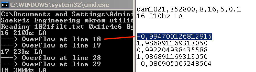

feede: Is the sign wrong on a1 and a2 meaning I should change a + to - and vice versa, using the XL spredsheet?
E.g:
a1 1,898995137972150
a2 -0,899845447460763
a1 -1,898995137972150
a2 0,899845447460763
I just double checked this. I currently use the same sign of coefficients in the filter text files as in the left side of the excel sheet. But when I apply the coefficients in my (custom made) PC software, the sign is changed (as in column AA of the excel sheet).

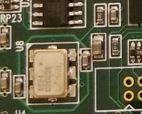

So, here is the question: why not give the clock a separate regulator? The 3.3v gets shared between the clock and the micro and all that separates them is a flimsy RC filter. The 1R resistor makes the separation very easy. Of course i tried it and the change was substantial but not entirely an improvement, perhaps due to the regulator i had at hand.

Interesting assessment. I'm VERY interested to learn more about doing a separate clock regulator... funny noone found that before.
As you can see in the pix in this post:
Soekris' DAC implementations
... I can't easily see the clock / regulator area due to the regulator mounted directly over it. Can you share a picture of that area with the resistor marked? That way I can get a couple additional regs on the way and prepare to do that mod once they arrive.

What i called a "superreg" mod is known in this thread as the BC transistors mod. It involves the addition of a pass transistor controlled by the opamp output and provides a lower and more uniform with frequency output impedance from the regulators. Sorry, don't have a link to the specific posts but it should be easy enough to find.
To power up the clock from its own regulator you have to remove the 1R resistor seen in the pic. The bottom pad of this resistor is directly connected to the PS pin of the clock and this is where an independent regulator can be connected. I got the raw dc and ground connection from the pads of the onboard 3.3v regulator which continues to power up the microcontroller. Waiting for an LT3042 to arrive for this particular spot.
