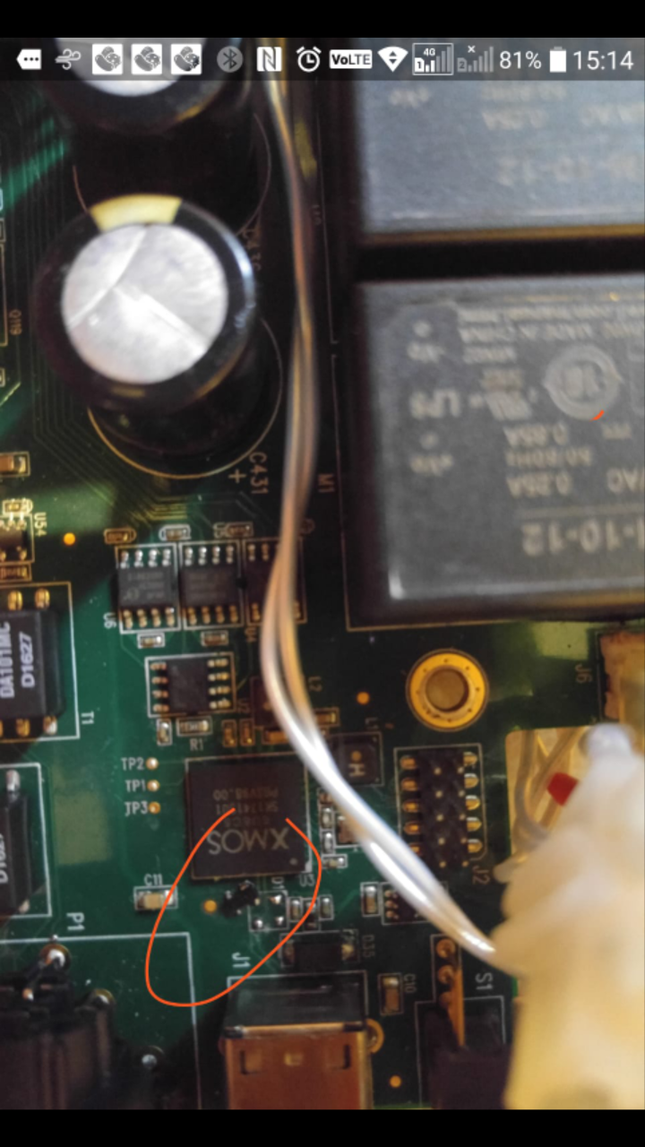

Help my dac 1541
What is the specific item at D1? Thank you
