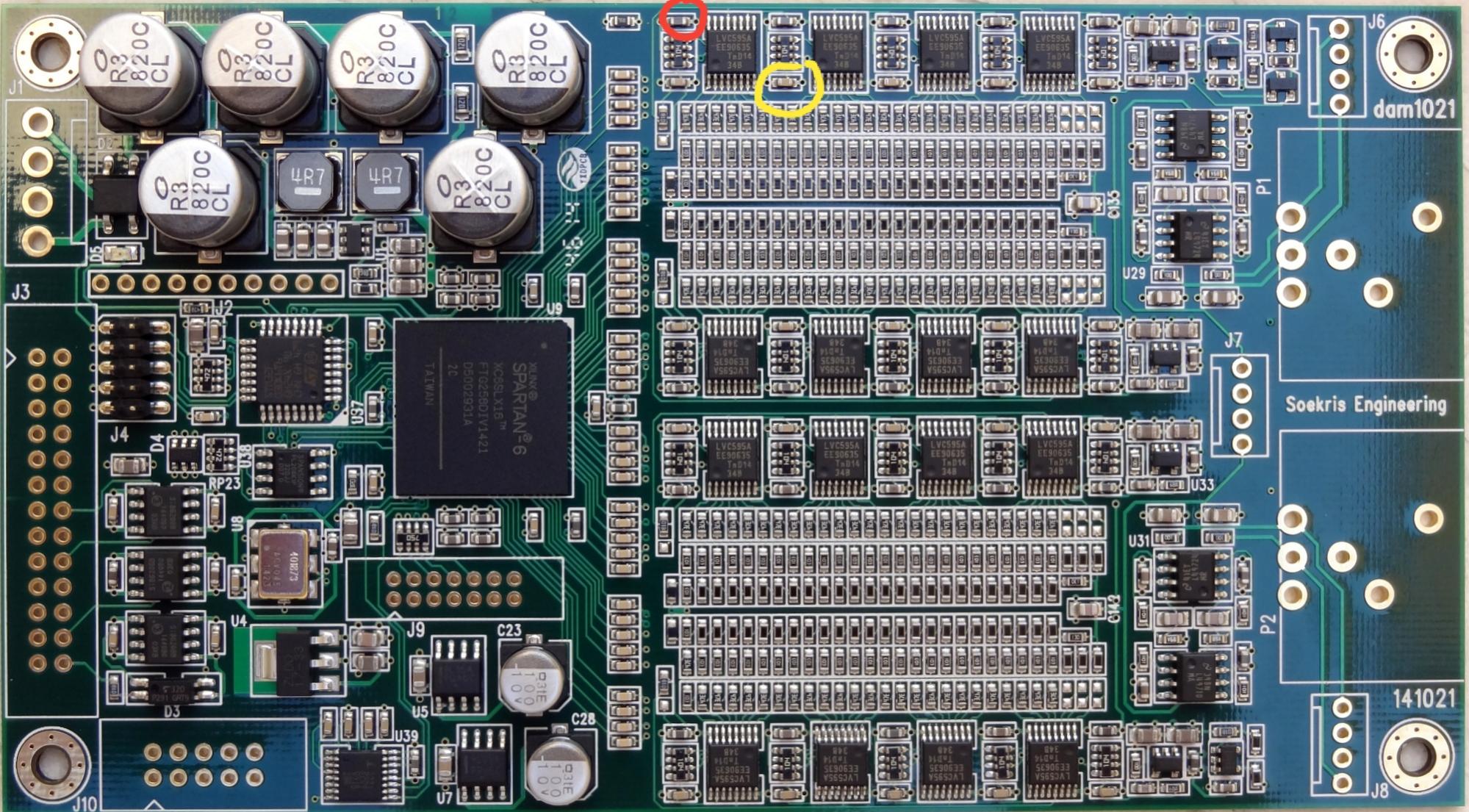

I'm sorry, but you severely degrade the dac1541 by:
Replace switchers with other switchers probably feed from a switcher ?
Bypass the ultra low impedance and ultra low noise discrete regulators, instead the output amplifiers are connected directly to the switchers ?
Add high impedance (relative) capacitors to low impedance discrete regulators ? Directly to the transistor collectors, which might affect stability ?
Disconnect chassis from ground ? Ok, it's probably connected at the bottom of the PCB.... But why then the plastic screws ?
Add extra high impedance (relative) capacitors to the low impedance vref buffer ? Ok, at least that don't hurt....
Remove the output mosfet relays, instead getting clicks and thumps ?

I do believe the dac1541 is a good product, and what degrades the whole design was the choice of installing the onboard switchers with 200mV ripple and noise (max)!
I honestly believe if the board would perform way better with LDO Voltage Regulator such as Tps7a47 series which I am about to start the DIY process.
Besides, just being curious, would you be kind enough to provide more details on the dac1541 board such as those junctions and the case openings size and locations? Thanks!

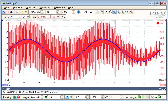

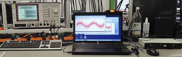

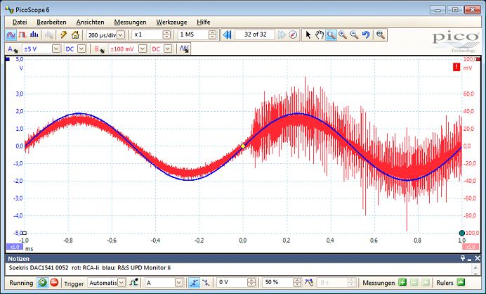

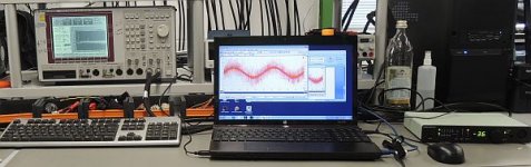

There is one issue that might need more attention: there is quite a lot of noise at the RCA output.
attachment.php
attachment.php
red: PicoScope reading from DAC1541 RCA out left
blue: PicoScope reading from R&S UPD monitor of input from DAC1541 XLR out left
note: noise amplitude changes from time to time
attachment.php
Had the impression to have a fault in my measurement...
May be, JJansen has addressed this (and possibily other stuff).

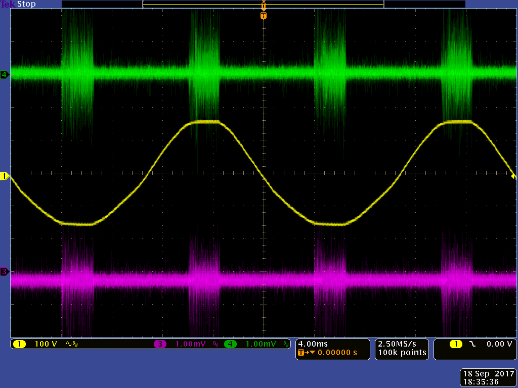

Here is what I get on the dac1541 RCA line outs with my Tek scope, input active with nothing playing. The level changes with what 230V outlet I'm using, the level goes up when output is set to "headphones", in that case the line outs are disconnected from the output amplifier and instead connected to gnd with 1K5 resistors.
Note that the scope is set for 1mV/div, the repeat rate is 100 Hz. I believe it's in the air or ground and is what you can expect with switchers around on a cluttered desk, note how ungly the power input is, I'm located at the end of a small road....
There is absolute nothing to hear in my speakers when volume on the stereo amplifier is turned all the way up.
Yellow is power input, Pink is right output, Green is left output,
