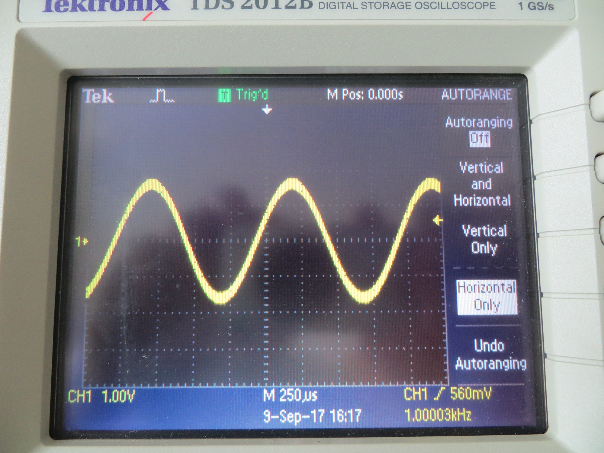

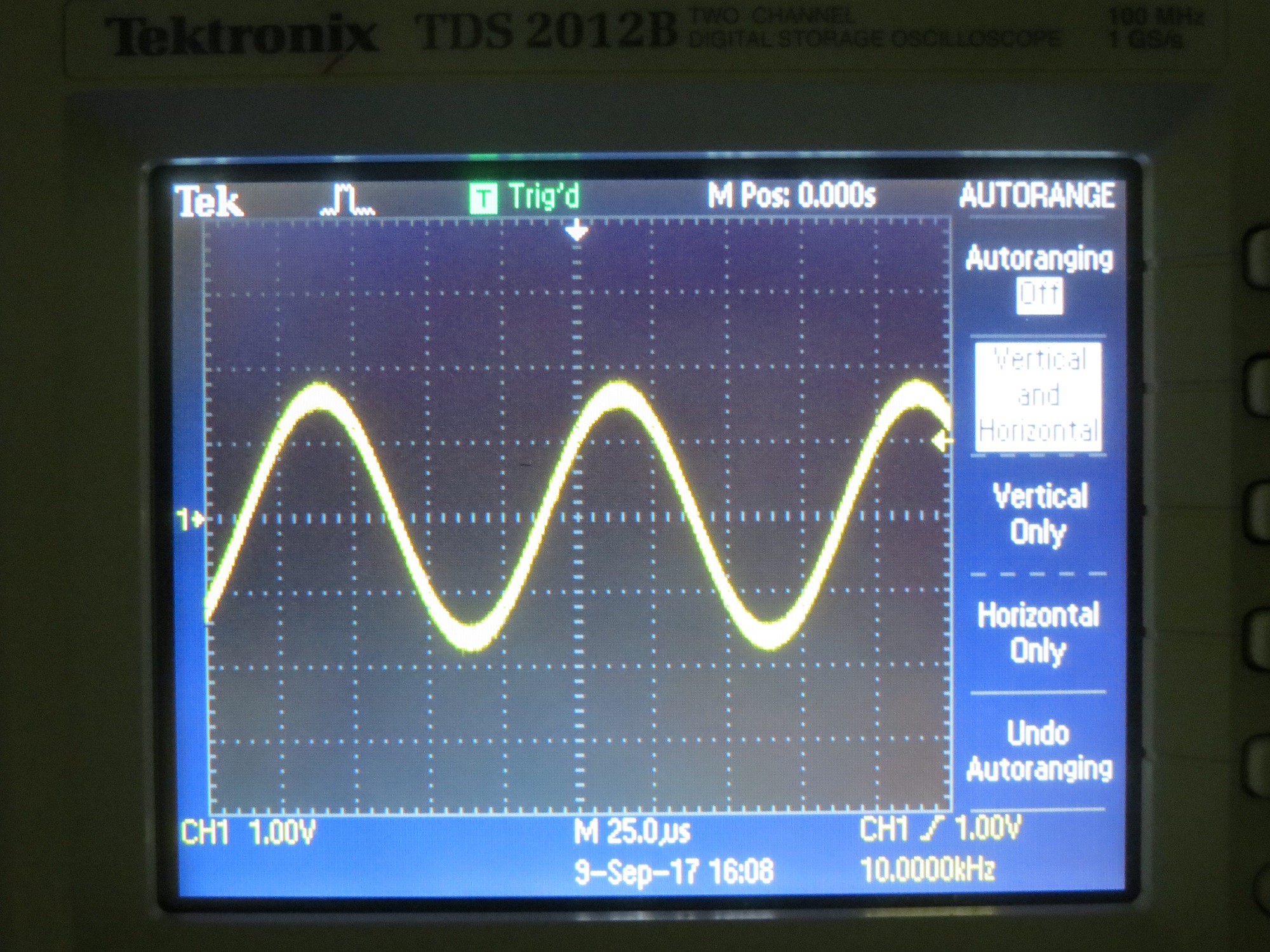

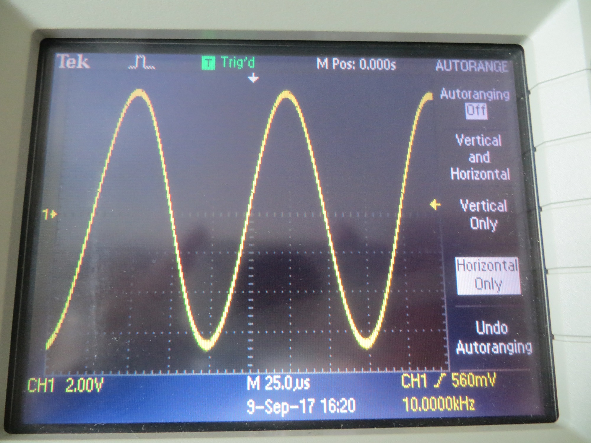

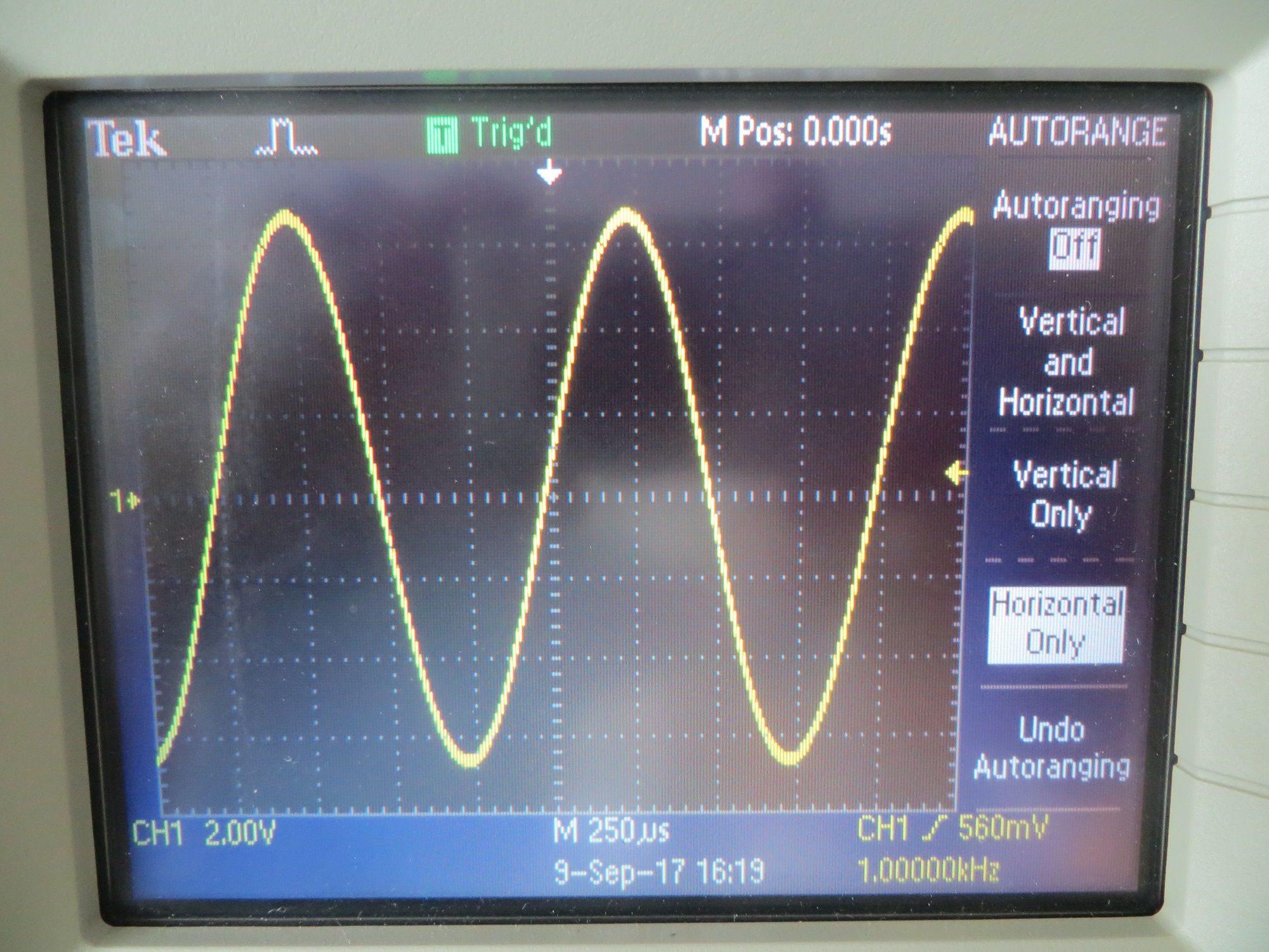

While modding my DAC I did some scope checking using both the RAW output and the output after the 2A3 triode output stage.
The followings are some sine wave outputs (1V scale is RAW and 2V scale is tube output):
Note that the waveform after the tube output stage is 'thinner', suggesting some HF noises have been filtered out.

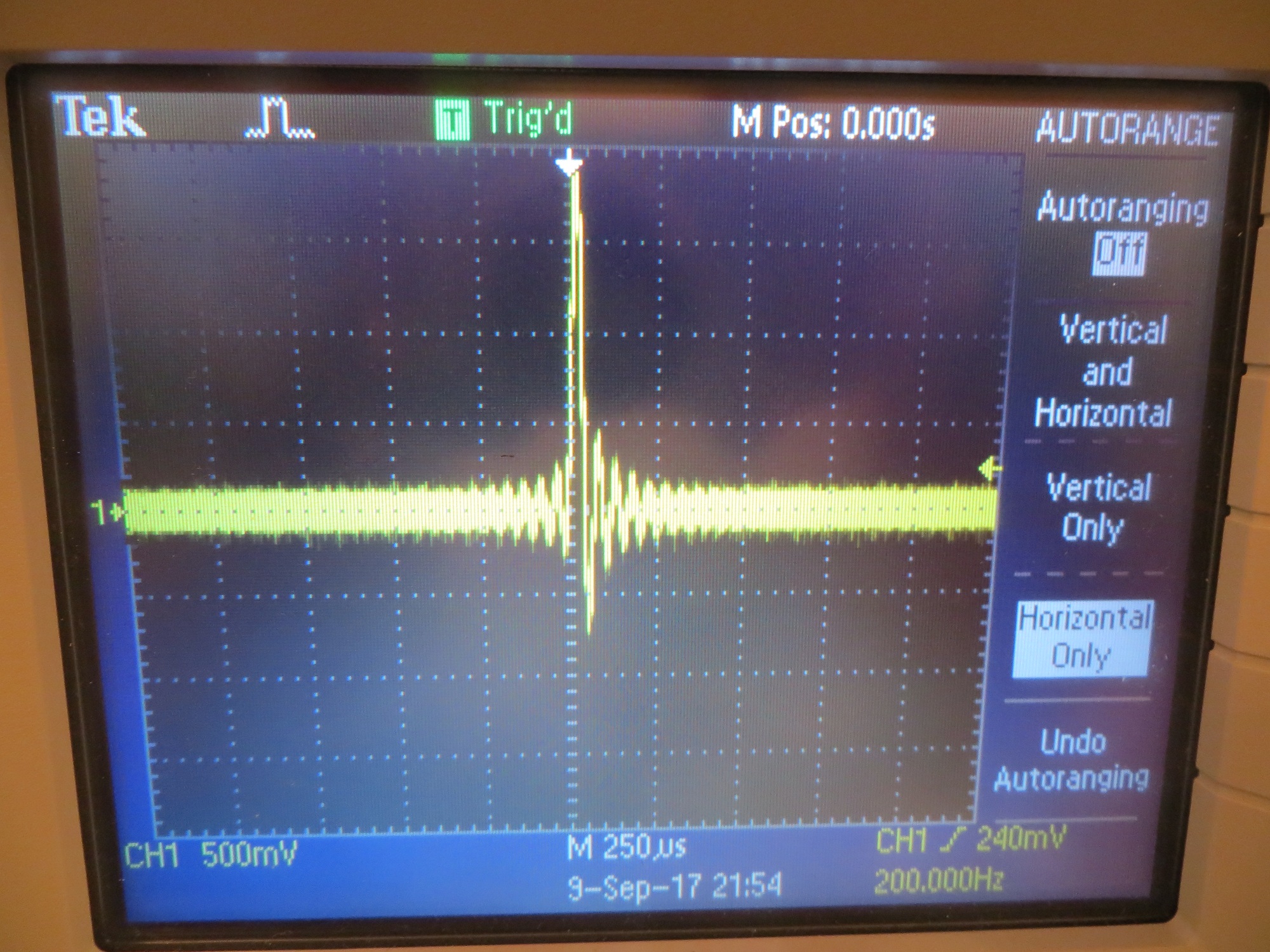

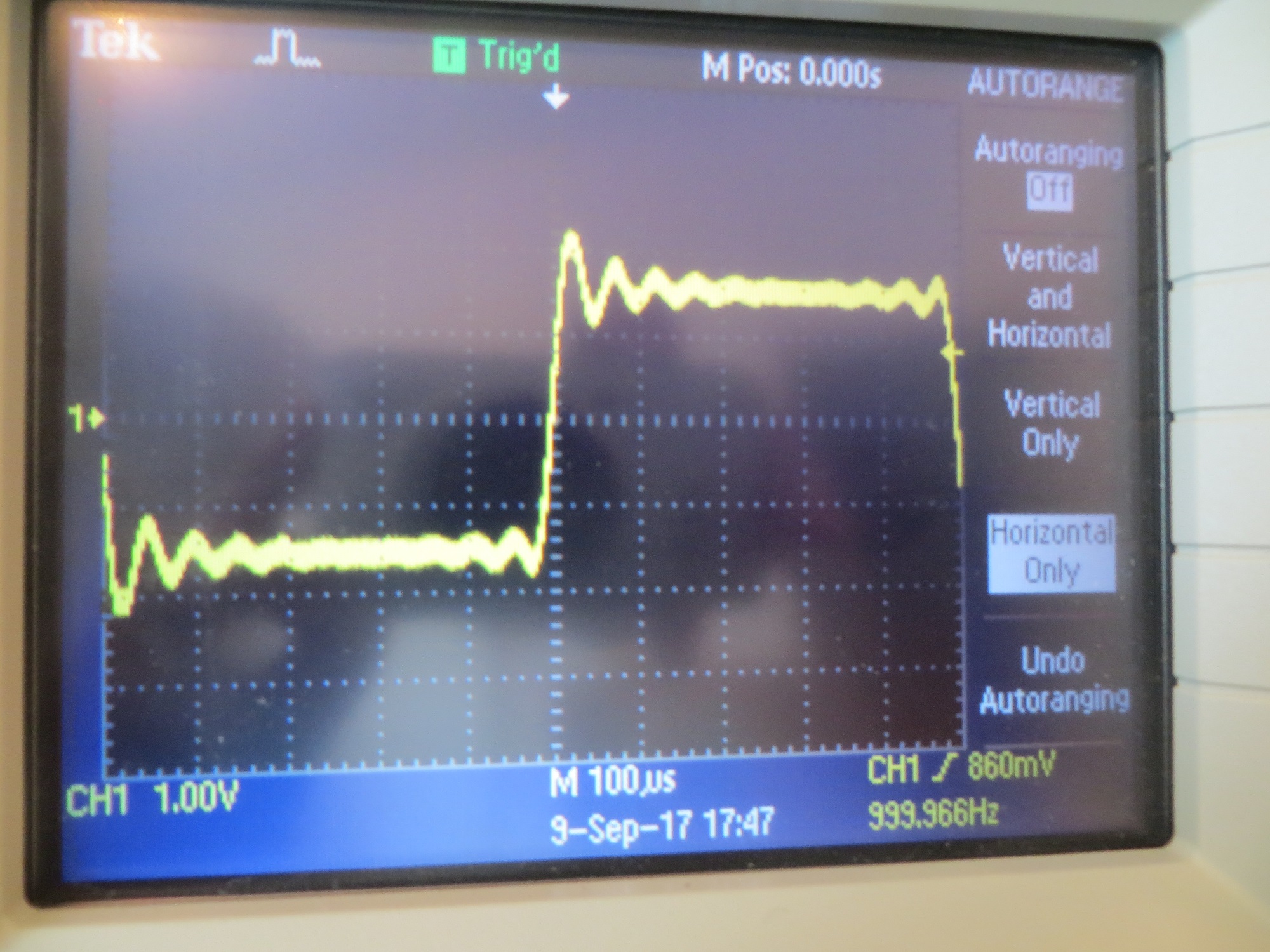

Next ones are square waves and pulse: (RAW follow by tube output)
Note the tube output stage is inverting.
