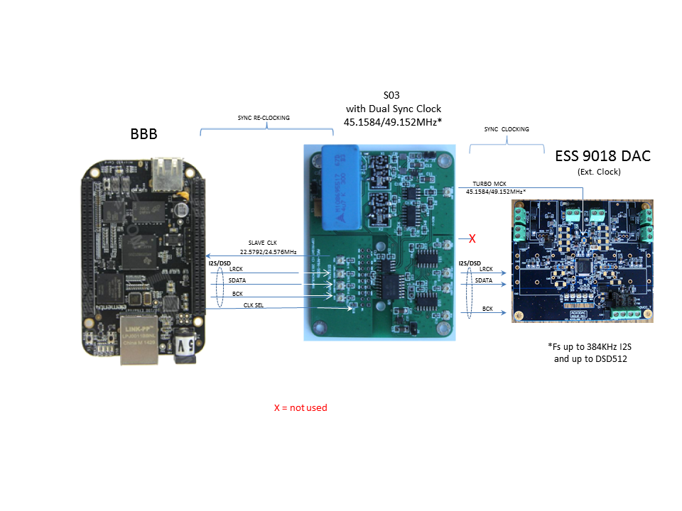

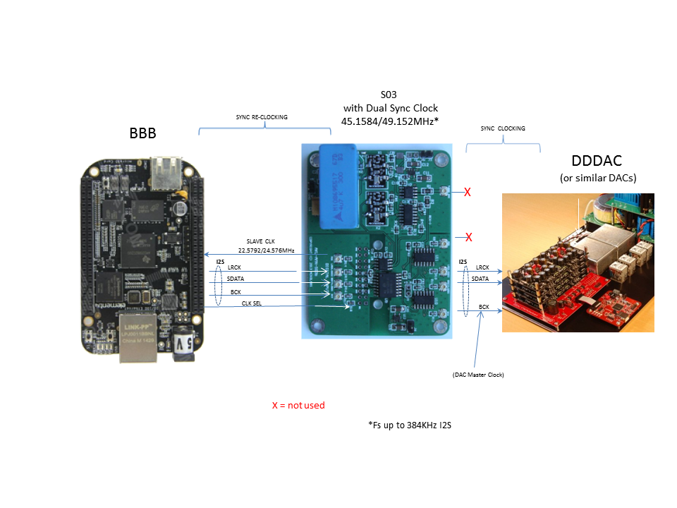

Firstly, I would consider using a Beaglebone Black (BBB) with the TPA Botic driver software instead of the RPi. The RPi is more compromised than the BBB, especially with respect to clocking of the audio data and the BBB ought to deliver better results.
Acko's SO3 in combination with the Botic driver software allows the high quality clock crystals on the SO3 to clock the audio data on the BBB and includes a function to switch crystals so that 44.1KHz data isn't resampled to 48KHz. Acko explains it here;

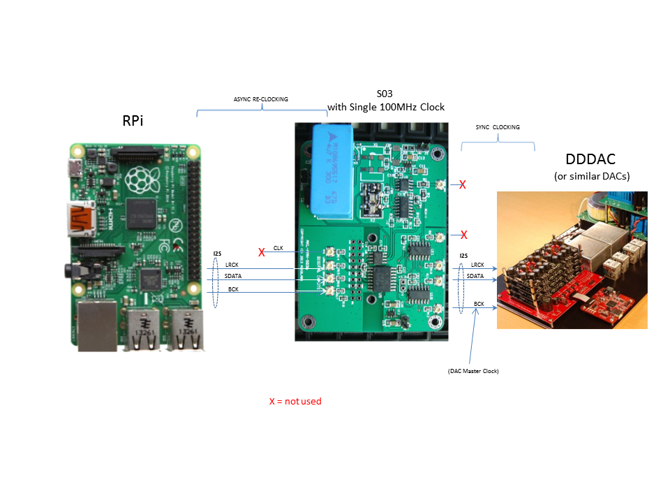

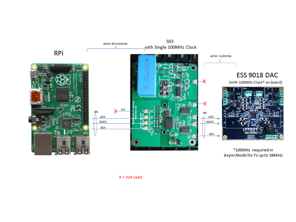

I didnt know that i choose RPi over BBB because of 3 reason;
1) here http://bbb.ieero.com/ says that;
"By default the file is resampled if 44k1Hz frequency or multiples is being played. This might/will introduce hearable artifacts."
2) As fas as i know we can't use volumino if we use Miero linux image.
How you planing to play files? I can use BBB as you will do.
3) I read one of Sonren post the R-2R DAC use Asynchronous instead of synchronous and when i look at the attached pictures prepared by acko for BBB the connection is synchronous;

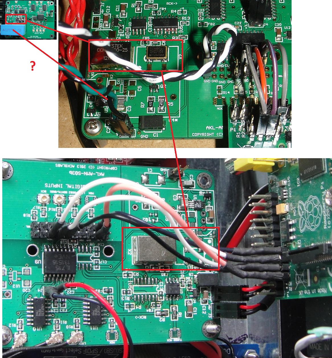

I do not go for fully assembled version because i am not sure that which version i need at the moment. Let me explain;
X1 and X2 slots can be filled depends on application, the standart build on Acko web page use big blue component 🙂 but in application pictured sent by users do not include it. And components location could change. Please see attached 1.jpg picture.
Also in cutom builds some user use CCHD-950 and said that it is better. i have not enough experience to comment 🙂
That's right, 'out of the box' the Beaglebone has only a single onboard clock that will result in resampling of 44.1KHz family sampling rates. The SO3 essentially replaces the single onboard clock with the two higher quality clocks with automatic switching to the correct clock to avoid the resampling. One of the key benefits of miero's software, available on that link, is the clock switching. You can't do that with an RPi as far as I know.
No Volumio is a separate distribution to miero's. I will control what I play via a UPnP control point on my smartphone or tablet (BubbleUPnP). I've installed upmpdcli on top of miero's distribution so that it is visible as a upnp renderer. Chanh has also done this and is using it successfully with very good results.
http://www.diyaudio.com/forums/twisted-pear/258254-support-botic-linux-driver-22.html#post4115829
RuneAudio, which is similar to Volumio, are promising to include miero's software in their next BBB release.
The SO3 clocks need to control the BBB but the use of the the same clocks with the dac in full synchronous mode is optional. You wouldn't connect the SO3 clocks to Soren's DAC.

I definatelly can't do that but there are so many electronic repair shops avaliable one of them could soldering components for me.

Søren, in the context of Potstip's posts, I agree that the SO3 isolator/reclocker is superfluous with the input isolation and reclocking on your DAC board, but, it does have a use in providing external clocking to the Beaglebone so that there is no resampling of incoming data that its single onboard clock would otherwise dictate. With the RPi you're stuck with the resampling anyway.
Now, if the beaglebone could send its clock select flag to your dac and your dac could then switch to the correct clock rate for the data sampling rate and send a suitable clock signal back to the beaglebone.....
