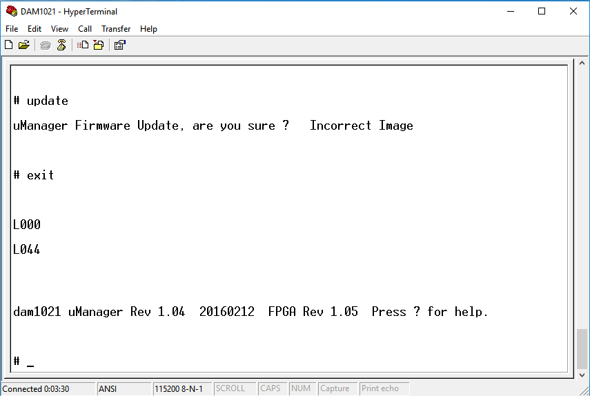

Also, is the attached normal? Downloaded 1.05 full with no issues. Typed update and got the 'Incorrect image' you see in the attached. I then exited, powered down and, on powering back up got the '1.04 uManager and 1.05 FPGA'.

Try "update" again, if still not working, try downloading and "update" again.
Both uManager and FPGA should be vers 1.05.

Sorted. It appears the issue was me having the 'Send line Ends with line feeds' and 'Append line feeds to incoming line ends' boxes checked in ASCII Setup (which I had set for another application) in HyperTerm.
As soon as I unchecked those boxes it updated as usual. One more for the knowledge base.
