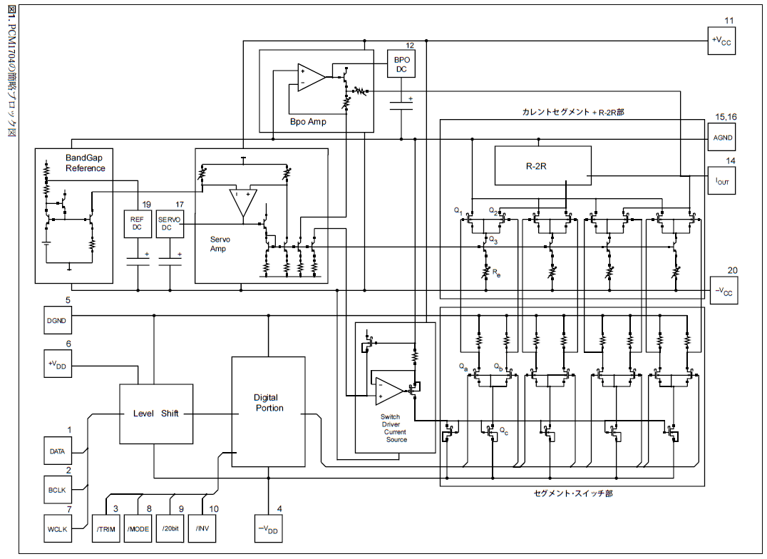

Andrea,
Reading the datasheet seems that BB implements the 2nd option "The two DACs share a common reference, and a common R-2R ladder ...".
In the PCM1704 they used 2 voltage rails, positive and negative, but one reference only with a servo to ensure the voltage tracking, and a single ladder network. So I presume they switch the R2R ladder between positive and negative depending on the sign bit.
No, BB's sign magnitude DACs have one refference and two ladders,in fact,two segmented 23bit (in 1704) DACs(consists of current sources and a ladder) plus one extra LSB.
BB's ladder runs in current mode ,so two ladders output can be easily combined (done in the IC).
Technics had sold CD players having sign magnitude with two PCM56P.
It needed to adjust the gains of upper and lower half.

Actually, looking at the diagram in the datasheet there are 2 DACs (I know it's a current output DAC).
But in the paragraph "Theory of operation - Sign-Magnitude Architecture" at page no. 6 they say " The two DACs share a common reference,and a common R-2R ladder....", so I presumed a single ladder network, that seems in contrast against the diagram.

To me it looks like the 1704 has one R-2R ladder shared between the two DAC sections, that's what the datasheet says, don't know exactly how, even this BB drawing I found is not that clear....
My datasheet does not show this detailed diagram, where did you find it?
Anyway the diagram you posted confirm the explanation in the "Sign-Magnitude Architecture" paragraph.
Did you understand how they switch the ladder from +Vcc and -Vcc?

I found like pcm1704 drawing on the net, don't remember where....
But as I said, it's not clear to me how it actually work, could be some offset current involved.

There is no such description on japanese datasheets of pcm63,1702,1704 or ANJ1082,ANJ1092! I did not know that.
Thanks Andrea, Søren.
So... I think each nodes of R-2R is feeded from two current sources. One is lower DAC's, another one is upper DAC's.
It matchs the diagram Søren posted, isnt it?
