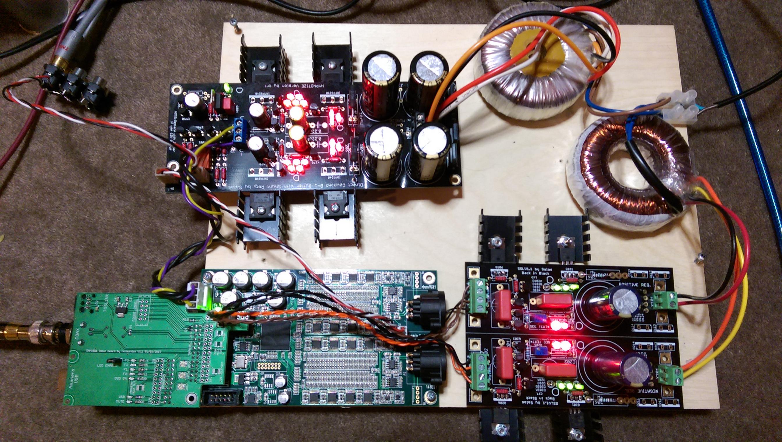

Rick is wrong with his calculations. The 78L05 has a typical dropout voltage of 1.7v @ 40ma. Add to that 0.7 for the diode bridge => you need at least 7.4V. Anything less will likely result in dropout and /or ripple at the 78L05 output.
Latest photos of my modified DAM.
1. A 4 pin polarized molex connector has been added to the input board to ensure +/-5V from the Salas shunt is always connected with the correct polarity.
2. Redundant 820uF nichicons have been removed from the board.
3. Panasonic 220uF Oscons substituted for 100uF caps.
4. Panasonic 1000uF Oscon added for local decoupling of V+.
5. Links added to the back of the PCB to aid current delivery.
6. Bridge removed.
7. Output OPAMPS removed.
8. Ladder output RC filter cap moved to back of Salas Hypnotize B1 buffer board. Currently using 1200pF silver mica.
9. Redundant 12 ohm SMD resistors removed.
How is V+ connected for your board? Maybe I'm not understanding something... but isn't it an open circuit when you remove the RC filter?(without shorting out R) I.e. right now it looks like you're powering everything from J2's +-5v input. I don't see how your 1000uF cap is doing anything useful in that config?
Similarly aren't you going to bridge the rectifier pads? When I removed mine I had to do a continuity check to know how to bridge that.
Hi Ristar, V+ is connected via J1. It only runs the digital side of things now. You can see a photo in the link below of how everything is connected.
As for the RC filter, I have only removed the 1200pF capacitor. The capacitor is in parallel with the raw unbuffered output. So I have a 1200pF mica across the input of the B1. Hence electrically there is no change.
The 1000uF just provides some local decoupling of the V+ (~10V) supply (which comes from the Salas Hypnotize board). The bridge is bypassed using the link on the back of the PCB. Only the V+ is connected now.
http://www.diyaudio.com/forums/atta...2r-sign-magnitude-24-bit-384-khz-imag2870.jpg
Hey thanks for the reply... helps me understand. So what I'm saying is the 12R resistors that you removed from the input CRC. Once you remove that... it is in effect an "open" circuit.
Do check if J1 is connected to your V+ and check if your V+ is actually connected to the rest of the board. If I'm not wrong... the last empty pad for the last C after the 12R won't be connected.
If it still is then I've misunderstood how Soren designed the power input for the DAM1021.
Ok maybe we are referring to different things. By RC filter I man the filter at the DAM raw output. Yes the 12 ohm resistors have been removed. They only feed power to the output OPAMPS so no need for this connection anymore.
