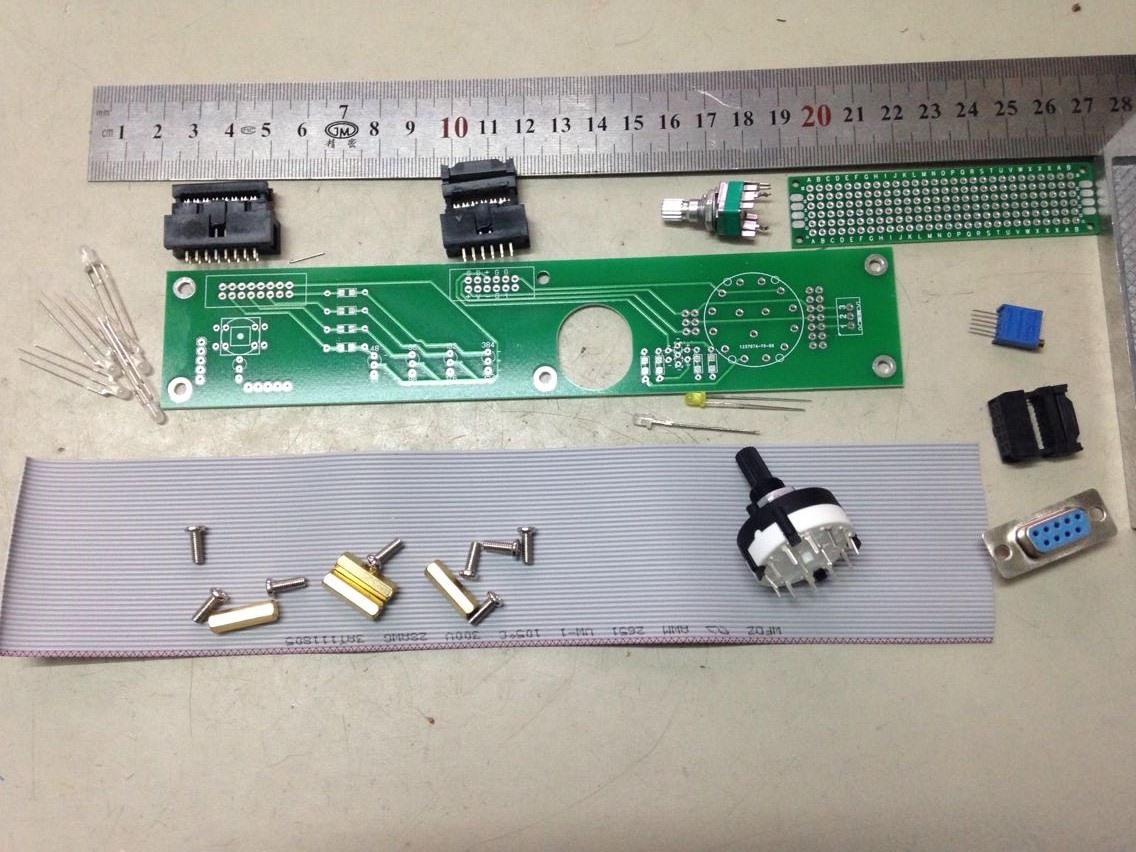

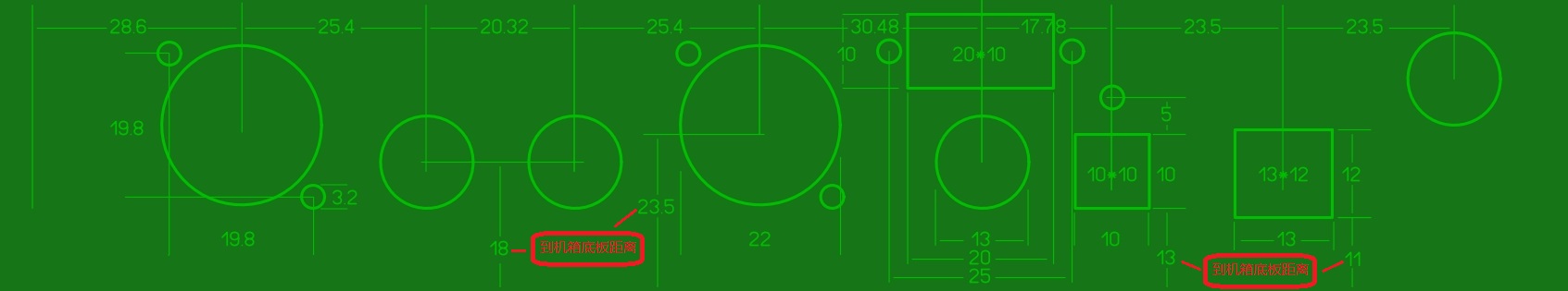

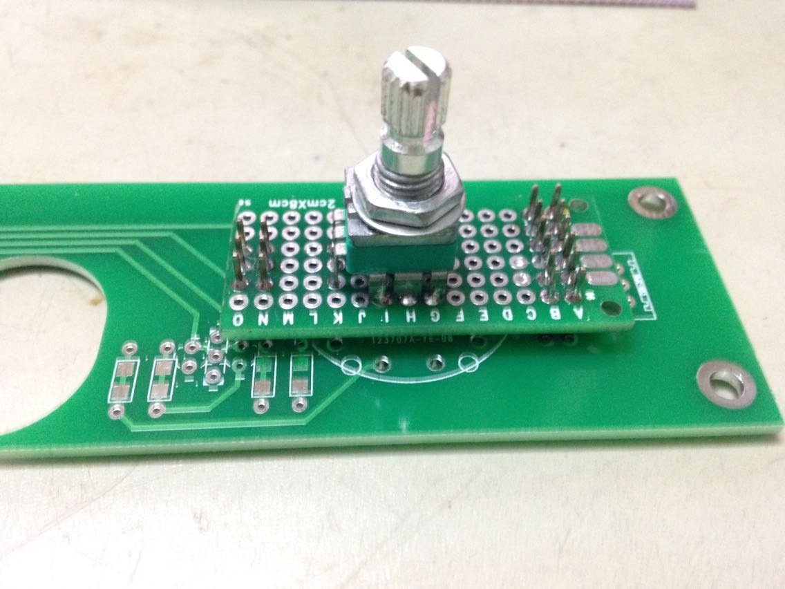

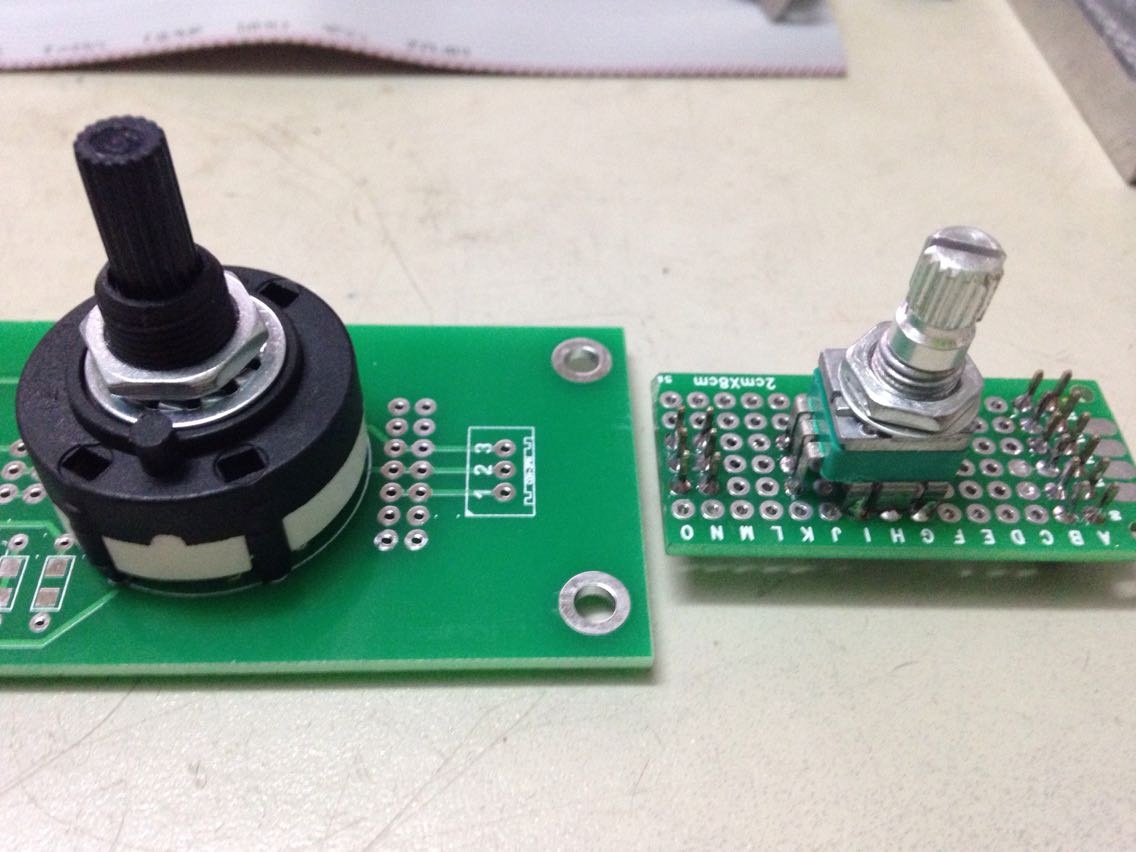

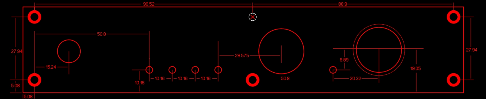

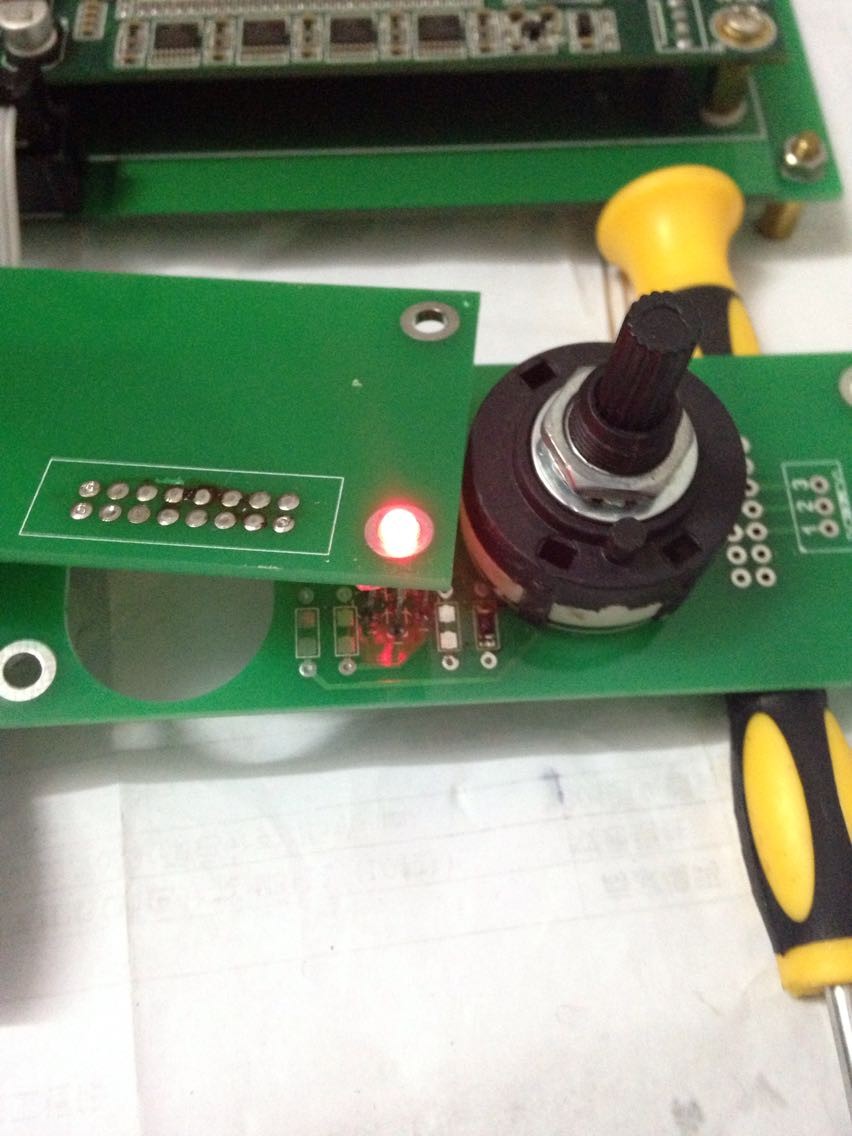

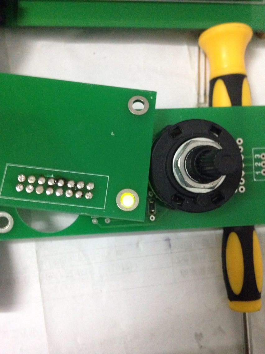

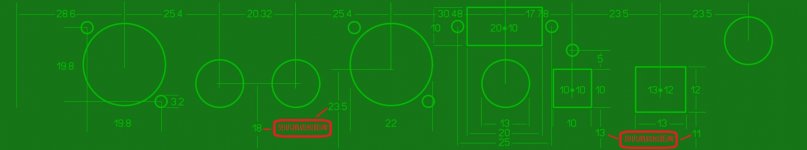

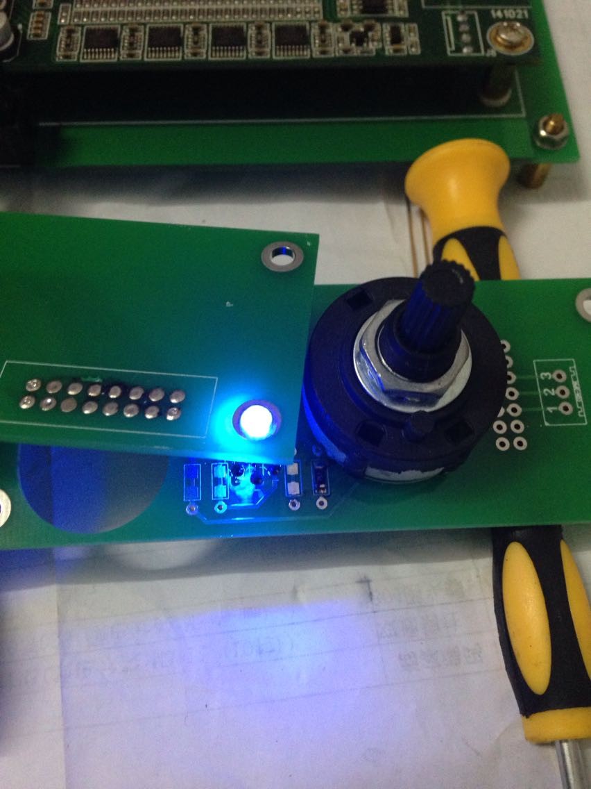

Because my English is poor, so you still look at the pictures.
4 dual-color LED USB input rate, four colors of a single hole LED display, and it is not locked will Flash.
Can be installed in the same location choice or volume.
