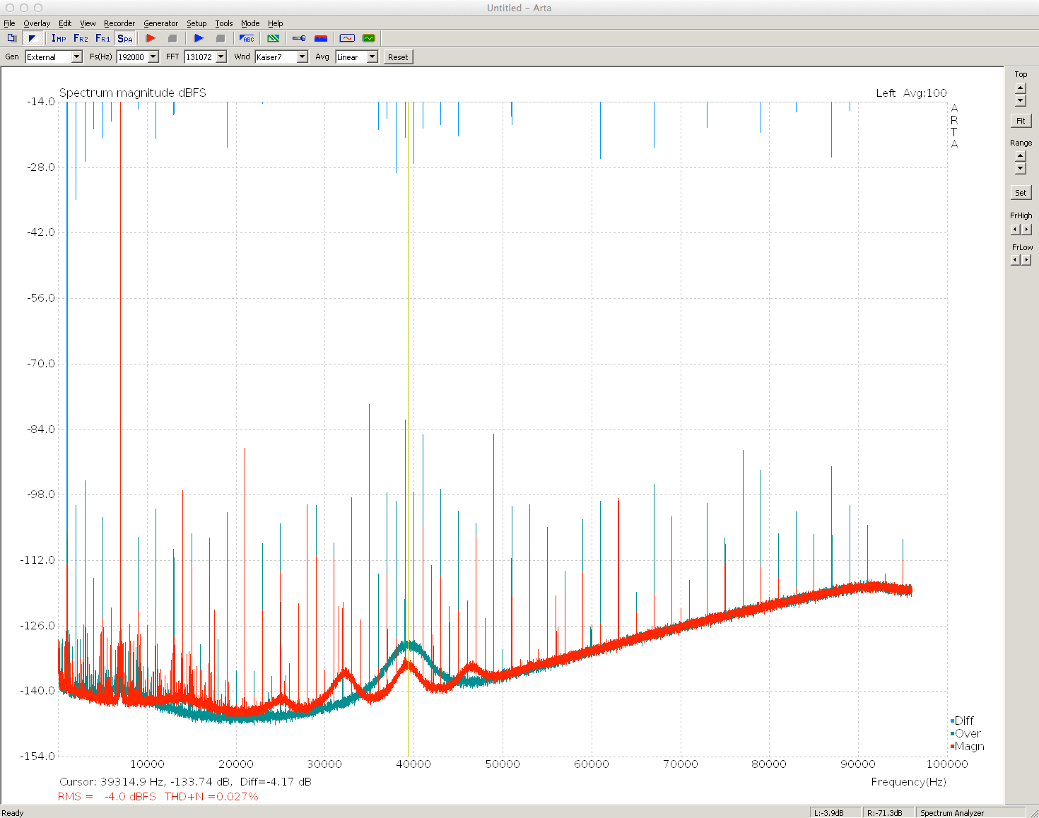

Some more facts on the 39kHz peaked hump:
On the measurement side it does not depend on the sample frequency nor the used window for the FFT.
However it moves down 3dB when you double the FFT length, like the noise (whereas i.e. the harmonics of cause stay where they are).
On the playback side the picture remains the same for fs=96,192,384kHz. The peak moves perhaps slightly down (frequency wise) for the 44.1 kHZ multiples.
You get the same picture, even a bit more accentuated as with dither, when you just add white noise. The hovel is gone if you round instead of dither/noise.
If you use instead the 1kHz signal a lower frequency the peak amplitude gets higher but stays at the same frequency, if you go to higher frequencies the hump gets flatter and begins to show a modulation. Picture shows this for a 7kHz signal (red) over the 1kHz (green) ... the area right of ~50kHz, except the harmonics, coincides with the noise floor.
To summarize I would say it is some kind of noise shaping, depending on the frequency of the test signal and the internal clock rate of the DAM. But yet I have no explanation whatever.
