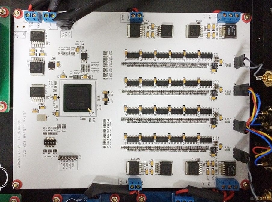

BTW, is there any consideration to use LME49990 on the buffer stage? Some say it is a better choice.
I saw another similar implementation from the east. No GB and not a commercial project though.
