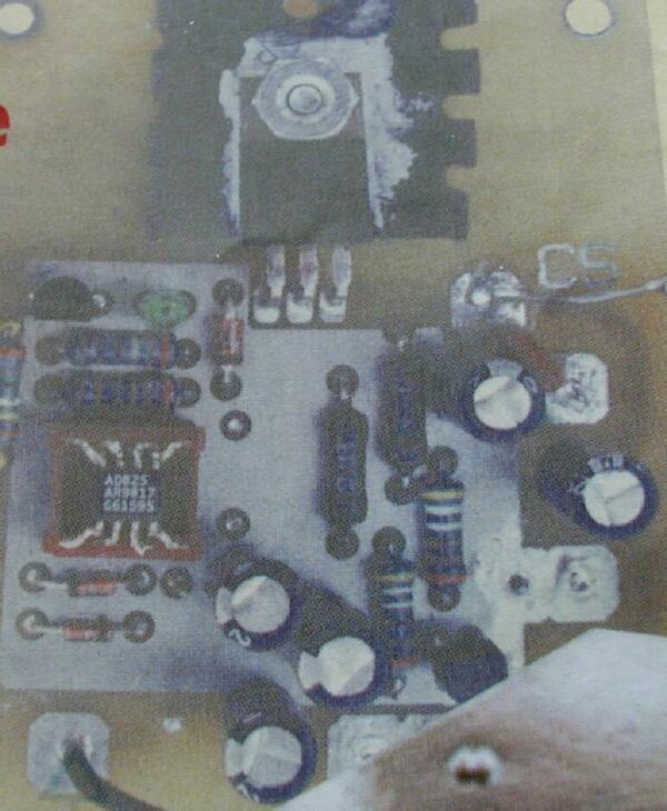

Walt Jung Regulator
Anyone know where i can get a pcb for the walt jung regulator or one alrealy built?
It looks like the PCB layout is critical for minimising noise, so i would rather get one pre made.
Kevin
Kevin
Regulator PCB
ITEM # PCBD-3A/B Didden/Jung Super Regulators
From Audio Amateur Issue 3/95. Each board contains one positive and one negative regulator. Each regulator board is 2-1/4" x 2-3/4".
http://www.audioxpress.com/bksprods/pcbs/circuitsbuild.htm
Perhaps Mr. Didden could coment on which version this is as I am not sure.

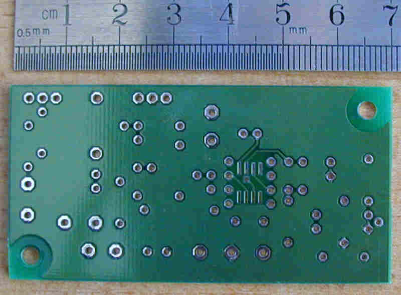

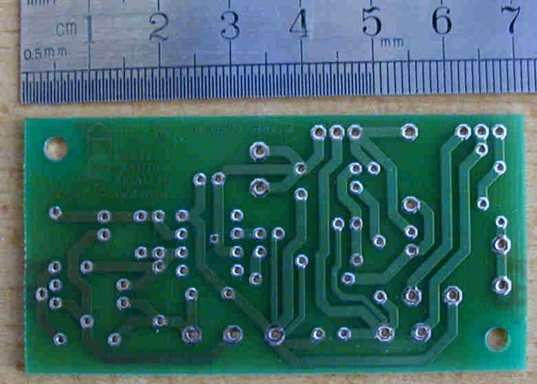

Reducing noise etc
Andy,
Looks pretty nice, with the start points etc. Did you already post the schematic? I would be interested to see how you translated it to the layout.
Jan Didden
Andy,
Jan Didden
Go man go
Bit of a problem with stuffing at present, the boards arrived a week early, and I've not ordered the caps and semi's yet.
I'm onto it though...
A.
P.S. Well chuffed with results though - I used the Eagle PCB package, which is free for very small PCB's such as this. It's by far the most comprehensive, easy to use package ever, and I've used a few.
Whilst it lacks a few of the features of something like PowerPCB, for example, it's huge collection of libraries (I only had to create two parts) and general simplicity make it hard to beat. It's biggest limitation in this incarnation is board size.
