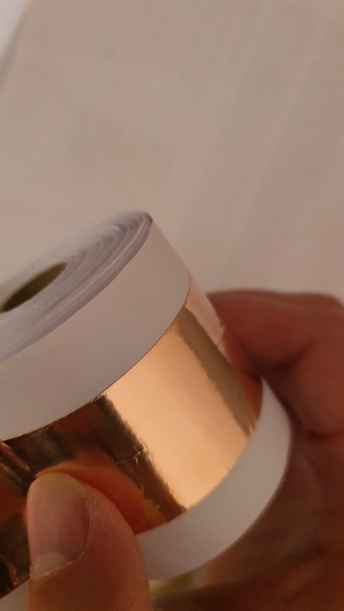

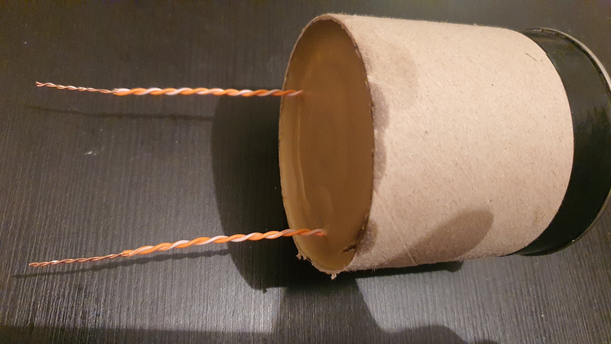

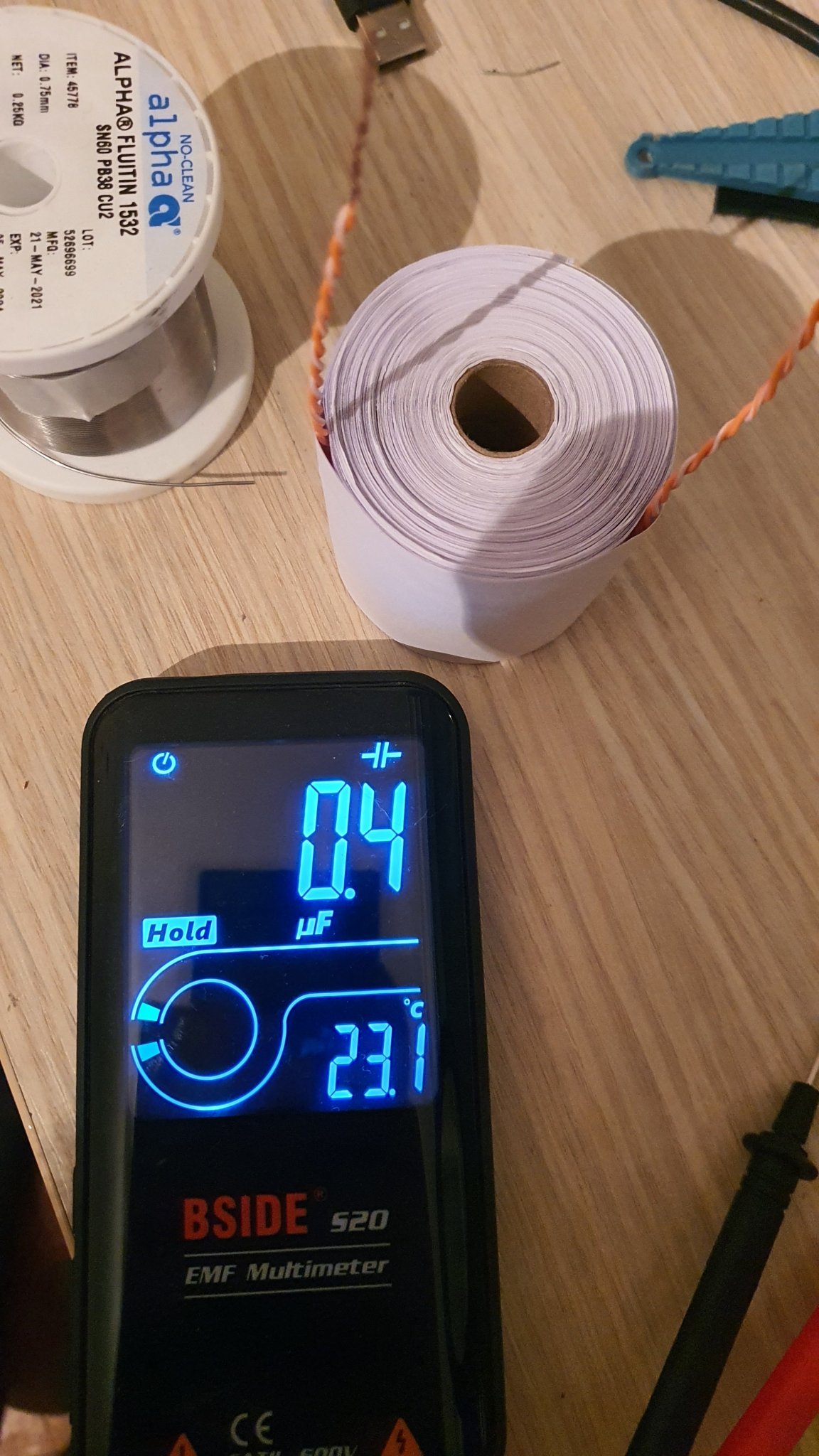

Hi. After a long time of job "grinding", i finally have some time for myself. So next to some serious projects (amp, speakers), i have went on to create something i wanted to do for a long time, and make pio capacitor. Had 20m of copper 0.05mm foil laying around and i wound myself a 0.4uF cap (pics in attachment), since i have access to both machines that can roll it tight, and vacuum chamber. Vacuumed with mineral oil, and encased in wax. Now i have been told to pay attention to inductance of such a capacitor. I have only connected leads to the ends of both foils (each foil is 10m).
Which leads me to this topic and the question at hand. What is the best way to reduce inductance in such a capacitor? How does duelund and the rest do it? What i have managed to pickup from the videos and photos, they leave extra foil on each side (so conductor/foils are not completely parallel, and one side protrudes from one foil, and the other side protrudes with another foil), and i guess they connect somehow those edges on each side (which can't be seen, but it's my best guess).

Stacked plates, not rolled, basically, so current can flow over the surface directly to every plate via an equally short path. In short timescales current flows on the surface (skin effect), not through metals. Or put another way have all the individual plates in parallel, not series.
I've never really grasped this. You have two electrodes. Current travels up one and down the other. It cancels out most of the inductance, in spite of the wound structure. Have you measured the inductance or self-resonance. Most inductance ends up being a result of the physical size and lead length, not the construction. Or at least that's what I think until somebody shows me how it's different.
I haven't measured inductance yet, haven't got around to it (get a meter for inductance).
Will update as i do it.

Yes, that's a non-inductively wound film cap for instance. Its possible to wind inductively too (why one would I don't know!). But any wound capacitor will be worse in high frequency performance than a stacked plate capacitor due to length of the current path. The current path length limits the wavelength of any RF signal the cap can handle and remain fully capacitive (if the unwound length of the foils/film is several metres, its hardly a lumped component at VHF!). However often the lead inductance is an issue too, which is why SMT MLCC's perform way better at HF - short wide trace over ground-plane direct to stacked plates.
