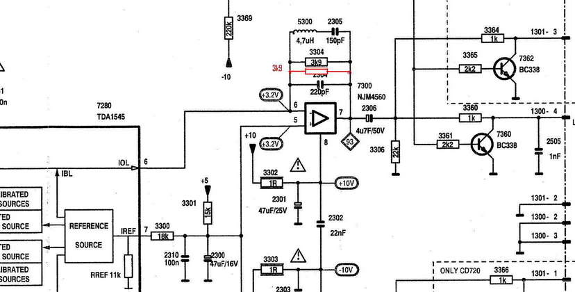

I'm trying to find ways to attenuate my CD player's output for use with a vintage amplifier. RCA attenuators are too expensive (can't find cheaper than €50 to get a pair in Belgium). So I see only 2 cheap and easy fixes:
- Put in an Opamp with less gain. Are there any dual Opamps with 6dB less gain than for example NE5532?
- Add 2 resistors per channel (one in series, one to ground) after the Opamp stage. I'm fully aware that it's better to put these at the amplifier's input but what's the difference if I put them at the CD player's output? More high frequency roll-off? My hearing craps out at 16kHz so I'm not too worried about that.
CD players I have are Philips CD710, CD634 and CD620. The latter two have variable gain output so I could play around with that without any mods. The CD710 however does not and will require a mod.

solder over 3304 and 3305 resistors another one 3k9
Nooo 🙂 I wouldn't do that. The stage isn't a gain block, its an I/V convertor. What about the coil and the cap ?
What you could do is just add a resistor across the 1nf cap at the output. Adding 1k would cut the level in half.
Any disadvantages of that over the other method (with 2 resistors)? So 1k would be -3dB, 4k -6dB?

There is no disadvantage with adding a resistor across the 1nf cap, its achieving the same thing. In this case you have a nice 1k to use as part of the attenuator, in the earlier thread there wasn't anything suitable without changing those 100 ohms. I have spotted one thing though, and this would apply to an external attenuator as well, and that is that the coupling cap 2306 in the above diagram could do with increasing by a factor of 10 to 47uf. That will preserve the low frequency response of the stage.
The resistor quality will have no effect. Use standard 0.25 or 0.6 watt metal films.
The really important thing is for you to make sure your player really is the same as the one in the diagram. If the 1k resistor is different then the attenuator would not work correctly without altering. Once you know what you have then its only a minutes work to pick suitable values.
If your not sure then ask 🙂
The important things are that the max load on the opamp isn't to high. All the ones in these players can drive 600 ohms so we have no worries there. So you choose your series resistor value... here you have a 1k that's already suitable... and so you just add another resistor from the output end of the 1k to ground. The lower the value, the less signal you get. Even if you shorted the output to ground the opamp still sees the 1k series feed.
If the player was different... say it was like the other example with two series 100 ohms and two muting transistors . Here you could increase the two 100 ohms to say 560 ohms and then add your attenuating resistor to ground in the same way.
In all cases the coupling cap needs to be big enough to maintain bass response into the worst case load, which we will say is 1k. That puts a value of around 47uf on the coupling cap.

It's the same as in Impuls' diagram. So I use 1k in series with the coupling cap and 1k across the 1nf cap? Could I also do the 1k resistor without any resistor in series?
Also, how do I calculate the values?

All the players I posted above have two resistors in series so I increase the values x5. Where do I put the attenuating resistor though? There already a 10k resistor there going to ground. I could add a 1k resistor parallel with that one?
Stabby just do it as i wrote, nothing more
Sorry, too risky. Putting a resistor in that place could noticeably affect sound. I'd give it a try if several other people can confirm it's okay.

Maybe making my own cable would be easier and less work than inserting an attenuator in every single CD player. I'll try putting some resistors in the CD710 though.
Nonsense, current output of the DAC and i/v the resistor will affect the sound, but put 1k from out to ground after 4u7 capacitor will not?
Learn how to use the opamp for i / v conversion and everything will be clear in mind
On picture for cd610, cd471 and cd620 is lowpas filter, on picture for cd615 is gain stage
