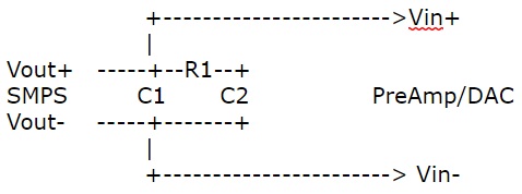

Is my understanding correct?
R1=10ohm (0.25W?), C1=C2=20uf cermaics/10u electrolytic.

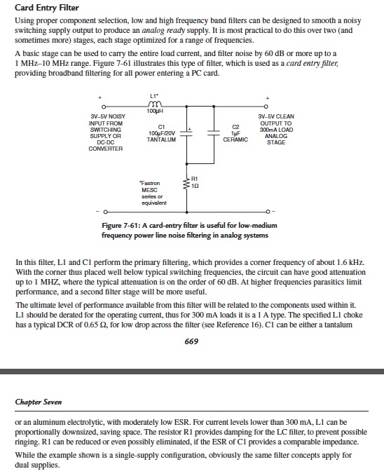

Adding to what I've already posted, and Tomchr's comments: you just don't have to reinvent the wheel here!
Look at detailed references like the excellent Analog Devices 'Op Amp Applications Handbook (Walt Jung, 2005): it's available free, online, as a PDF and will reward close & repeated reading at any level.
Anyway; here's one suggestion it contains, in a section you really ought to read: the voltage noted is not important - how the idea works, is - it will work exactly the same, at 30v in, or 300v come to that:

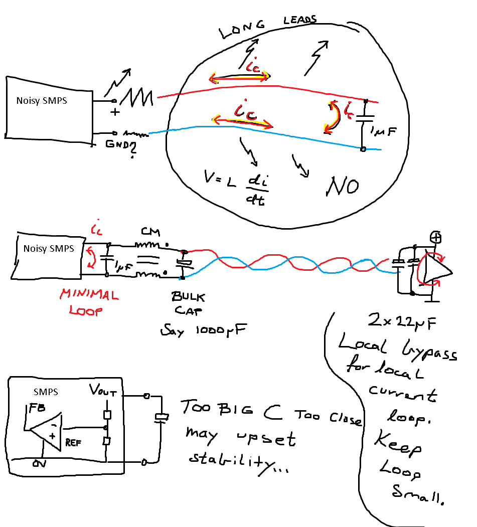

Tomchr mentioned 70kHz... I dunno, but it is high frequency ripple. Here's a suggestion. U dont want a very large C near the output b/c u dont know how the feedback loop inside the SMPS is... There should be a datasheet stating max C. If you buffer the output with some resistance or better a choke, even a CM choke, u can probably go much bigger with the C since u probably isolate the large C from the feedback loop inside the SMPS that way.
Ripple currents into the small cap can be high and with fast edges, so keep that first loop as small as possible.
How much C u need near your circuit being powered depends on it's output (load) currents and if they are pulsed as in a class-B type or if they are averaged to a constant value as in class-A. Treat the circuit being powered as if being fed with a high impedance power line, (current source), and the local caps should provide all currents for the signals. U can figure the slew rate if u know the load and signal amplitudes. Then figure out minimum C using C=Ic*dV/dt.

From here on i am lost, dint get how to sandwitch 2 caps with 10ohm.
I can partially understand smallest loop for supply with 1uf,
But how complete the CRC of 10ohm, 7uf ? you have a complete diagram with components values?

I'd just place a small ceramic and a bulk electrolytic close to the output of the power supply, then a series resistor of 10ohm, or an inductor, then new bulk electrolytic, and maybe a faster ceramic or film as well, but be carefull, it may resonate.

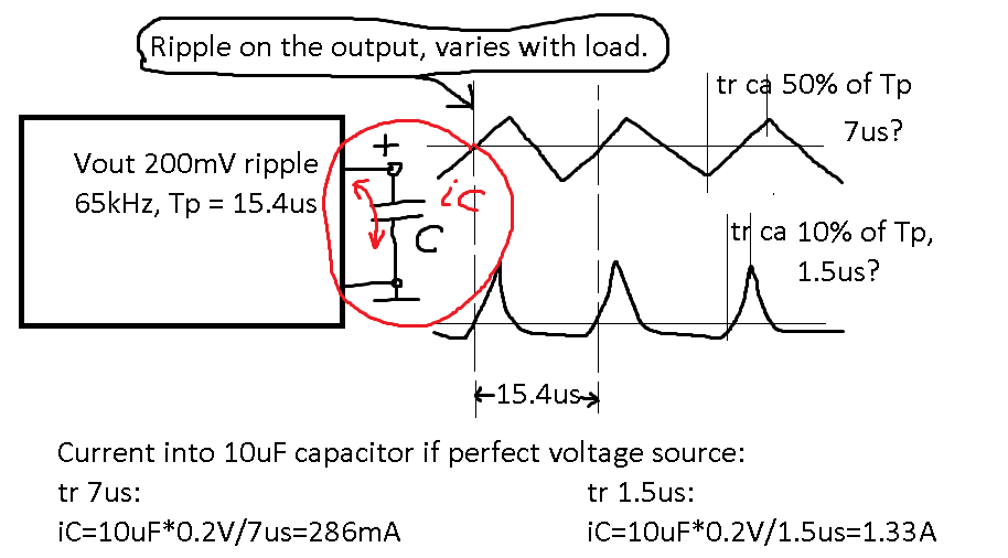

No need to go too theoretical, but here's an attempt:
The shape of the ripple is unkown and can be anything from a 50% saw tooth to short but sharp spikes, the ripple is supposedly 200mV in value (peak? or is it average value?).
For the first cap on the output, the ripple will cause large currents, and you want to keep those currents close to the power supply. Then you can have some resistance, or inductance, which will limit the current spikes from going down the wire (antenna). 50mA iq means even a 10ohm in series will only drop 500mV DC.
You have two things to think about (and a bazillion more since this is HiFi). First the power supply and the loading of it, then the circuit and it's loading of the power rail. Usually small signal circuitry like this runs in class-A or close to it and the average current draw is steady, DC-ish. But you still want local decoupling so current peaks are not drawn through long wires and from bulk caps far away. The minimum size of the local cap is determined by the peak current (iC) and it's rise time (dt), oh and the max ripple you want to allow (dv). Cmin=iC*dt/dv

Attached drawing of ripple current into a 10uF cap if power supply is a perfect voltage source (that it delivers the current). Notice how the different ripple wave forms alters the current into the same cap.
