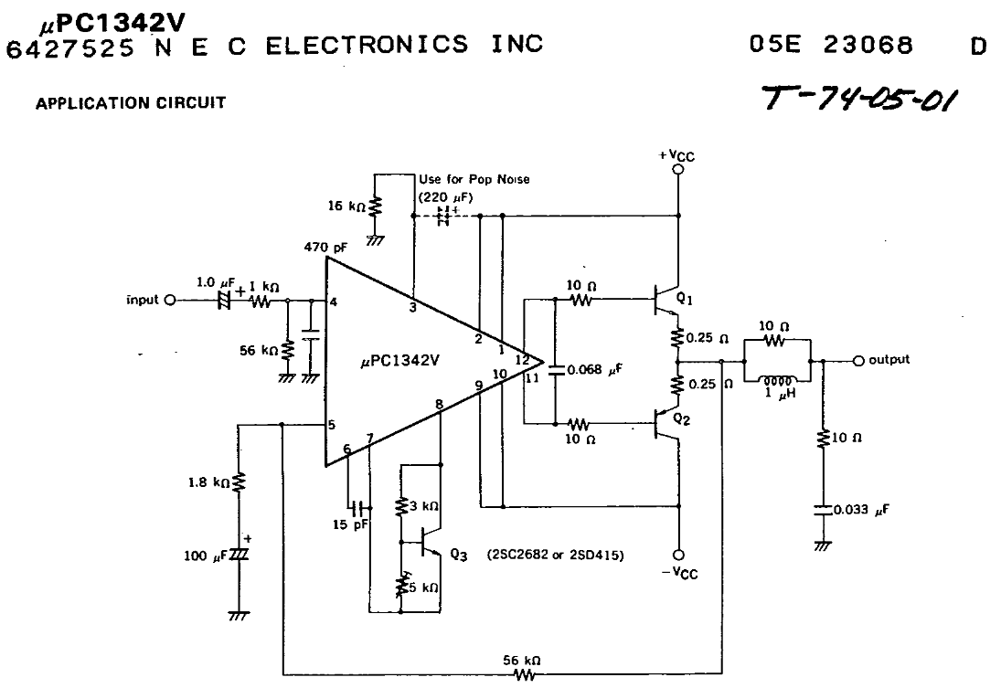

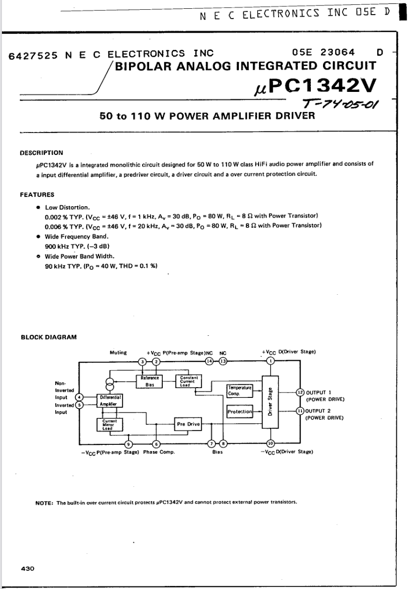

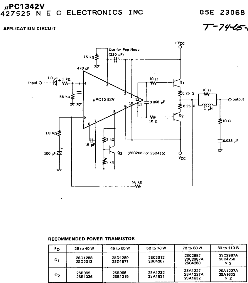

Does anyone have any experience or wise suggestions with regards to lowering the uPC1342V gain and selecting the compensation capacitor?
I currently have 1.8k and 56k for gain (see attached schematic) and 22pF. (Schematic shows 15pF, board came with 22pF.)
I would like to use 5.6k and 56k for gain. However I would like to appropriately adjust the compensation capacitor at the same time.
There may be "the lowest available gain of upc1342" in the manual
It may not work properly at 11x magnification. Friends, you have to be careful.🙂
I think the 12-22pf capacitor is suitable. It can adjust SR according to specific needs. There may be these contents in the manual. Maybe you can try more complicated compensation methods, such as double pole compensation.
I will look at the datasheet again. I asked the question because I am concerned that it might not be stable if I lower it. I was hoping someone else had lowered the gain successfully. If not I might need to leave it alone.

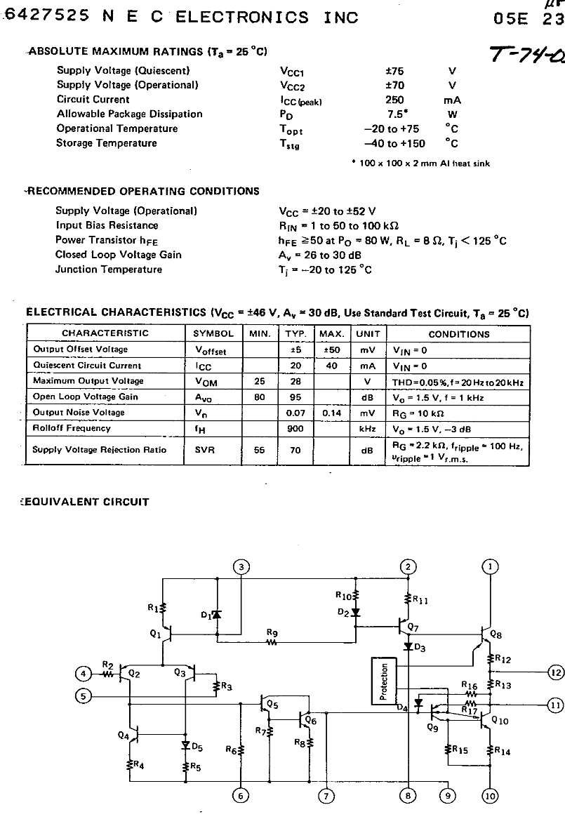

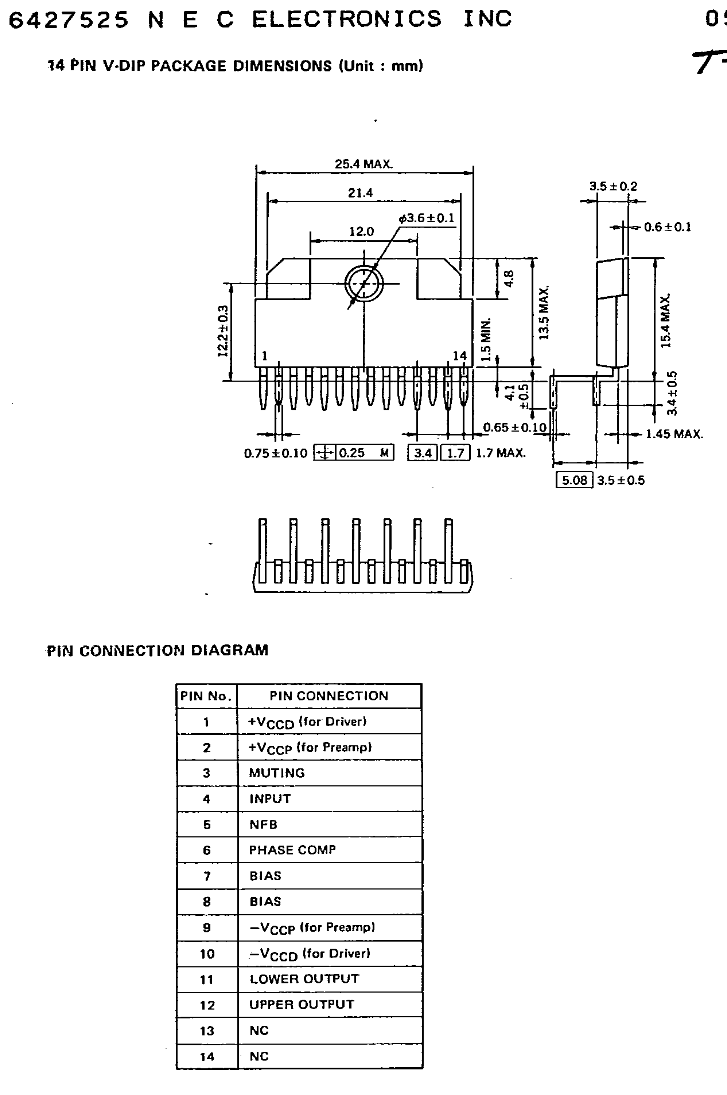

Unfortunately the datasheet I have does not give information on compensation or gain options.
Perhaps I will try all my other experiments first and leave the gain and compensation as a last experiment. (With a DBT and small fast fuse.)

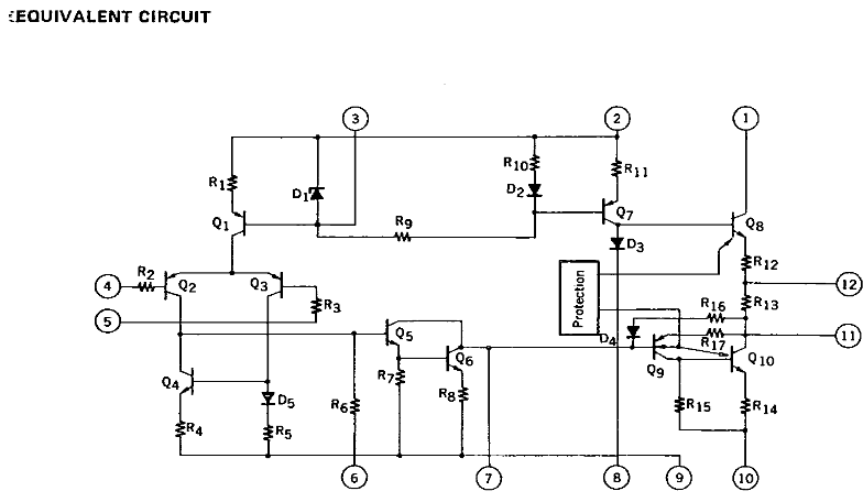

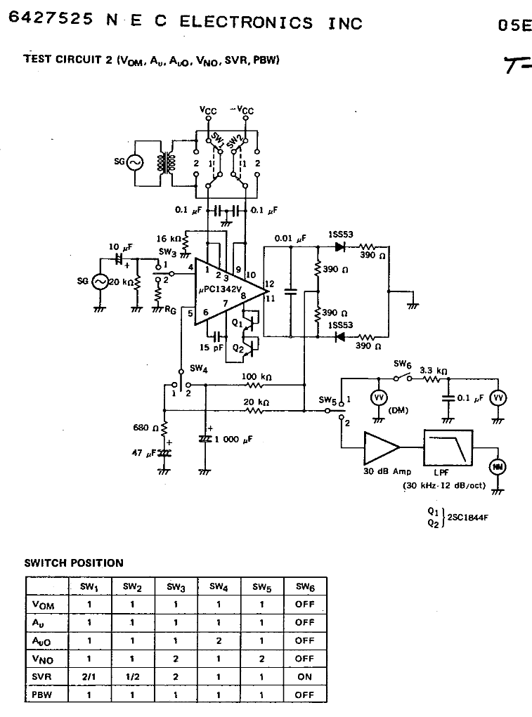

I have adjusted the gain of amplifiers like the MX50SE successfully but this driver IC is a little bit more of a black box. I have attached the equivalent circuit. The compensation capacitor is connected to pins 6 and 7.
Unfortunately, there is nothing in the manual that we need.
The capacitors between pins 6 to 7 are Maitreya capacitors. Refer to LM4702, LME49810 and other similar ICs, and their value may be between 10-25pf. When the gain is 30 times, we can try to input a 20kHz square wave, and then gradually reduce the 15pf capacitor. If the rising edge of the square wave begins to overshoot, the capacitance value at this time is the smallest usable value. For safety, we can appropriately increase the minimum usable value of the Maitreya capacitor in actual use.
The manual does not provide the minimum usable gain or open-loop phase frequency diagram. But refer to the typical examples in the manual, and the situation of similar ICs such as LM4702 and LME49810. Similarly, we can gradually reduce the gain and observe whether the amplifier oscillates, and then leave a proper safe space. I think using 30x magnification is safe and applicable.
The smaller the resistance, the lower the noise. If you use a magnification of about 30 times, I suggest using 500R and 14k resistors. At the same time, you must also adjust the value of the coupling capacitor and the negative feedback capacitor. Capacitors are not expensive, and it is not difficult for modern audio sources to drive 10k resistance loads, so I think these costs are worthwhile.
After all the above are done, we can try to add more complicated compensation methods such as double pole compensation to further reduce the distortion.
Looking forward to your good news.:p
The input low pass filter and the compensation capacitors appear to be tiny ceramic capacitors. I don't know the manufacturer, dielectric type or rated voltage. (Picture enclosed.) Hopefully they are NP0 but I don't know what the board was built with.
Does anyone have any comments on suitable types of capacitors for both purposes?
I was thinking of putting a small (10-15 pF) cap across the 56k feedback resistor and/or increasing the compensation capacitor prior to experimenting with reducing the gain.

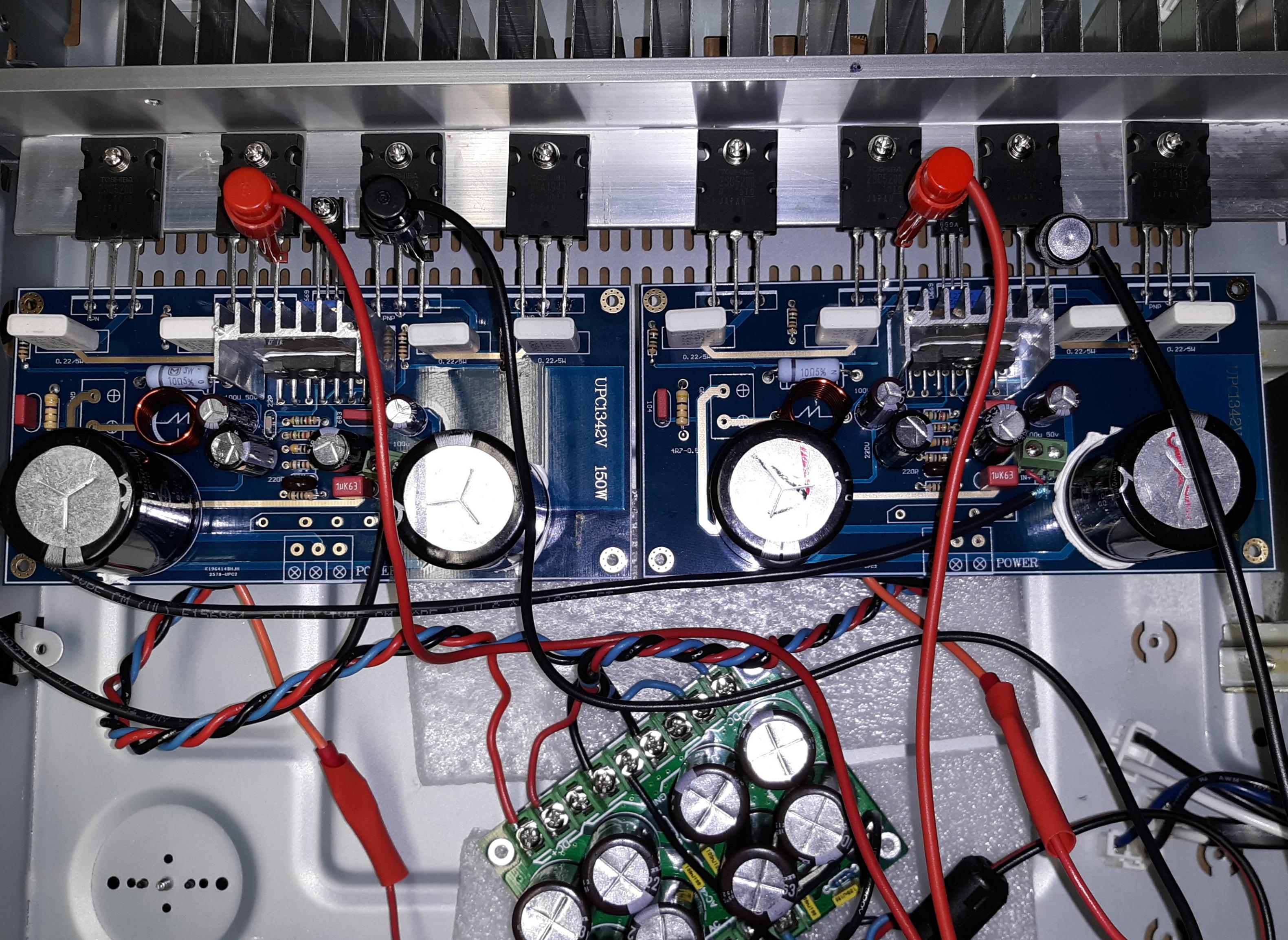

I have attached a photo of my uPC1342V where I used an external rectifier and filter board to make sure that the rectifier and noise/interference from the rectification of the large signal AC power would not be a problem (so close to the input components/stage).

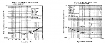

I did my first distortion measurements up to 8Vrms into a 4Ohm test load. The load is getting pretty hot so I might get a larger one before going higher.
I would appreciate expert comments and interpretation of the distortion measurements. (Keeping in mind it is a 4Ohm load not 8Ohm, and keeping in mind that I only went up to 8Vrms.)
