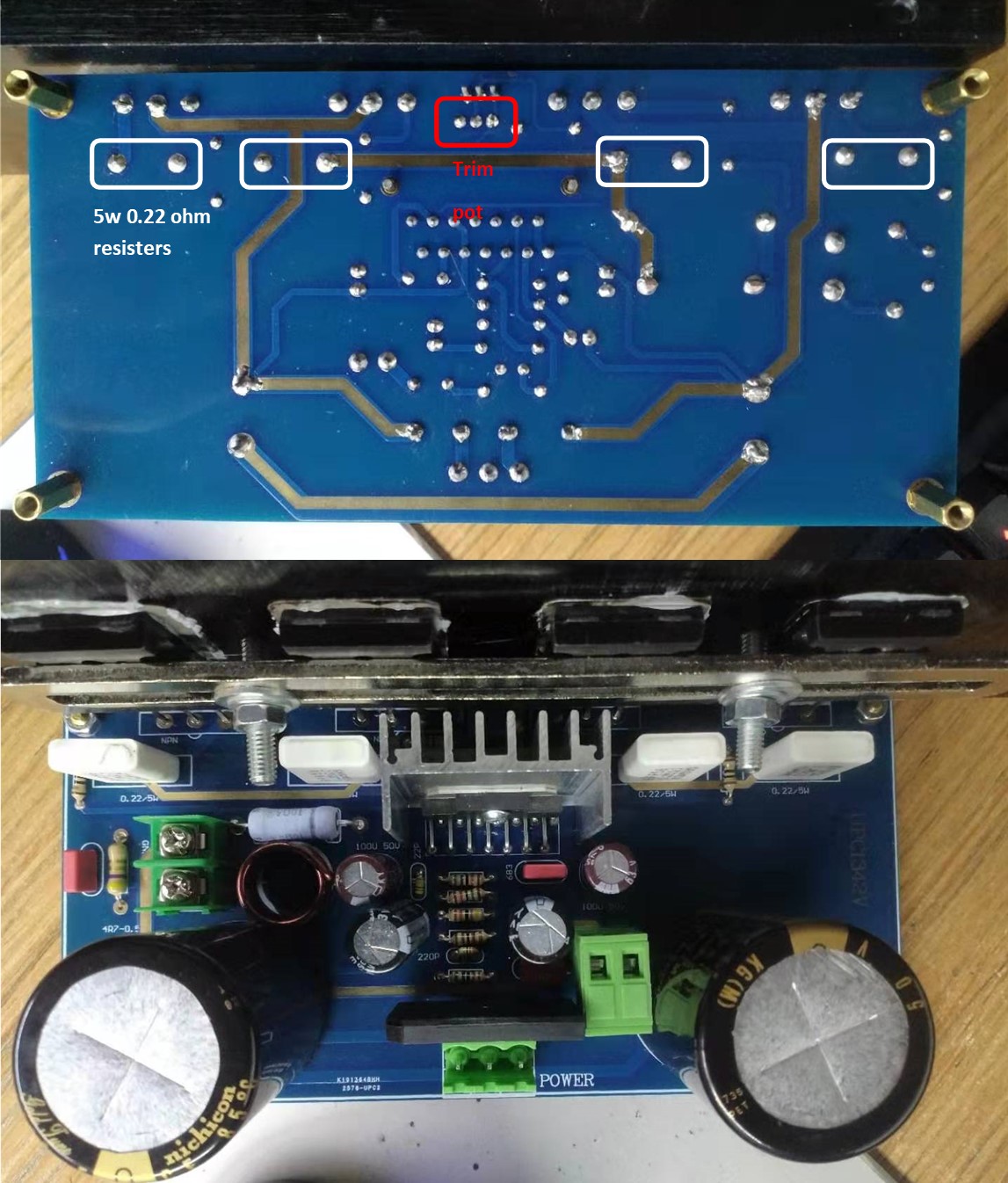

There's a trim pot, I kinda guessed that would be the key to it, but I have no idea where to take the readings from. There are 4 5w resistors
attached a few photos of my board, can you point me in the right direction?

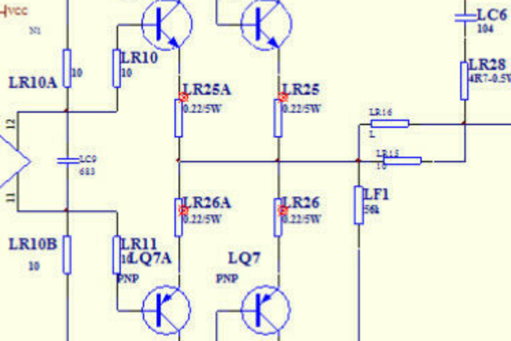

It is a mono chip but you have 4 output transistors and 4 low impedance power resistors. The power transistors are very likely used two and two in parallel to increase current handling and thermal distribution. The four 5W resistors (0.22 Ohm?) are used to balance the currents in the parallel power transistors in the traditional way.
The current in each 5W resistor will be half the total quiescent current because you have two transistors in parallel sharing the current. Less quiescent current leaves less power transistor heating, more quiescent current gives less cross-over distortion. 70mA quiescent current in one push-pull set is usual. That means 140mA for two parallel sets.
Put your voltmeter in the most sensitive DC range and across one of the four 5W resistors. No signal at the input. Adjust the potentiometer to 15mV (dc) on your voltmeter. Check across the three other 5W resistors that you also have 15mV there.

Not sure if I am barking up the wrong tree here, but here's my current situation.
My voltmeter is set to 2v range, so I should be looking at lowering the trimpot until it reads 0.015v so its 15mV, correct?
It seems the starting voltage was 440mV, at least with my 'methods'. 440 down to 15 seems...a lot
and what do you know, it works!
really surprised, but after 10 minutes of playing an mp3 from an old phone, it was warm, but actually cooler than I expected, so If needs be I could probably raise the power a little.

The (total) quiescent current you know by measuring the voltage across one 0.25 Ohm/5W resistor, divide this voltage with 0.25 Ohm and multiply by 2 because you have two power transistors in parallel.

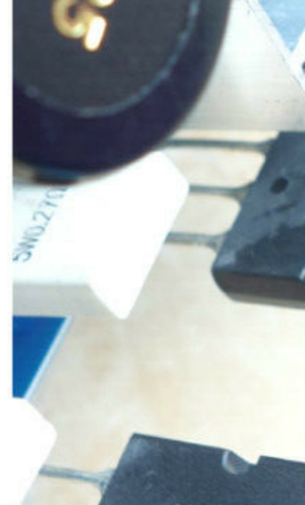

Your resistors don't look like 5W resistors (maybe I'm struggling with the photo). 440mV would be creating less than 1W. This could be a problem.
