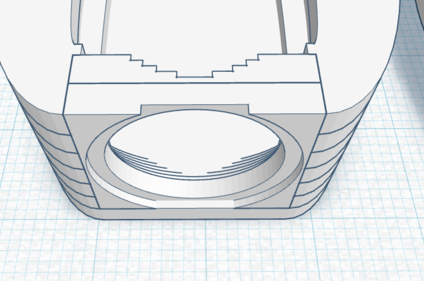

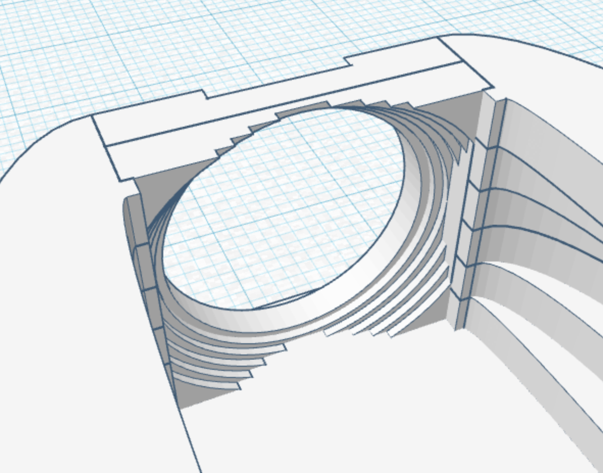

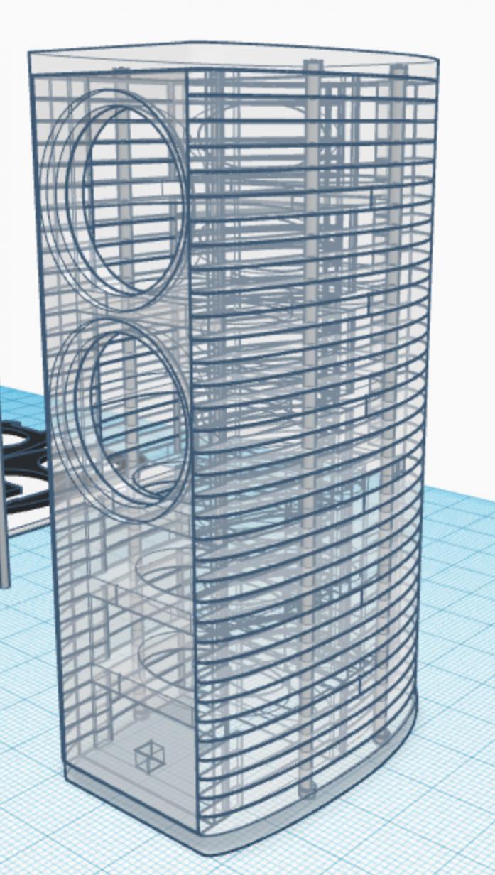

About plywood vs MDF. Do either of them have any significant acoustic advantages or disadvantages to each other? Because I don't really worry about the construction at all. I will have all the wood CNC machined by a woodworker so the dust isn't my problem and even if it was I won't worry about it at all (What's all the fuss about the dust about? Just put on a mouth cap when necessary and just clean you work space up afterwards.). For screws, well, I don't use screws. When all the wood has been cut by the CNC, I basically have on huge Lego set. To put everything together I use Bison WOODMAX, the professional version. It's even much stronger than screws, immediately seals everything up and it's super easy to work with. To make construction even simpler and perhaps offer some extra structural strength. I will be sticking two metal rods through each side panel. I can simply begin by sticking them through the middle brace and I can just stack everything up from there. Then when all the layers have been stacked up, I put bolds on both ends and bold everything together tightly. This way everything stays perfectly aligned and is pushed together very well while the kit is drying so it makes a extremely strong bond. Because they keep everything together, I can leave the baffles of, I can easily lay the wires and put in the damping material and when that's done, I can put the baffles on and... done.

Well my speakers will be stationary so really the heavier the better for acoustic reasons
Heavy is not an advantage in a loudspeaker unless it brings other benefits. Quality 15mm plywood out does 18mm MDF. It also has other advantages.
But you are throwing many of those advantages by doing translam and not using the material in the orientation it is designed to be used in. No matter what you use it will need to be something like 2x as thick as if you used it in the manner it was intended.
And i will repeat — the horizontal braces will not have significant effect. You should have lots of vertical and only a few horizontal braces.
dave
Then what are the other advantages of plywood? Not that I would use it anyway, that would get too expensive for now.
How does using the material this way make it less stiff?

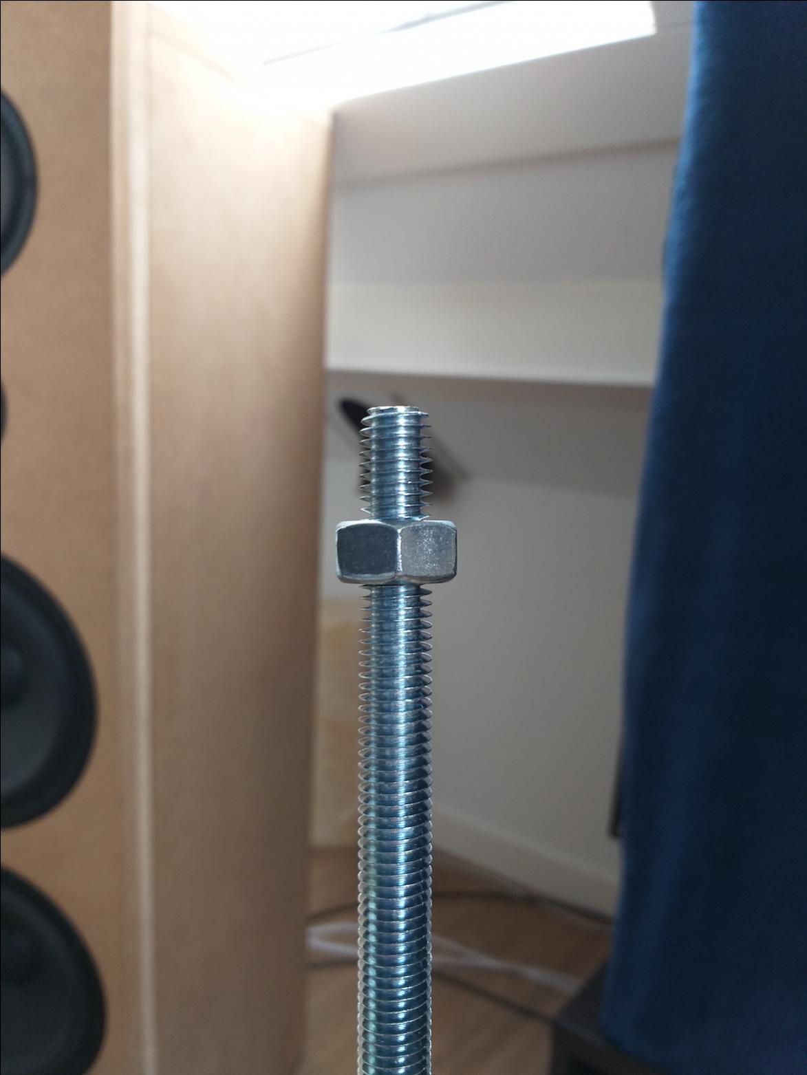

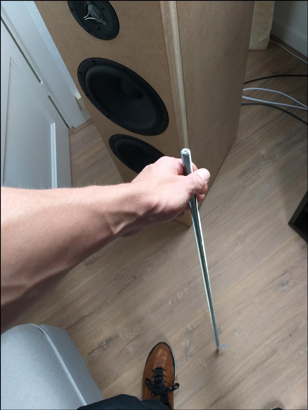

Well the horizontal and vertical braces are integrated into and reinforce each other and the horizontal braces also reinforce the baffle and rear so de do certainly serve a purpose. But the way I will be constructing the sides makes the bond between the layers extremely strong and and act like a single piece, I'm sure. The Woodmax kit and metal rods (which are 12M thick stainless steel by the way, extremely strong) keeping everything packed together extremely tightly will definitely transform the layers back into a single panel. So the horizontal braces should definitely also reinforce the sides. And the sides are 3,5 cm thick which is extremely thick and there also are all these vertical braces which are an additional 2,5 cm. It should be extremely rigged.

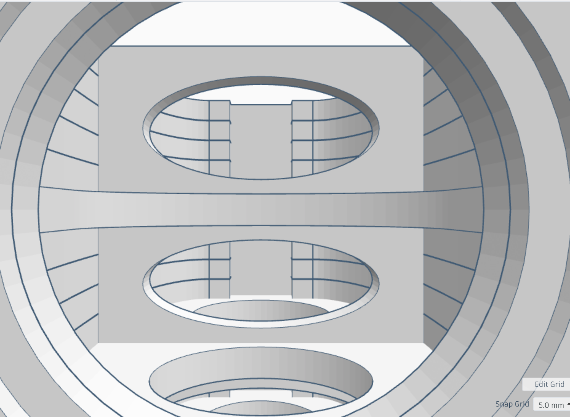

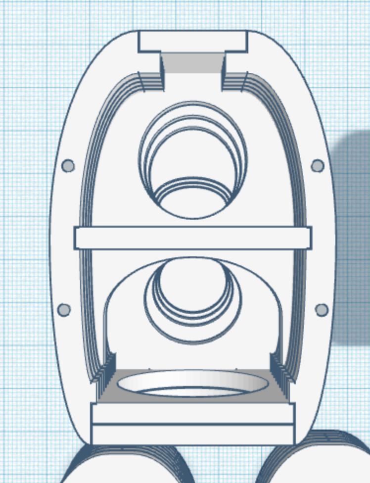

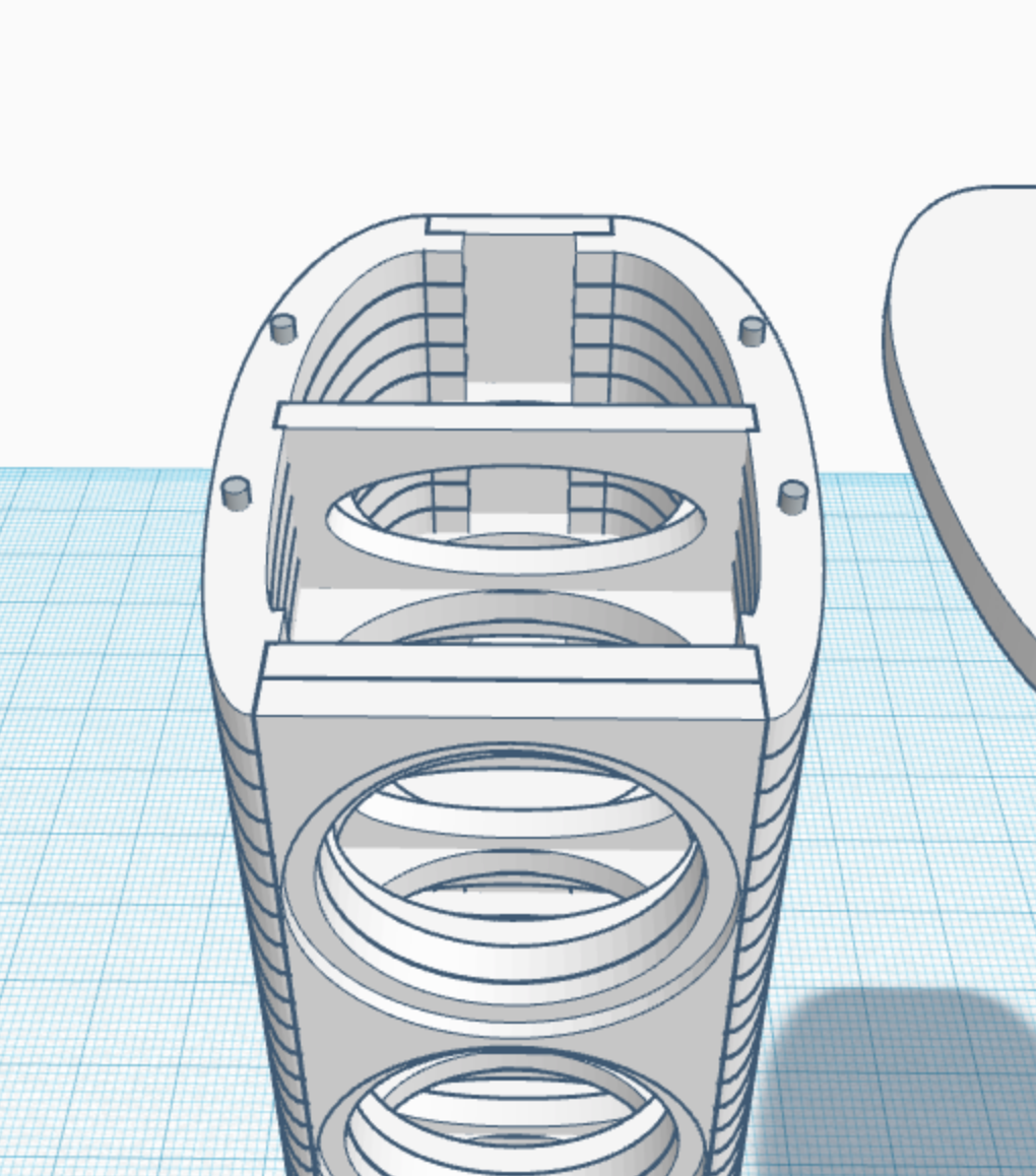

I increased the thickness of all braces. I figured it doesn't cost anything but will again greatly increase stiffness. I'm sure these cabinets will now be extremely stiff. Where the holes in the vertical braces are at their widest (in the middle) the walls are already 7,25 cm thick. The resonant frequency will be far above the pass band.
About the way I construct these cabinets. No, stacking is not at all a material efficient way of building them, but I don't know how to get this shape otherwise without getting extremely complicated with shaping my own plywood in a press and such. That's just way too complicated.

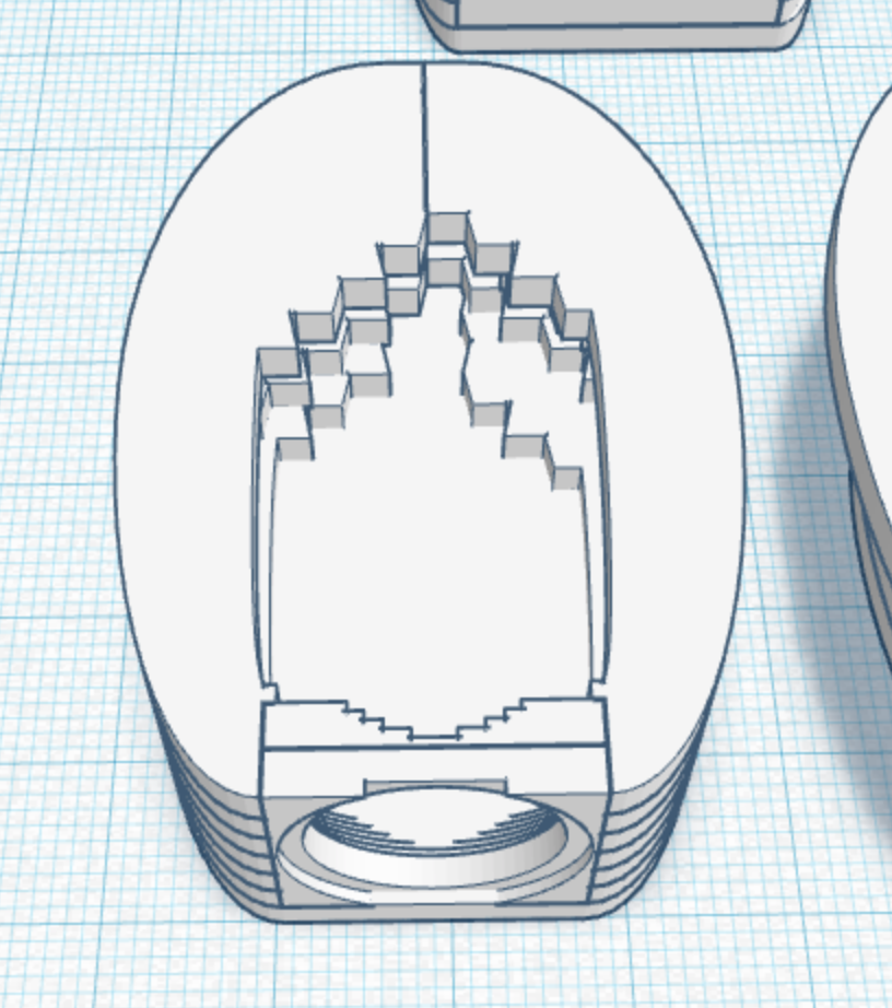

For the midrange chamber, the sides and top and bottom already were very stiff because of the big pieces of wood that make up the diffuser though the baffle was only a single layer. I now also made the midrange baffle double layered but beveled. This does take back away a lot of the thickness but it's still something thicker, and at the same time acoustics are actually improved.

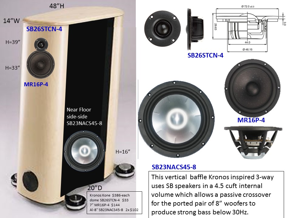

The woofers generate most of the cabinet vibration, which can be avoided if you mount them side-side for counter-force cancellation. Mounting both woofers close the floor will provide uniform floor gain, which simplifies the crossover and equalization. A good 6" midrange will have a low enough crossover to maintain a quarter-wavelength point-source imaging to 8" woofers about 12" above the floor. High quality(low-Le, reduced cone breakup), 6" midranges have become popular because they cover the entire vocal range without a crossover. The SB MR16P-4 is one example. You can construct a "V-shaped" volume behind the midrange to reduce resonances like a tapered tube. Just create a large volume directly behind the midrange for large air pressure changes, and put absorption material in the tapered rear volume.
You can focus on either "soft mounting" (rubber O-rings) the midrange and tweeter to the front baffle, or adding a couple pounds of sand compartments into the front baffle. With side woofers, the front baffle can now have very low edge diffraction 3" radius round overs and still maintain a narrow appearance. The heavy 3" thick front baffle can also be constrained layer attached to the cabinet for further isolation.
The front baffle 3" radius rounds can be saw-cut and belt sanded, or machined on a cabinet shop shaper. Plywood panels construct main cabinet. No CNC required.
