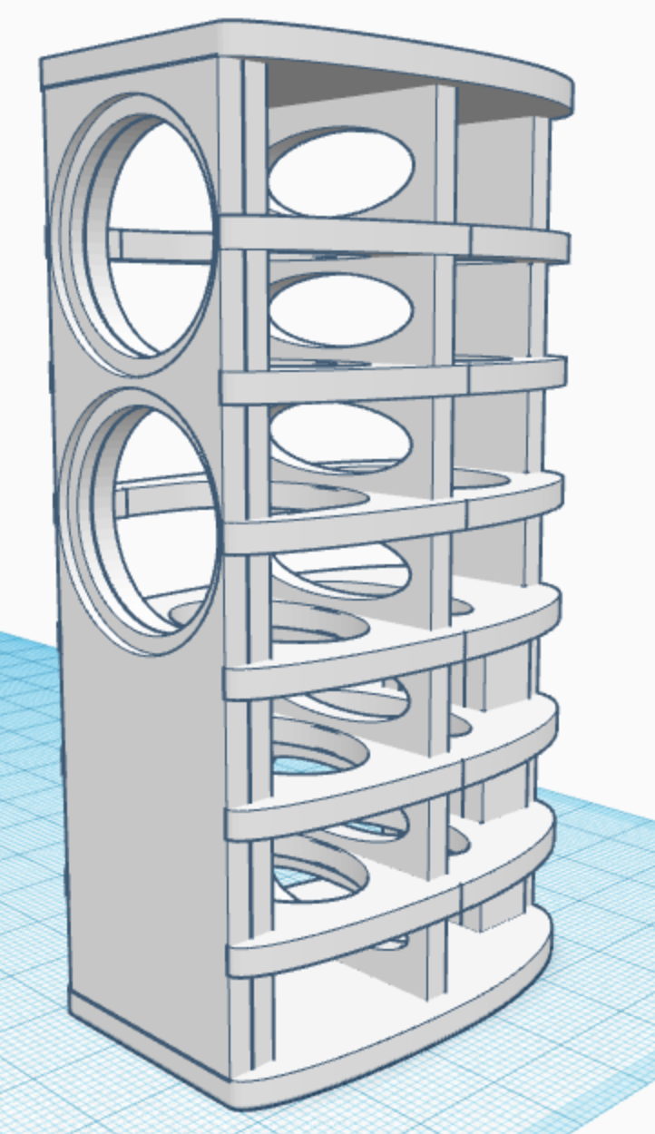

Well uhhhh, then I don't know what to do anymore either. For this particular design for something in these dimensions without making it too complicated or ugly I think it doesn't get a whole lot better than this in terms of avoiding standing waves. Of course the damping material will also take care of most of the problems.
There are a lot of things you can do to counter standing waves. I already mentioned an internal Helholtz absorber. If you don't want to do that, build an acoustical sump. For that you fill the bottom of the speaker ~30cm with high absorbant material, mineral wool i.e., even if I'm usually not a friend of these because of the particles. Put a top layer of fabric or fine acoustical foam above them. Very cheap and effective too, and you can change it quickly if you aren't satisfied.
About the different widths of the woofer, midrange and tweeter boxes and the different diameter roundings. Won't this be a great option? Cutting of a triangle along the entire edge where the woofer and midrange boxes are wider than the tweeter box. This should solve the problem of diffraction on those flat surfaces but I can keep the midrange and especially tweeter boxes nice and slim with large diameter roundings.
That'll still give you diffraction/reflection - just at a different angle. Rounding with a great radius is actually the best you can do, followed by a large beveled edge.

Okay so about the vertical standing waves in the bass enclosure. They can be prevented by a big stash of dense damping material in the bottom of the cabinet. If I where to put that in the bottom of my cabinets, are the slanted top and bottom still necessary/do they still make a significant difference? Or won't it make pretty much any difference if they weren't there?
Of course they will always have an effect but is it still that significant at all if the standing waves are already being dealt with by the damping material?
I'm asking because I want to make the best of this but removing the slanted top and bottom will make the construction a whole lot simpler. If they will still make a significant difference I'll keep them in but I would like to remove them if that's not the case.
The large amount of stuffing may reduce the standing wave, certainly its harmonics but needs to be near 1/4 wl thick to kill the fundemental. The slanted top/bottom will make only a small difference if any. I will often slope the top of an ML-TL with little imapct on the fundemental.

For your mid cabinet I would make the bottom and top more narrow, so there's more diffusion.
A bit like XTZ did in their Divine.
As stuffing for the mid: Twaron angelhair 3gr/liter, works phenomenal !
...with damping on "walls covered" the qtc is at 0,707 in a volume of 72 L with a F3 of 44,9 Hz...at "heavy fill" qtc is at 0,707 in a volume of just 49 L with a F3 of 49,4 Hz. keeping the volume at 72 L gives a qtc of 0,632 with a F3 of 47,5 Hz...
Polyfill will not be very effective on the walls. It should fill the enclosure. As well as the volume you fill there is the density you fill it at. Well teased polyfill can compress to pretty dense. We would also line the walls near the drivers with 12mm cotton or wool felt. I second the suggestion of quality “polyfill”. Acoutastuff is readily available over here so is what we use.

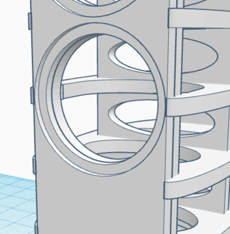

So I removed the slanted top and bottom and did some other tweaks to the enclosure again to make the design and eventual construction a lot simpler and make the enclosure stronger in the end.

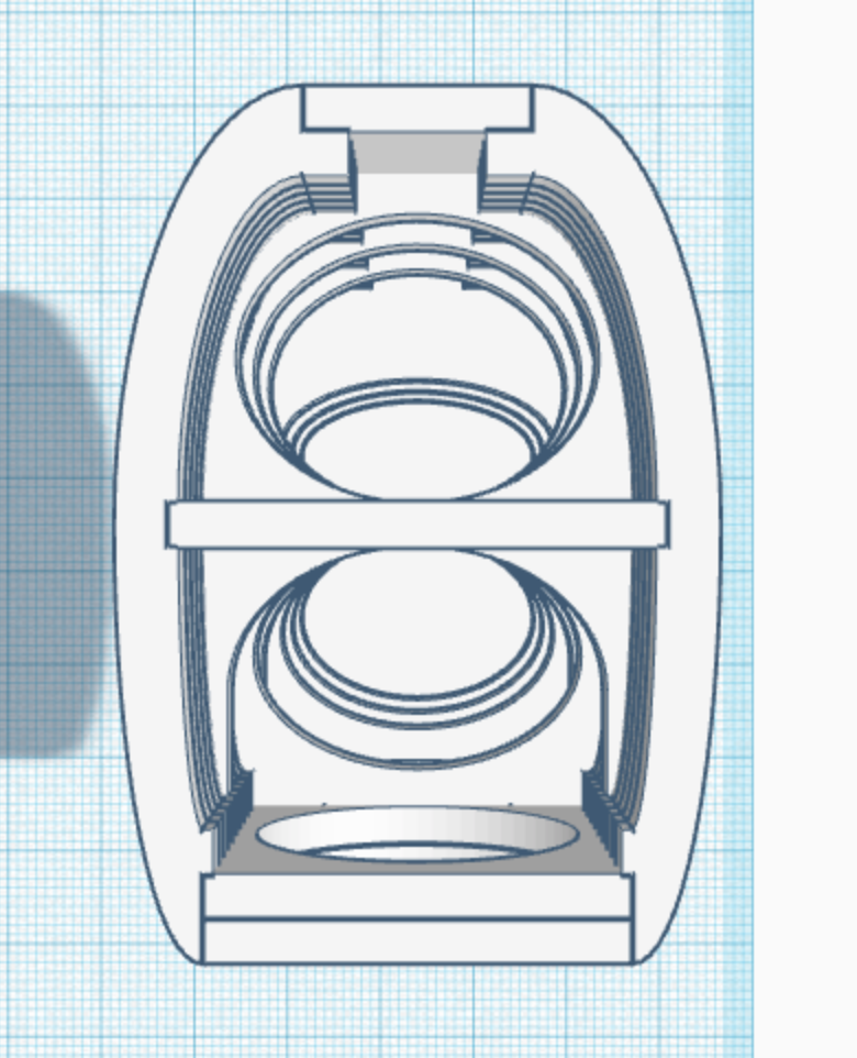

I made the baffles slightly wider to 24,5 cm so the entire woofer, including the mounting lips fit in the width of the baffle. This way the recessed edge around the mounting hole were the mounting lips of the woofer fall into can be done directly by CNC instead of having to do it by hand with a mill after everything has been put together. This makes it a lot simpler, I no more need advanced tools and perhaps the help of a woodworker which saves a lot of time and fuss.
Making the baffle slightly wider made the entire enclosure to become slightly wider. The width of the back of the enclosure on which the amplifiers will be mounted will would always be 13 cm. Because the difference in width between the widest point of the enclosure, in the middle, and the width of the back plate is now bigger, the diameter of the rounding has increased slightly, again slightly improving internal acoustics. The extra width also made for some more volume but because a bigger volume isn't necessary and there are limits to how big the volume should get (though it's nowhere near to getting too big yet) this left some space for some more wood. So, I increased the thickness of the side walls to 3,5 cm/1-1/3", again making the cabinet stronger, stiffer and heavier.
Also, this is kind of a coincidence with the dimensions, but one of the big braces now doubles as the top plate for the amplifier chamber. This again makes it simpler, saves two pieces of wood, and eventually makes the amplifier chamber in and the construction around it stronger and reduces the risk of leaks.
There now are horizontal braces every four layers/10 cm. And there is a vertical brace amongst the entire height of the cabinet with the edges around the holes in them against the horizontal braces, again reinforcing them. This skeleton in combination with the 5 cm thick baffle and 3,5 cm thick side walls will make for a extremely stiff cabinet.
