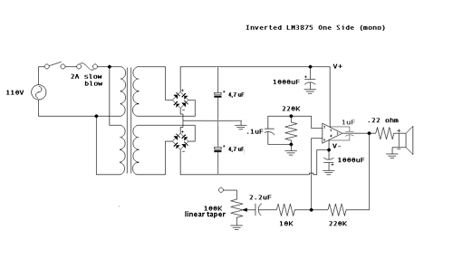

miguel2 said:I used BC caps I took off a broken tv set...
BTW, how many bridges do you guys use for the GC? Do you separate the channels with different bridges? I saw in other forum someone saying that the original power humpty has only one bridge.
Miguel
I use this schematic with two bridges per channel.
Jan

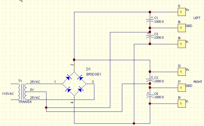

Today, I receive my 4 * MUR860 but I think I maked an error, I need 8 * MUR860 ????
I look at the data sheet, and a MUR860 is "only" a diode.
If it is that, I need 4 diode to make a positive with the AC, and 4 other diode to make the negative ???
If this isn't try, tell my how to make something with the MUR860 ??

arold19 said:Today, I receive my 4 * MUR860 but I think I maked an error, I need 8 * MUR860 ????
thank !!!
You need at least 8 diodes if you ar going to use one PS for both channels and your PS uses a one bridge per rail. You can still use only 4 diodes if you use single bridge and center tap of the transformer.
I don't understand what you mean by center tap ???
If I have 2* 25 Vac I use 25 V for the positive and 25 for the negative .....
what is the center tap ???? all transformer have that ???

Use 4 diodes. One end of one secondary at one point and one end of the other secondary on the other point of the diode bridge. Then connect the unconnect secondaries to the ground point.

Here it is. The 1000uF should be connected directly to the pins of the IC.
