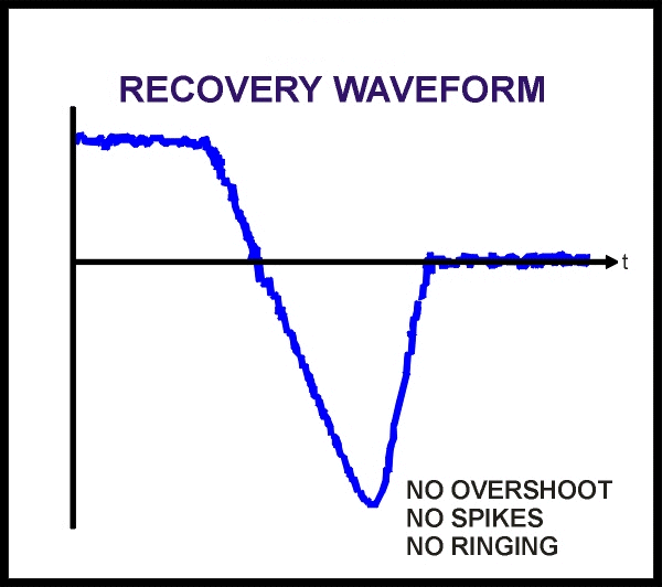

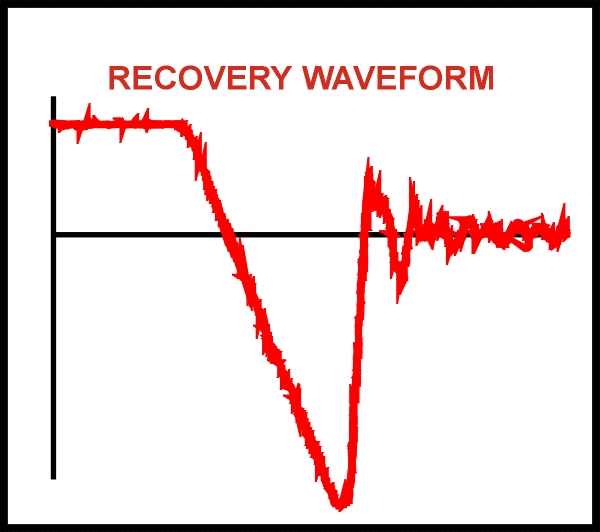

From Elliot's site:
"There is currently a trend towards using fast recovery diodes in power supplies, since these supposedly "sound better". This is basically a bad idea, and there is absolutely no requirement for them.
The purpose of a fast recovery (or any other fast diode) is to be able to switch off quickly when the voltage across the diode is reversed.
All diodes will tend to remain in a conducting state for a brief period when they are suddenly reverse biased.
This is extremely important for switched supplies, since they operate at high frequency, and have a squarewave input.
Standard diodes will fail in seconds with the reverse current, since it causes a huge power loss in the diode. "
What you need is soft recovery diodes, not a fast switching diode per se.
So, you start looking for soft recovery types and you find these are fast types as well.
All very logical if you know what they're uses are in industrial
applications.
"At 50 or 60Hz, and with a sinewave input, the slowest diodes in the universe are still faster than they need to be."
Absolutely true...
"Indeed, Nelson Pass suggests that even the standard diodes should be slowed down with paralleled capacitors."
Here's the wording: "slowed down".
You can't slow down a diode switching at 50/60 Hz.
What it should say is that the spikes need to be snubbed to mimick a soft behaviour on the rails.
As is explained below:
"This can be an excellent idea, as it reduces the radiated harmonics from the diode switching. Typically, 100nF capacitors (optionally with a small series resistance) are wired in parallel with each diode in the bridge, and this is quite common with some high end equipment and test gear where minimum noise
is essential."
All very well but you'll need a scope to see how effective your network actually is.
From the above it's easy enough to see the arguement in favour of the ordinary diodes but... Isn't it better to keep the rubbish out in the first place? (RFI/EMI).
I'd like to think so...
It's also true that while these fast, ultra fast and whatever special diodes, are much better behaved, they'd still benefit from a snubber network.
Oh, BTW, Schottky diodes work in a completely different way than regular diodes.
If you find them specced for what you need, I'd go for those any time.

fdegrove said:The reason these special diodes are chosen for audio is their soft recovery characteristic, not because they're fast switching.
Reading thru this thread i wondered when someone would point this out... important, so i will repeat. It is the soft-recovery that is important, what we want to get rid of is the reverse spike when the diode switches off.
dave
planet10 said:It is the soft-recovery that is important, what we want to get rid of is the reverse spike when the diode switches off.
dave
just wanted to give you some perspective: the reverse spike for a gbu8 is about 5ua at room temperature and 500ua at 125 dgrees?
Guesss what the reverse spike is for mur860?
how about 10ua at room temperature and 500ua at 125 dgrees.
slightly worse than the lowly gbu8.

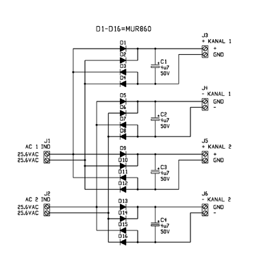

I use MUR860 diodes in my bridges. When I put 100nF film caps across each diode the sound became much better. I guess that snubbers are quite important here.
I am planning to do a simple AC filter (with a toroidal core and some caps) and also experiment 100nF caps (film/ceramic/MLCC?) from the outputs of the tx to ground.
Miguel
Miguel
miguel2
Which brand/type of 0,1uf filmcaps did you use for this, Miguel?
I bypassed my 1000uF's like on the below pic - with Elna Starget 4,7uf caps.
Should I try both, or are my 4,7uf's doing the same job as your 0,1uf's on each diode...?
/Jan
