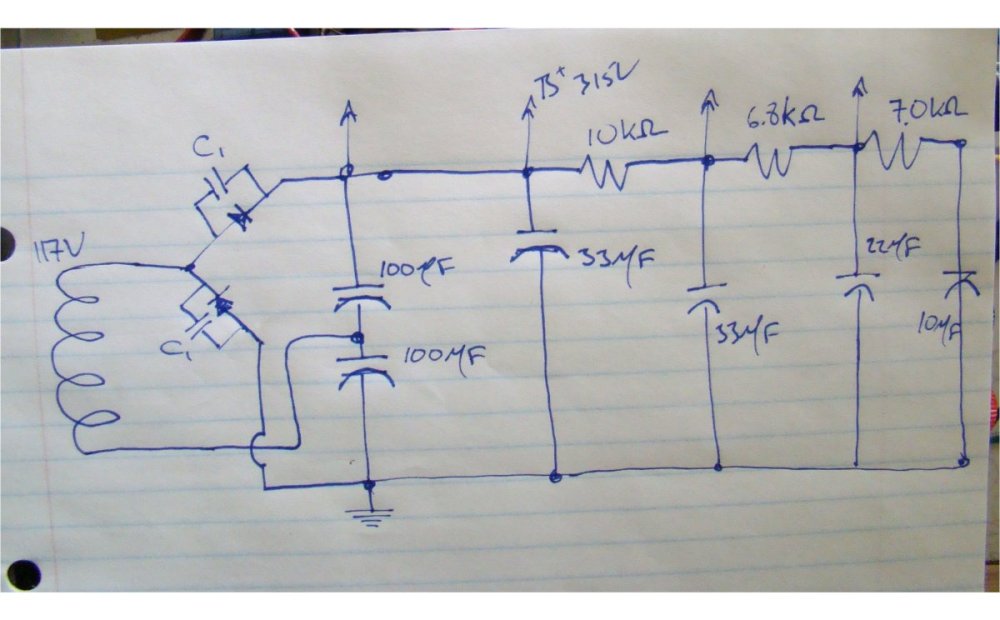

I picked up a so-so, incomplete DIY amp a little while ago that somebody else made. It's ugly, real ugly--what I'm using it for, more than anything else, is a good source of spare parts 🙂
Anyway, I have traced the circuit to discover that the rectifier on the existing circuit is as illustrated in the attachment. Frankly, I'm stumped as to how it manages to work...
That is, with the two diodes wired in as they are, it would seem that this should only be a half-wave rectifier, but it's clearly not since the B+ voltage is 315V (measured). And what are the capacitors I've labelled C1 (with .01M Z5U printed on them) supposed to be doing?
I'm OK with how the B+ supplies work, I'm just a bit confused as to why this rectifier is configured the way it is, and how it manages to work. Any insight would be greatly appreciated!
(As you may have guessed, I'm not an electrical engineer 🙂 )
Many thanks in advance.

This is a half wave voltage doubler. The lower 100uF capacitor is charged to the peak winding voltage by the lower diode on the first half of the sine wave. The upper capacitor is also charged to the peak winding voltage but this time by the upper diode on the second half of the sine wave. The output voltage is the sum of the two capacitor voltages and double the transformer voltage.
This kind of design has poor ripple (60Hz instead of 120HZ like a full wave bridge) and poor output regulation (double the winding Ohms and double the capacitor droop).
Ah, I see--so it's the C1 and 100uF caps that are causing the B+ voltage to get to where it is, and the design itself that is causing some the problems I've already discovered on this unit (the poor output regulation was immediately obvious).
Thanks! 🙂
SpreadSpectrum is correct. That topology is known as a full wave voltage doubler. Some justification for the name exists. The ripple freq. is 2X that of the AC mains and both halves of the sine wave are used.
Properly executed, "full wave" doubler B+ PSUs are quite good. Some of the best units ever made employ the topology. The H/K Cit. 2, Marantz 8B, and Fisher 500C are examples.
LARGE caps. are appropriate in the doubler stack. Large 1st filter caps. imply a small conduction angle and a good deal of ripple overtone energy. Follow the doubler stack with a low DCR inductance and more capacitance. Think "extended" CLC filter. A H/K Cit. 2 overhauled ala Jim McShane kicks serious butt. Jim replaces the OEM doubler caps. with low ESR 820 muF. Panasonic 'lytics. The rest of the B+ PSU is beefed up too.
FWIW, we used something quite similar, at a lower current, in "El Cheapo" and (unsurprisingly) obtained highly satisfactory performance.
TANSTAAFL applies and the available DC current is approx. 1/4 the AC RMS current of the rectifier winding.
Yeah, a google search revealed that I have a full-wave doubler here, not a half wave, but that's OK.
However, the poor voltage regulation is a very real thing--I worked out the transfer function for the whole thing, and compared the actual (measured) results with the computed ones (assuming a true DC input signal) to find some reasonably large discrepancies. This is now easily explained by both the 100 Hz ripple current (2x AC mains frequency) and the undersized caps. The two factors combined effectively mean that the filtering is less than what it needs to be.

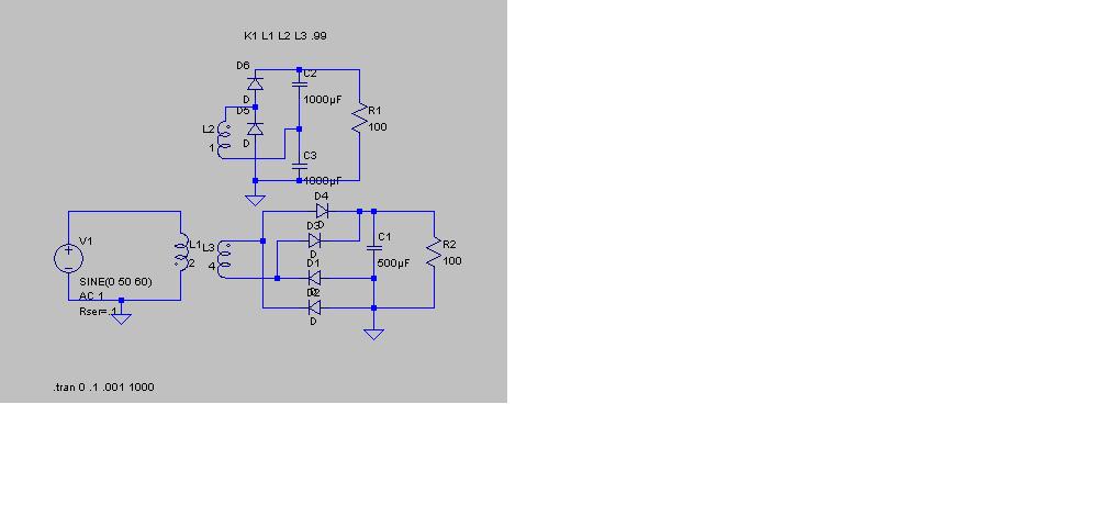

Tom, I guess you lost me.
For the non center tapped case, a full wave bridge has 1/2 the transformer current of the voltage doubler but needs 2 times the number of turns, For the same wire gauge I^2R comes out the same for both cases, same heat same voltage.
Why this changes if you add a center tap escapes me unless you discard the minus voltage and ground the center tap, but that isn't an apples and apples comparison. Did you find the proverbial free lunch?
L3 has 4 times the inductance of L2 (so twice the number of turns)
V R1 = V R2
Ripple is the same for both.
I L2 = twice I L3 (I assumed 99% coupling coefficient).

Comparing the doubler to full wave bridge... if you unwind half the secondary you have half the resistance... but you also have room to wind on more wire, which you could connect in parallel to get 1/4 the resistance.
Let's say we have three transformers, all with the same amount of copper in them. First is 120V, 2.5 Ohms. Second is 240V, 10 Ohms. Third is 480VCT, 20 Ohms per half. The first two will perform almost exactly alike, using a doubler and FWB, respectively. The third with FWCT will lag behind, since the two halves carry current alternately, not continuously. So only half of the secondary is carrying the output current at any instant. You'll need 40% more copper in the secondary to provide the same output as the other two. Of course, FWCT is the only reasonable choice with tube rectifiers...
