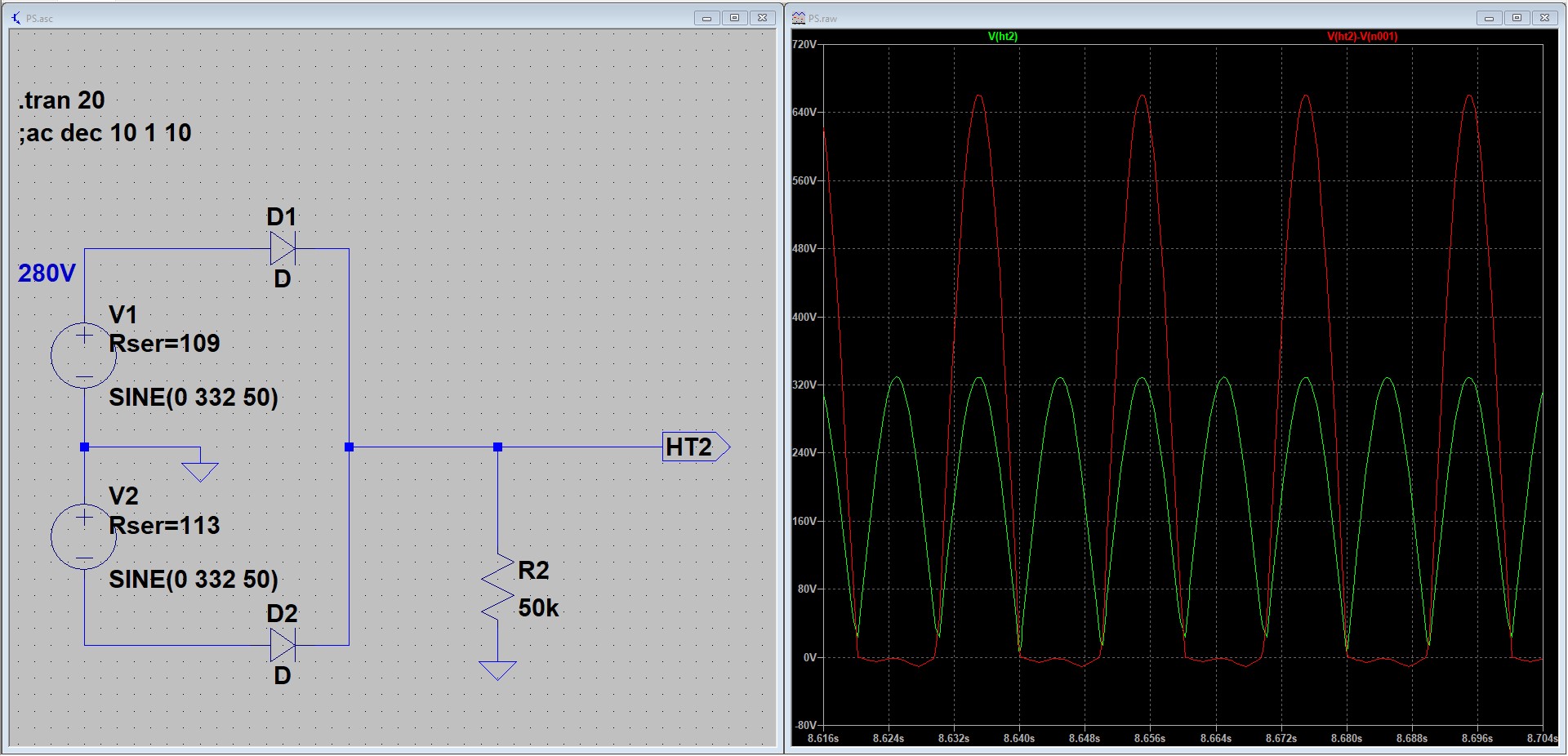

Thinking about a way to put it gently, I am under the impression that with fast/soft recovery diodes there is no issue to solve because HF spikes are well damped by the secondary copper resistance in traditional EI core transformers. Otoh it might be of concern with low dcr toriods and 1N4007 but only in combination with other factors like routing, circuit sensitivity and others.
Right.
Check out the red plot.
