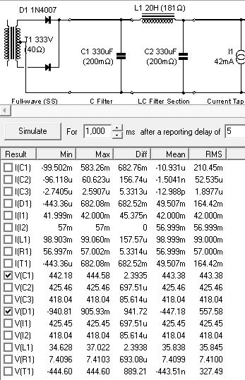

There are always beefier parts. I learnt the importance of reverse voltage with this supply using CSD01060A which have a rating of 600v. I looked at my PSUD sim and seen 450v at the first filter cap and though it good to go. Wrong, turns out the difference across the diode can be over 900volts.
I can tell you from experience the 600v parts last about 2-3 minutes before failing and blowing the fuse. The transformers make some real angry noises when that happens...

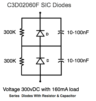

Does this look like it would work? Not sure of the wattage of the resistors or the voltage rating of the caps.
Looks very good to me. Simply wiring high PIV Schottky diodes in series is known to be unsatisfactory, with cascading failures occurring. You have voltage equalizing resistors that protect both the Schottky diodes and the filter capacitors.
As for the power rating of those resistors, 1 of the established formulas should help.
P = V2/R
Definitely allow for lots of "fudge" in both the WVDC and power departments.
That will work fine. Increase the number of series parts sets if you use this idea on higher voltages. I have a board that used a dozen 1N5408's for 1100 VDC output.
The caps AND resistors should be rated for more than the expected DC output voltage. They will see about 2 X the output voltage during reverse bias, but it will be split between the two series parts sets. Resistors DO have a voltage rating, and I have created some serious fireballs by ignoring it.
The resistors will probably need to be 1 watt or larger to find parts rated for the necessary voltage. I have seen 1 watt parts rated from 200 volts to 700 volts.

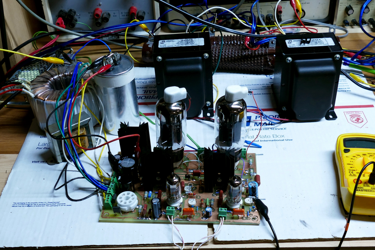

I have a 20+ WPC single ended vacuum tube stereo amp running from an Antek 360 VAC (wired for 720 VCT) toroidal power transformer. Attempts to use a vacuum tube rectifier at the power levels seen in this amp were met with sparks and dead tubes. The usual silicon diode in series with the plates and CL140 inrush limiters did not help.
I removed the UF4007 series diodes that were in series with the plates and installed the IXYS DSA1-18D diodes in their place. I saw sparks inside another 5U4, so I simply removed the rectifier tube and jumpered across it.
This leaves only the pair of IXYS diodes as the sole rectifier. This amp uses one large TV sweep tube per channel and I have operated them as high as 150 mA per tube on 470 volts. I finally settled on 120 mA which results in a B+ of 480 volts at the output tubes with a B+ current of about 250 mA.
These little diodes have proved reliable in that amp which has seen about 200 hours of use over the past 6 months. The B+ is well over the 500 volt rating on the filter caps at power on, so I have not tried to go higher.
I do have a 400 VAC power transformer that I will try with external filter caps when I have the inclination to remove the 500 volt caps from the board.....for now I would rather just listen to this one while I make another board.
These diodes should be fine for 300 VDC....their only drawback is the cost, about $3 each. Not a big deal when you only use two.

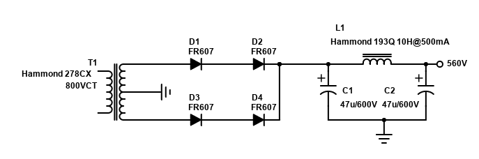

Such a series connection without balancing resistors works fine if the reverse leakage current of the two diodes in series are equal over the entire operating temperature range. If leakage current of one diode is e.g. 10 times smaller than the other one, reverse voltages will be completely different - if we assume a linear relationship between leakage current and reverse voltage, one diode (ironically the better one) will see 90 % of the reverse voltage while the other one will only see 10% (as the current must be identical). This combination would be completely useless. Therefore a good design beeing tolerant for such mismatches uses balancing resistors. These must be designed in a way that the additional'leakage' current they will add is significantly (~10 times) higher than the max. leakage current of the diodes. If the additional current is be smaller than the leakage, the resistors would have almost no effect for voltage balancing.
