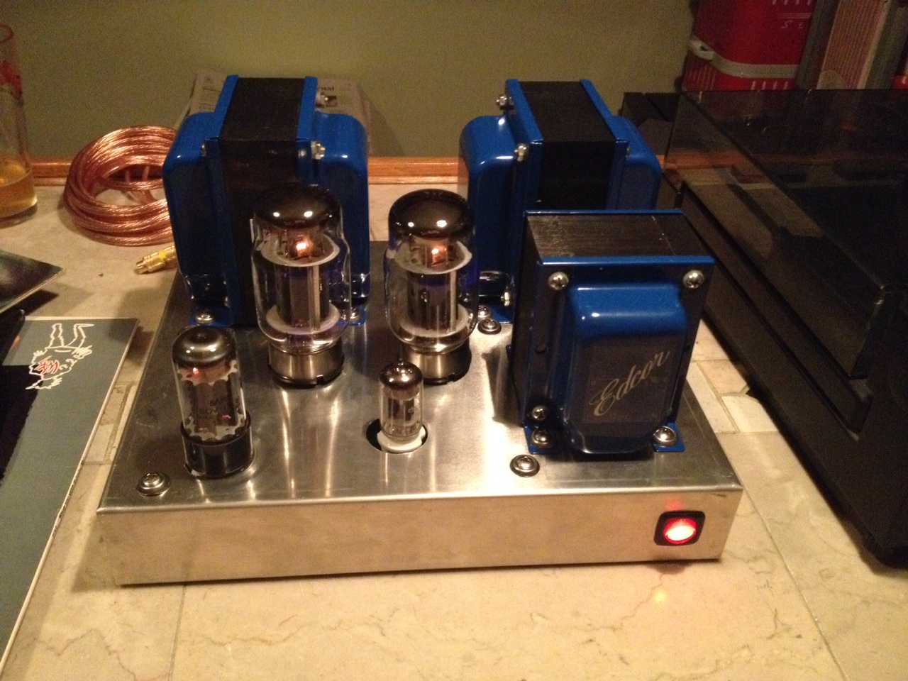

I have been enjoying my SEE since power up last march however, I am getting the DIY bug again and this time I think I want to build some speakers for my SSE. I am running my SSE with the big edcor OPTs and EH KT88s. I brought the amp over to a friends house the other day and listened to it on a pair of vintage Klipsch Chorus speakers (101db sensitivity) and WOW! The sound was amazing with more volume then we could handle. The SSE in UL mode using SS rectification had no issue moving the big 15 inch woofers. Even in triode with tube rectification the sound was amazing and crazy loud.
Don't get me wrong my amp sounds great on my paradigm monitor 7's but this was something else.
So long story short is anyone aware of a set of high efficiency DIY speaker plans? I am looking for something 98db+
Thanks in advance!
I have attached a pic of my completed build in case anyone was interested...
