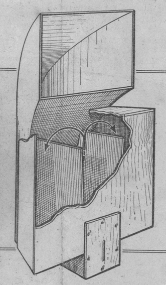

Further research has led to my finding an article in Wireless World-[issue of 28 December , 1934, p.561- entitled ‘Voigt Domestic Loud Speaker- Construction and Performance of the Latest Corner Cabinet Type Horn’]
The article is anonymous but I surmise that it was written by Voigt himself. It contains a photo of the exterior of the cabinet and a cutaway side view diagram. Most importantly, there is a photo of the INTERIOR with Front Panels removed. This shows alternative sound paths.
I believe that this article, and especially the photo, would be of use to anyone constructing the speaker or the simplified Home Constructor’s version, and would suggest that constructors obtain a photocopy.
I have also found a photo of the finished Home Constructor's Horn, but it is not as useful as the photo in the 28 December 1934 issue (abovementioned). It shows only the front exterior. The front exterior photo is inside the back cover in the 7 June 1935 issue. "

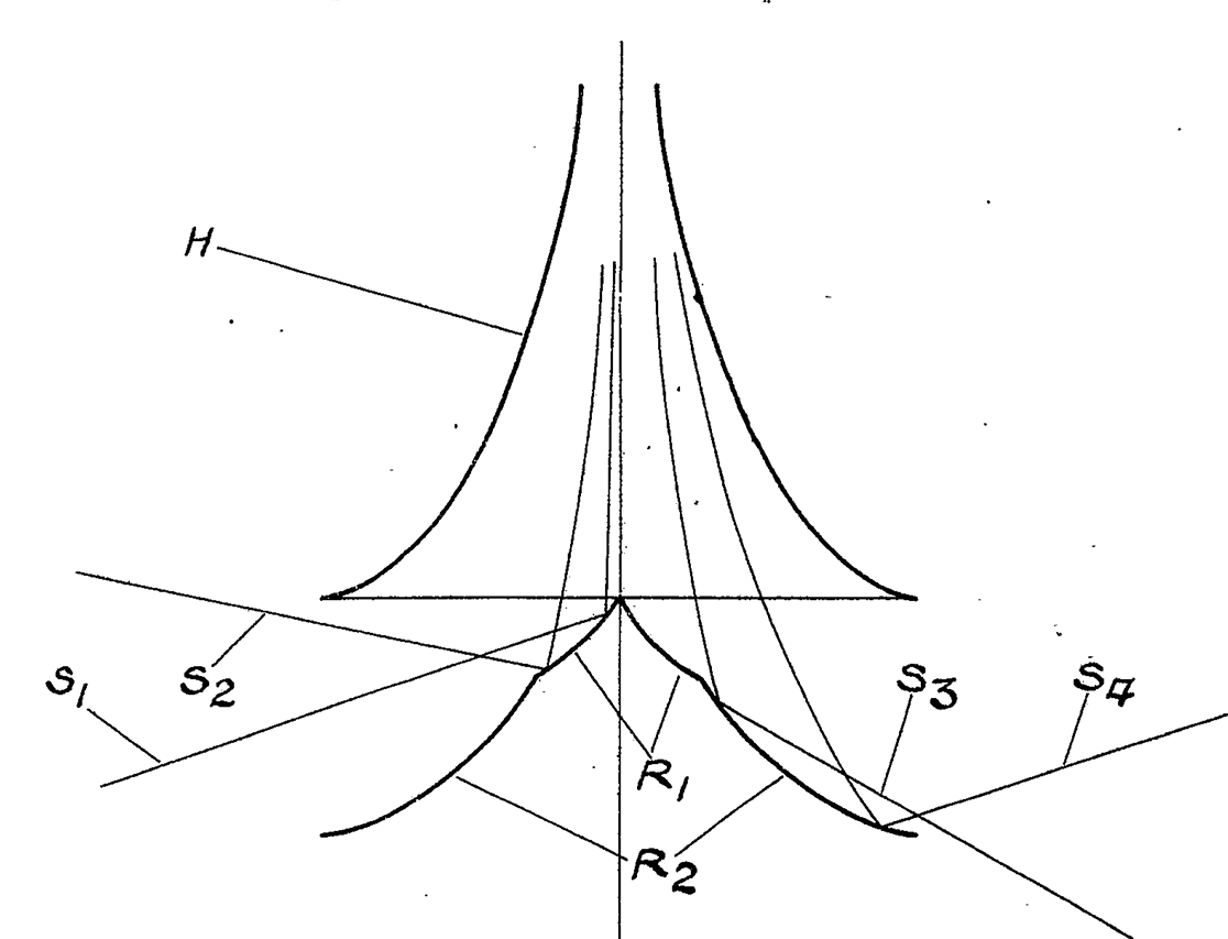

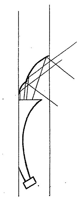

I just had some time to read the Voigt patent for the reflector used in the big Domestic Cornerhorn. The diagram below shows what he very clearly describes as a horn pointing down, with a reflector placed below it. As in, the reflector is separate from the horn. Bruce Edgar wrote it as Voigt´s own words in the quasi interview, but this is directly from Voigt himself. I thought that was good to add.
I suspect that the drawing in the patent is to scale and can be a decent basis for deducing relevant sizes and curves from. I have seen some pictures of a home constructor´s cornerhorn with a similar reflector added, Which is not a bad idea. Something for the list of things to sort out perhaps.

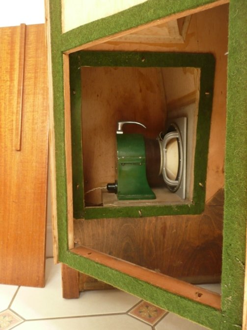

So far I haven't been able to find a photograph of a driver in situ in a home constructor's corner horn. One or two from what I suspect is a PW1 corner horn, but no clear reference points. Another one or two from what looks like homebrew and adapted to a different, non-Voigt/Lowther drive unit.
And then I found the image below, of a Voigt domestic corner horn with a Lowther PM1 drive unit. As far as I understand, the early 6 inch Lowther drive units were backwards compatible with the Voigt corner horns, and I assume this means they had the same outer dimensions.
What is noteworthy to see, is that the driver is sitting on the lower panel of that chamber/start of the line. The square frame at the front of the driver is also sitting on that panel. I guess the weight of the assembly requires that sort of supporting frame and requires that frame to sit on a surface. I conclude that the driver in the Voigt home constructor's corner horn probably also sat... Well...
The horn itself is all on the front side of the driver, the bass chamber is an afterthought. So there is no bottom panel underneath the driver, I think. So to determine the length of the flat stretch of baffle, I will use the height of the square driver frame: 7.5 inches.
