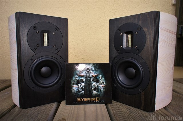

I've built Dennis Murphy's ER18MTM and Paul Carmody's Speedster myself.
Also heard some speakers from Troels. They were all really good, but if I had to choose between the ER18MTM and the Italian Stallion, I would clearly prefer the Italian stallion.

I wonder, which was the best you've heard ever?I've built Dennis Murphy's ER18MTM and Paul Carmody's Speedster myself.

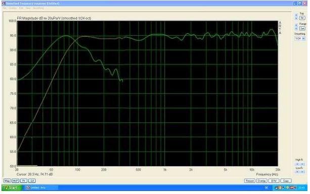

First of all, so many of the DIY/kit designs I've looked at have F3 that's on par with a competent (not too compact) bookshelf but in a much larger case for no apparent benefit. But even if the speaker can play base with authority, you still can't locate it separately.
I'm leaning towards a more compact 3-way that can play down to, say, 50-60 Hz flat, preferably in a sealed box (large bookshelf or a thin and tall floorstander, possibly with 5.25" or even 4.5" midwoofers for narrower baffle) + a sub, located strategically so that the MLP is not in a null.

A booming room at standard levels tends to be perceived as loud and a bit unpleasant leading to a tendency to want to turn the volume down a bit. A non-booming room tends to sound clean and detailed at standard levels leading to a need to be careful not to turn the volume up too high. Headphones can be similar in being able to play loud cleanly creating an increased risk of hearing damage by overdoing it.
If you reduce the boom in the room by, for example, placing a subwoofer against the wall behind you, inverted and delayed by the time of flight from the mains and with the level set to absorb a large proportion of the sound from the mains then the level of the low frequency sound perceived will drop substantially. It will sound drier/cleaner/tighter but the level will be significantly reduced. This is what sets the minimum woofer size in the mains to something like 10-12" or more likely these days 2 x 8" in non-booming rooms and why people with booming rooms are often happy enough in terms of level with a single 6" midwoofer.
If your main speakers can deliver sufficient clean SPL down to 35 Hz or so then you have two of your distributed subwoofers. They may not be ideally located in terms of position but they will almost certainly reduce the number of subwoofers required to create an even response below 80 Hz or so for which distributing sources and sinks is a valid approach.
If you are interested in loud below the first room resonance then all you need is adequate cone area because at the lowest frequencies the sound pressure in the room is rising and falling pretty much together throughout the room removing the requirement for the subwoofers to be distributed. Sticking whatever extra cone area is needed to get to 20 Hz or below in a single large sub in a corner will do it. Sealing the room is likely to help as well.
If you are concerned only with one point things can become much simpler. You can place the sub very close to your listening position but always make sure you aren't close to a wall.+ a sub, located strategically so that the MLP is not in a null.
Very likely. I like open baffle bass too which I find helps, also I find the "pressurisation" of sealed subs uncomfortable on my ears.I suspect this is because many have become so accustomed to listening in booming rooms at less than standard levels they have lost an appreciation of high quality low frequency reproduction. This is speculation though and I freely admit to sometimes being baffled by what some consider high quality sound reproduction.
I don't understand the idea behind this exercise. If you just want to get rid of the booming base frequencies, wouldn't high-passing the main speakers achieve the same in a simpler and cleaner way?If you reduce the boom in the room by, for example, placing a subwoofer against the wall behind you, inverted and delayed by the time of flight from the mains and with the level set to absorb a large proportion of the sound from the mains then the level of the low frequency sound perceived will drop substantially. It will sound drier/cleaner/tighter but the level will be significantly reduced.

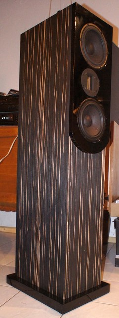

That is not so easy to answer because there is no such thing as one loudspeaker that can do everything better than all the others.
But of course there are a few favorites that hardly have any weaknesses. I include the Mona Kea:
Mona Kea – 4 Wege Referenzlautsprecher – Donhighend Audio
The H.A.V.O.F.A.S.T. (yes, 2-Way!):
H.A.V.O.F.A.S.T. Studio-H.A.V.O.F.A.S.T. Stu
And also a fairly expensive, active 3-way project, which is not documented.
If you want to hear extremely loud, something like the KO would certainly be "better" than the above:
Knock-Out-Knock-Out
If you have a relatively bare room with little furniture and hard floors, something like the HAVOFAST certainly works better than an ordinary, very good 3-way loudspeaker.
There have also been a few listeners who have heard the Mona Kea and Italian Stallion and then decided on the IS because it only costs 25% of the MK and is still very close.
Many also make the mistake of only looking at the bass data. A low F3 is not a guarantee for good bass. Because the room determines the result in the bass. Closed loudspeakers usually do not have a particularly low F3 and still often work much better in the room than bass reflex speakers with a very low F3.
One more thing about 3-way vs. 2-way:
The effort for the crossover is about twice as high for a 3-way speaker as for a 2-way speaker. In addition, the lower x-over frequency requires larger and therefore more expensive components. And an additional driver also has to be paid for. This is why 3-way speakers are about twice as expensive as 2-way speakers, even if such general statements should always be treated with caution.
But there are also exceptions, such as the 3-65, where, despite high-quality equipment, only 65 € for the driver per box are due.
Three-Sixtyfive – 3 Wege TQWT mit Dome-MT – Donhighend Audio
Only when you want to hear very loudly does the 3-65 reach its limit at some point. Otherwise it plays in much higher classes than the price would suggest.
