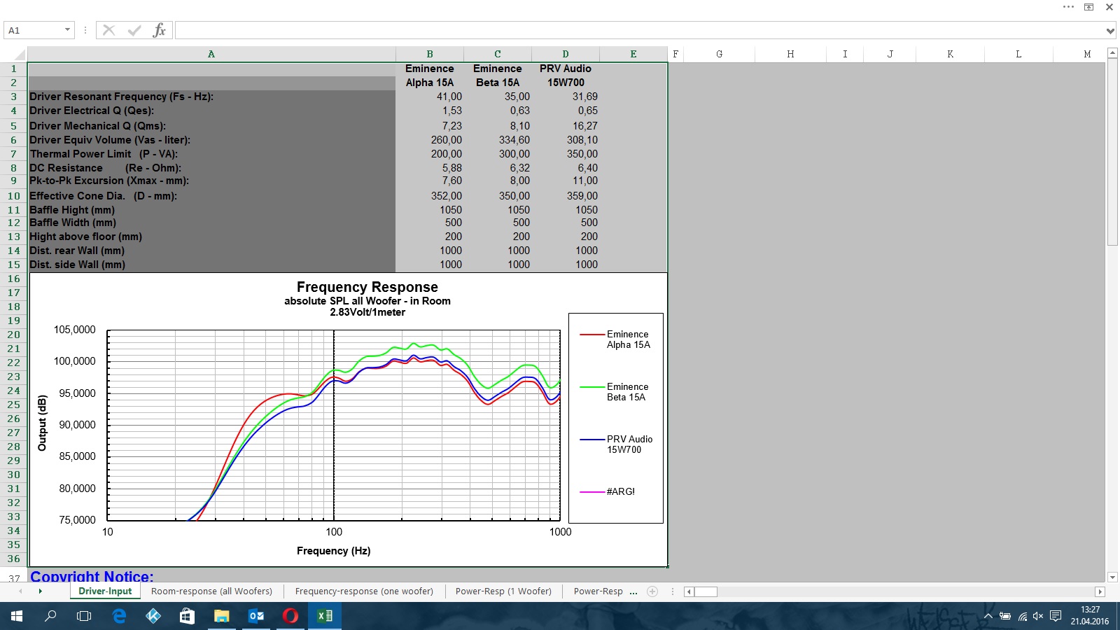

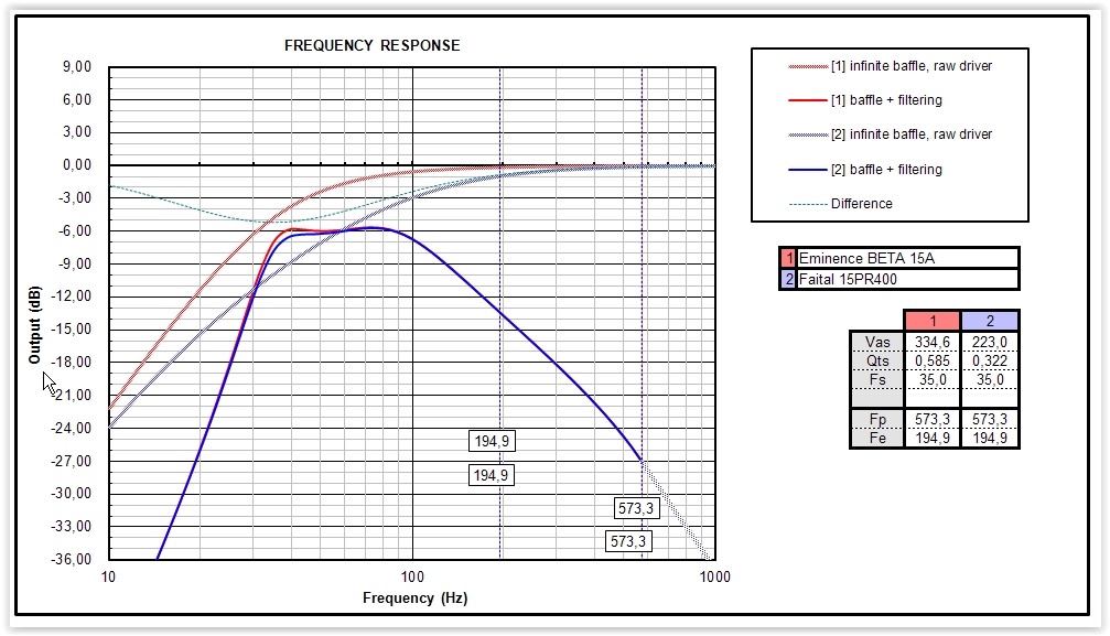

yep ! you can mix beta /alpha if you need go up ...This is plot which I generated using XIBaffle.xls
link for XIBaffle.xls ? please?

Link for XIBaffle spreadsheet:http://p10hifi.net/TLS/downloads/Xlbaffle.xls.zip

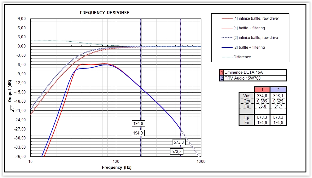

I used spreadsheet from Zoran (Thx🙂 and I put into datas for PRV and Faital. In summary I'm a bit confused because plot results is different than my 🙁
I comparison Beta vs PRV - PRV go lower but have less SPL, right?

Intresting spreadsheet. The 3015LF models quite well, more of less in line with my experience
