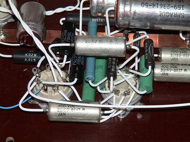

Just because Williamson used 20dBs of feedback you don't have to. The one I have (one of my many un-finished projects) sounds good to me. If sounds fine without any feedback also - and then it's sensitive enough for tape head signals (about 0.5mVrms) 😉
Can an amp have too many 6SN7s? 😀
