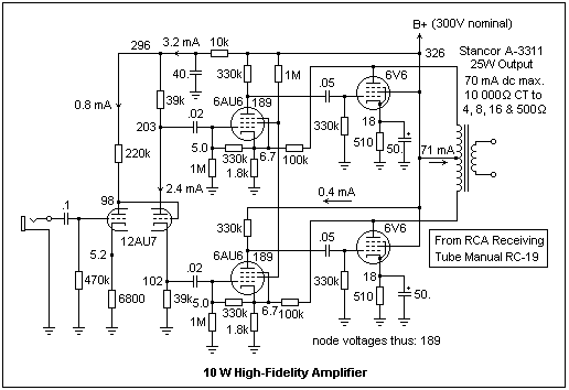

I just finished this old RCA design. Exchanged the 12au7 at the front for the Russian 6n16b (cathode resistor 4K7). Used a mosfet regulator.
Sounds incredibly good with a 60 year old OPT..
I believe you can use the EL84 instead of the 6V6 if you want.

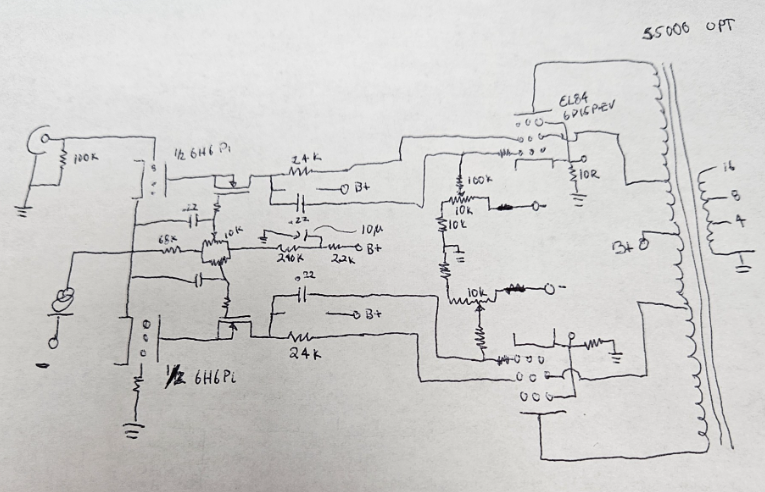

I took this sort of thing on recently. Used for my build Sherwood S5000 OPT's. They have 28% U-L. I used 6P15P-EV finals. Power supply is a 300V plus heaters SMPS from Ali that I got for about $35 delivered. Schematic is below. Mostly complete... 🙂
Douglas
I made this, it seems to be good

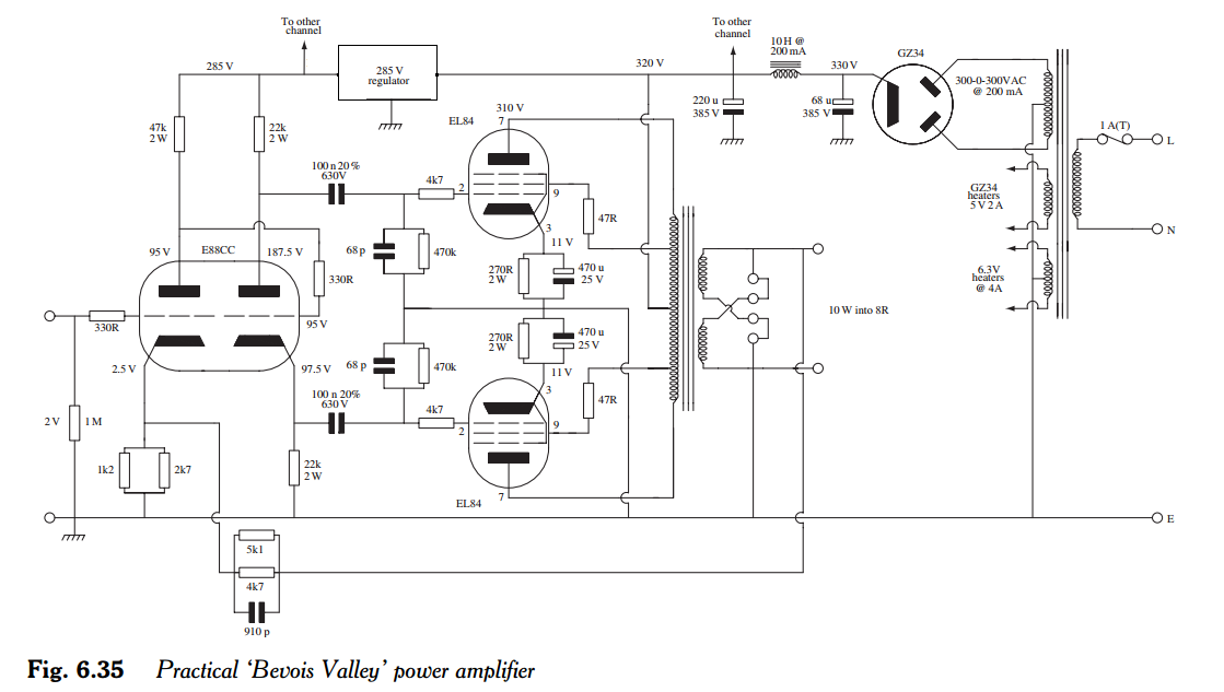

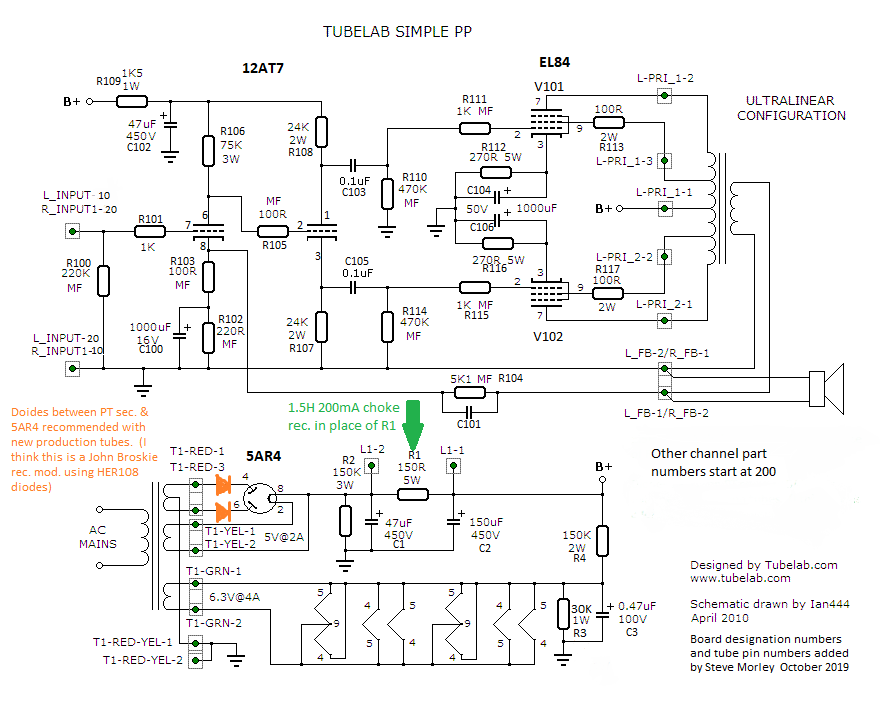

I have a question about the input valve for an EL84 PP amp in UL mode. I want to use a voltage stage coupled to a concertina, like the Bevois Valley or Tubelab circuits. The Bevois uses an E88CC, the Tubelab a 12AT7. Gains of 33 and 60 respectively. I've considered using a 6SN7 with gain of 20. A better valve in itself than the other two. But how would the GNF loop work with a valve of lesser gain?
What would be the pros and cons of using a 6SN7 in the first stage?
