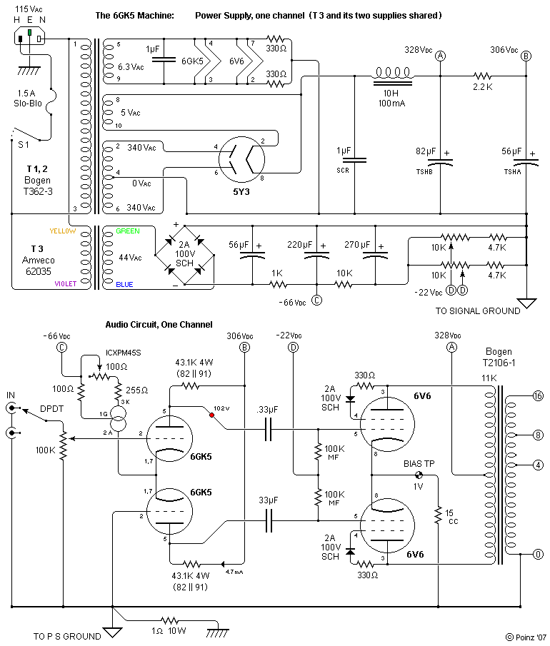

I just finished this old RCA design. Exchanged the 12au7 at the front for the Russian 6n16b (cathode resistor 4K7). Used a mosfet regulator.
Sounds incredibly good with a 60 year old OPT..
I believe you can use the EL84 instead of the 6V6 if you want.

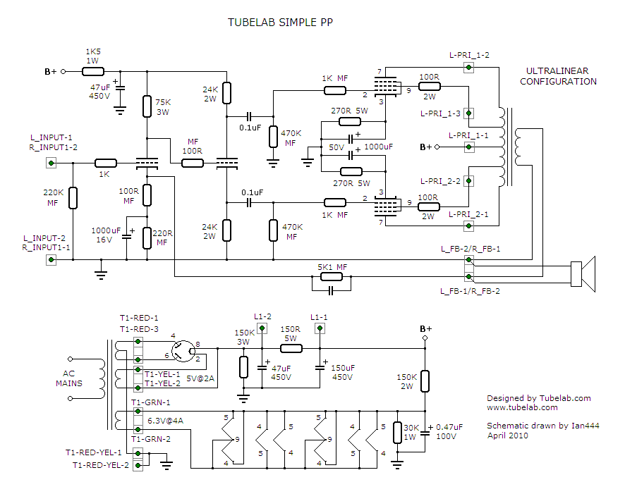

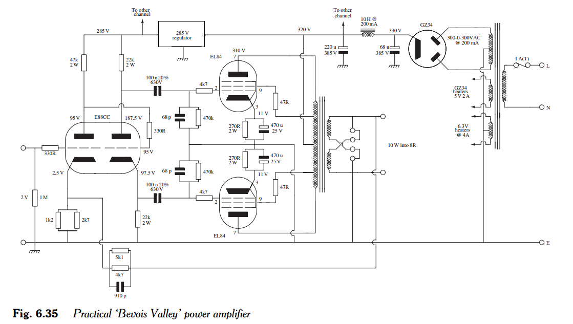

I'm rebuilding a Leak Stereo 20 and wondering which circuit to choose. I'm most tempted by a concertina first stage like Tubelab and Bevois Valley. See post #20. I don't really want to add a negative voltage source for a LTP.

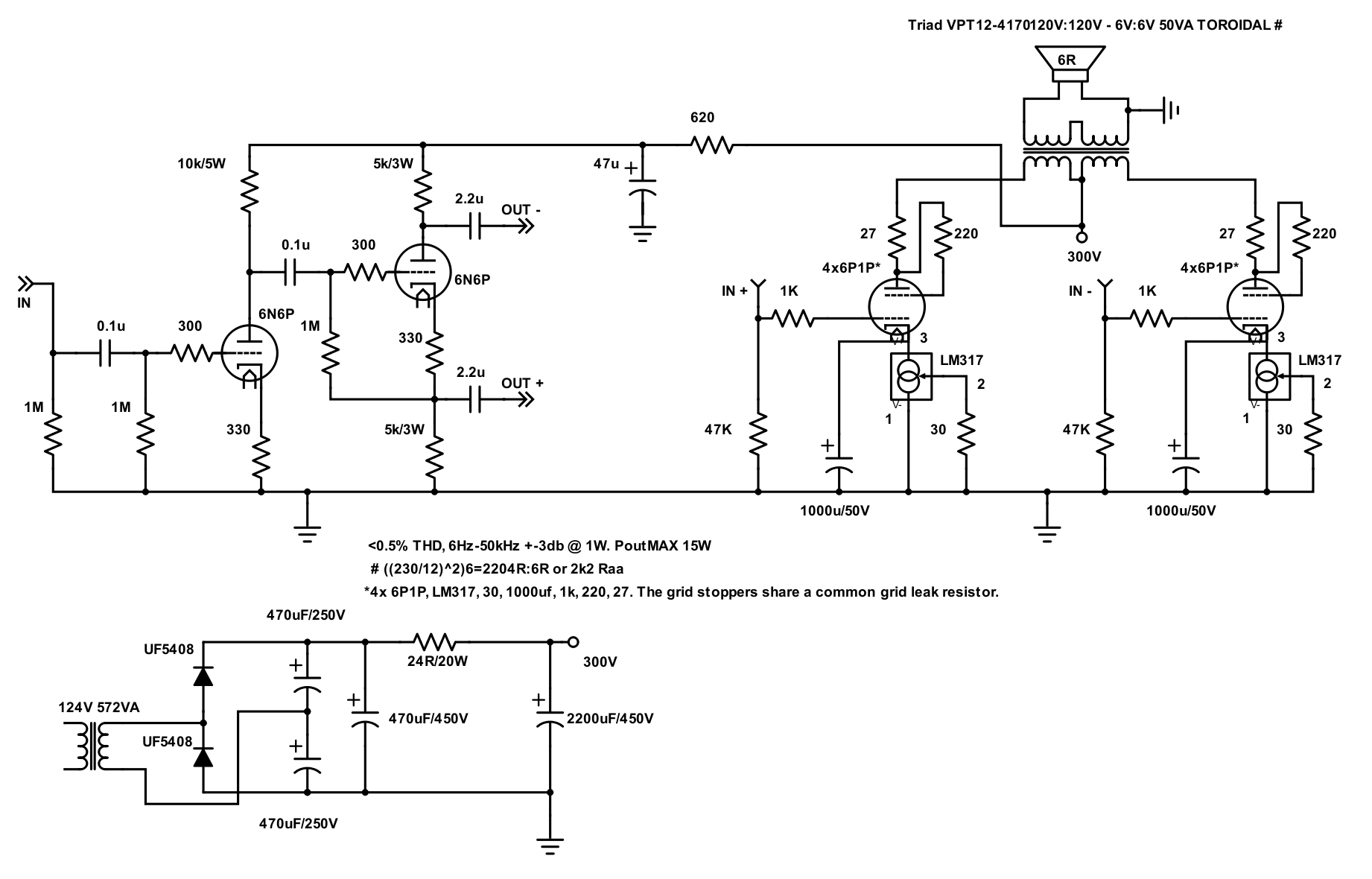

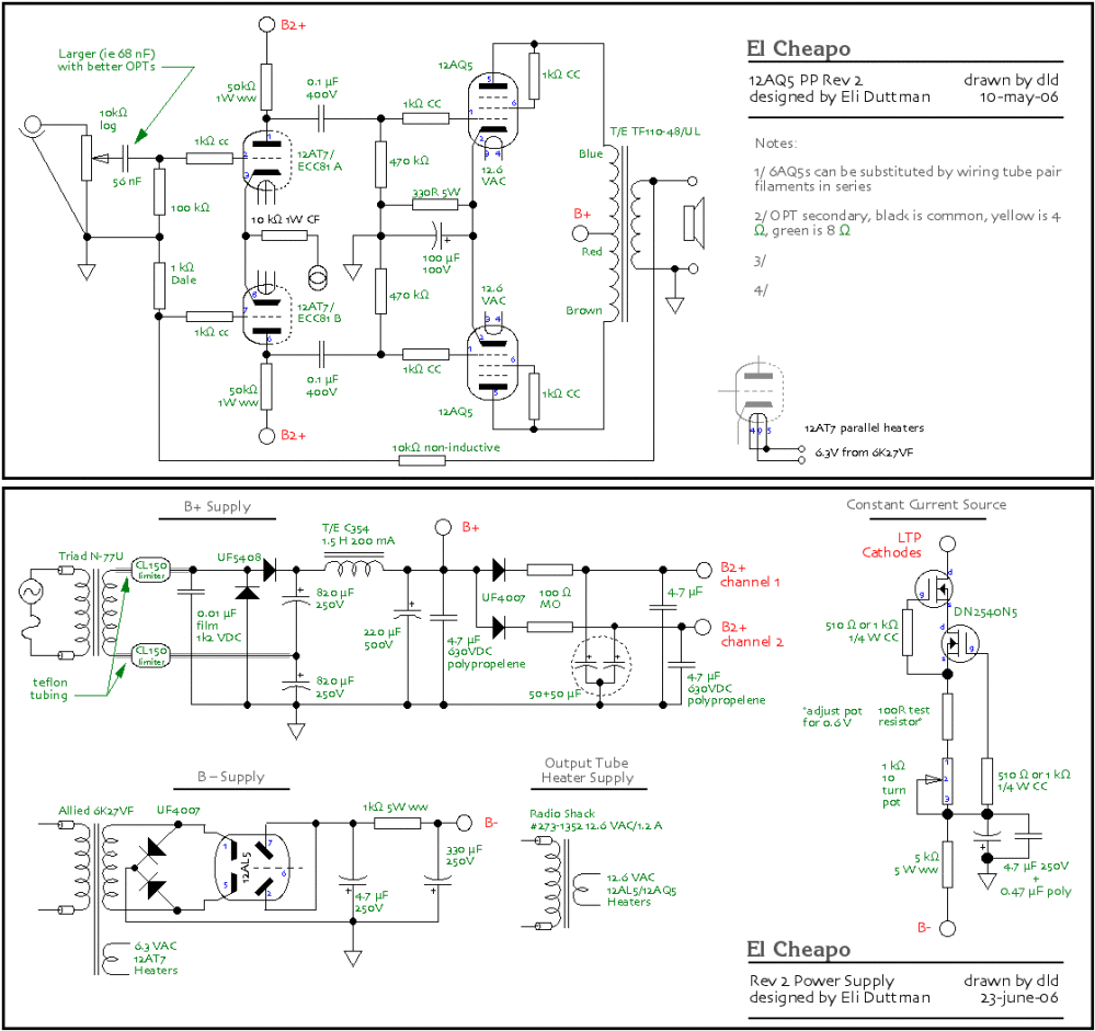

I took this sort of thing on recently. Used for my build Sherwood S5000 OPT's. They have 28% U-L. I used 6P15P-EV finals. Power supply is a 300V plus heaters SMPS from Ali that I got for about $35 delivered. Schematic is below. Mostly complete... 🙂
Douglas
I made this, it seems to be good
