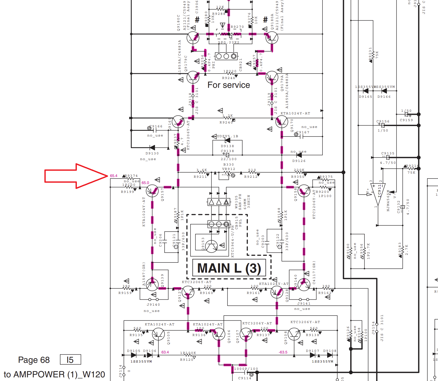

Yamaha MX-A5000 with 180W devices - rated at 170W 6R , 290W single channel driven. Single pair, 11 channels, supplied with 2x72VDC.
Denon PMA amplifiers with single pair of mosfets TO3P - 2x61VDC at PSU.

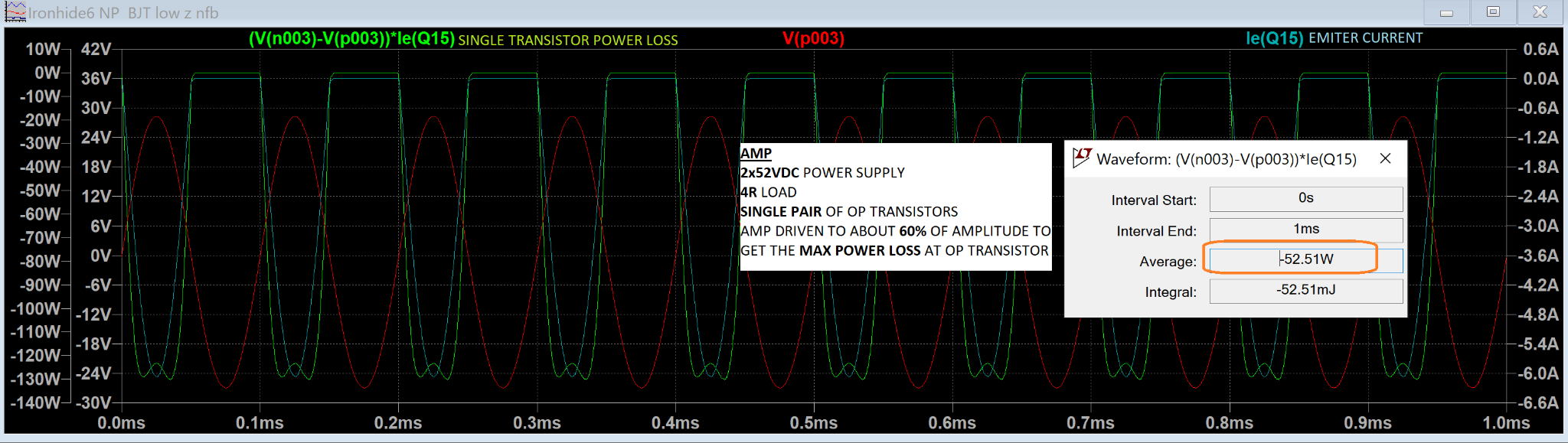

Bellow, example of power loss of single pair OPS supplied with 2x52VDC, load 4R, about 60% of output amplitude.

100 actual watts per pair. 84 volt rails gives 250 at 8, 400 ish at 4, and 600 watts at 2 ohms on a practical power supply. Six pairs of 2N6259, MJ15024 or 21194. At “8 ohms”, it’s only 42 watts per pair, but makes a 2 ohm capable amp.
Average dissipation is only vcc^2/(10*RL) — at 60% power — but the peaks are at Vcc^2/(4*RL) when the load is resistive. Double that for a 30 degree load (at full quiescent vce). Those peaks can be longer than 10 ms, and the 100 ms SOA curve isn’t very much above the DC curve because the die makes it damn near all the way to steady state temperature by the end of 100ms.

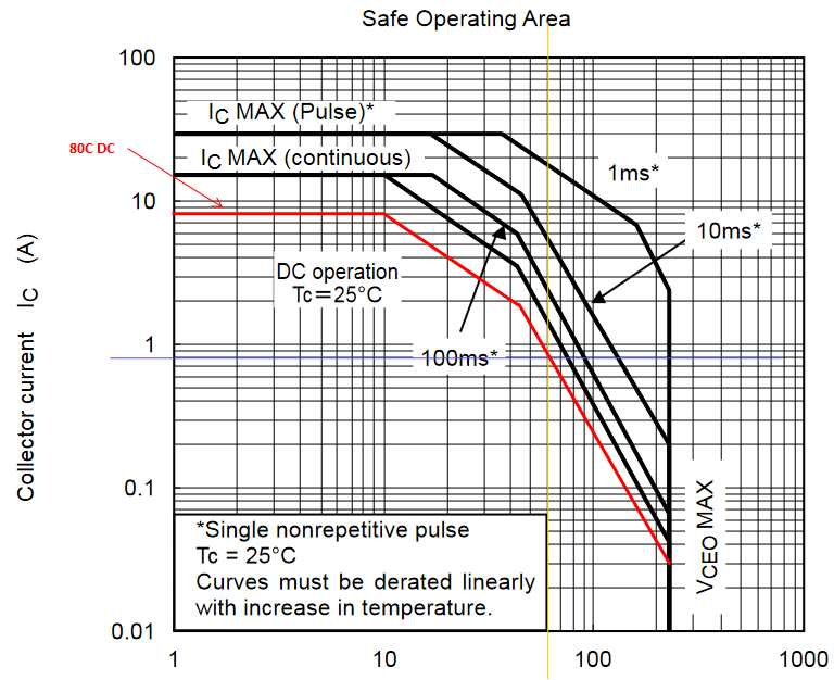

Look at the derated SOA below considering Tcase=80C.
6A with 24V is out of the DC line and enters in the non-repetitive area.
But audio is repetitive, so we shouldn't allow the transistor to go into that region.

As mentioned before example of Yamaha MX-A5000, 65V rails with single pair of OP transistors. Had one on the table few weeks back. All transistors 100% after so many years in use. It survived somehow.

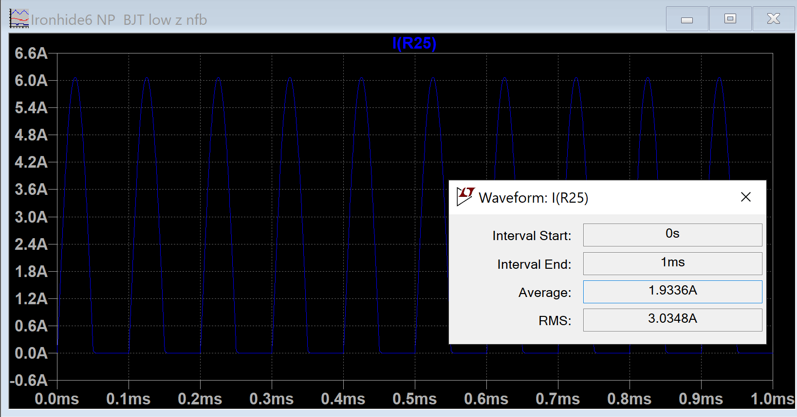

My example at about 60% of output amplitude (and so high rails) is extreme. Please look bellow at RMS current value (repetitive).

Let's consider your example 125W per pair and case temperature Tc=80C, so heatsink around 60 to 70C.My current amp (lower rails, bridged, left side of SAO chart) runs at about 125W per OP transistor (2sc5200/2sa1943) and did not managed to destroy it yet.
With 4ohm load, we need 22.4VRMS or 32Vpeak in the output. Let's allow 3V loss between output and power supply rail, so 35V on power supply under load. Let's consider 18% drop from power supply unloaded to loaded, so this would need a +/-42VDC rails.
With resistive load, worst SOA scenario is 35/2=> VCE=17.5V and 17.5/4=> Ic=4.3A
It gets very close to the DC line, so it would be fine. You can operate it for hours, days continuously.
But, with a reactive load of 30deg, the SOA scenario is VCE=27V with Ic=4.9A.
In this case case, you get close to the 100ms line, so you really need a single shot fast shutdown.
As we can see, if pushing 125W per 5200/1943 pair, you do need special protection for normal operation - we are not even talking about short circuit condition or some speaker impedance drop below 4ohm along the frequency range, which can happen sometimes (3.5, 3.3 in some frequencies - it will depend on the speaker designer). Normally some margin is needed.
That Yamaha with rails of +/-65V (no load) is still risky.
The 2SC5949 / 2SA2121 pair is more robust than the 2sc5200/2sa1943.
The 2SC5949 / 2SA2121 derated to Tc=80C can handle 125W (DC) while the 2sc5200/2sa1943 can handle only 84W (DC).
Let's consider same 18% drop. 65*0.82=53V. Consider 3V drop, we get 50Vpeak at the output. This gives us 50*0.7=35VRMS.
Over 4ohms, we get 35^2/4=306W. A lot of power for a single pair.
50/2=> VCE=25V and 25/4=> Ic=6.2A. It exceeds the DC SOA region. And with reactive load, it will exceed much more.
And this is considering Tj=150C. I normally design to around Tj=130C wosrt scenario.

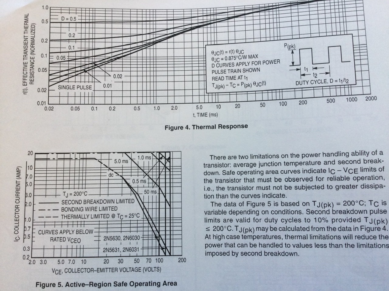

Old school data sheets specified that repetitive operation is ok provided that max Tj is not exceeded. The thermally limited portion of the curve (slope =-1) under pulse conditions indicated the dissipation level where a single pulse would reach 200C. Obviously, that de-rates with temperature, putting the thermal limit somewhere between the DC curve and the “single pulse”. As you go higher in temp, the thermal limit line keeps coming down, eventually overtaking the second breakdown limit.
Yes. If the transitor datasheet gives us data for calculating the repetitive region above DC, I'm safe to operate on that.Old school data sheets specified that repetitive operation is ok provided that max Tj is not exceeded. The thermally limited portion of the curve (slope =-1) under pulse conditions indicated the dissipation level where a single pulse would reach 200C. Obviously, that de-rates with temperature, putting the thermal limit somewhere between the DC curve and the “single pulse”. As you go higher in temp, the thermal limit line keeps coming down, eventually overtaking the second breakdown limit.
I already build some switching mode power supplies using this region - most MOSFET datasheets have this information.
My concern is that when we are using a BJT, such as 2sc5200/2sa1943, whose datasheet clearly states that the regions above DC are for single pulse only.

Ok! Got you point. In fact, every BJT has a repetitive region above the DC, but we need to know the device's dynamic thermal behavior in order to define the duty cycle that allows a certain incursion above DC line.Those single pulse curves just show where the single pulse hits 150C. If you HAD the transient Rth data (like in the 2N5631 data sheet) one could calculate for any duty cycle. They don’t seem to publish this anymore.
What happens with the 2sc5200/2sa1943 is that they don't publish this data or no longer publish it.
