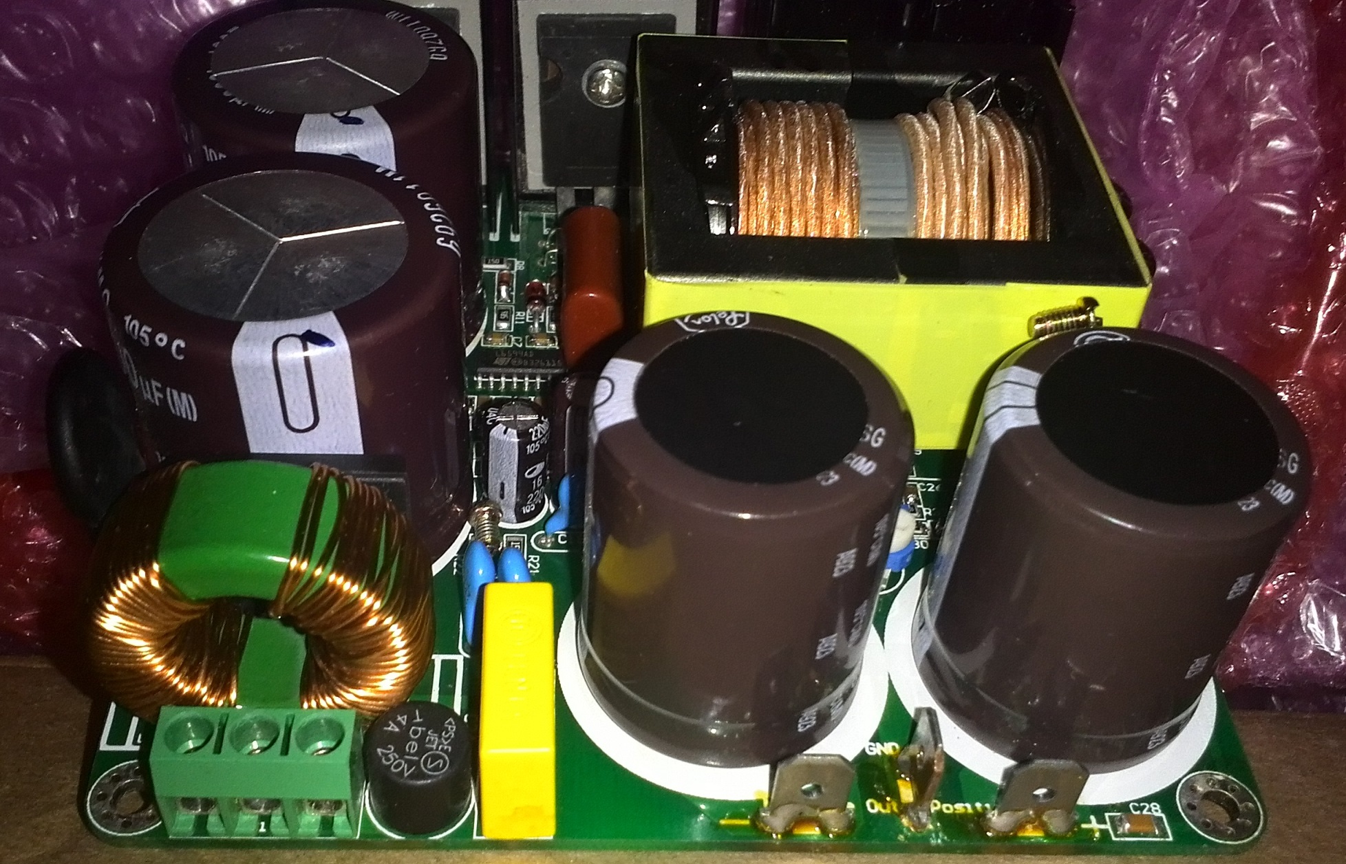

picture 3. the SMPS as arrived. with the screws in the same position.

3) So? The screws were in the euroblock when it was packed. Obviously bouncing around the world loosened them. That wasn't the cause of the issue. Shall we revisit the spade connectors that were so poorly soldered that they came right off the board straight away?
Yes the SMPS works but has not been put to use as yet since I was able to replace it with other product TWICE in the time it took to actually resolve.
