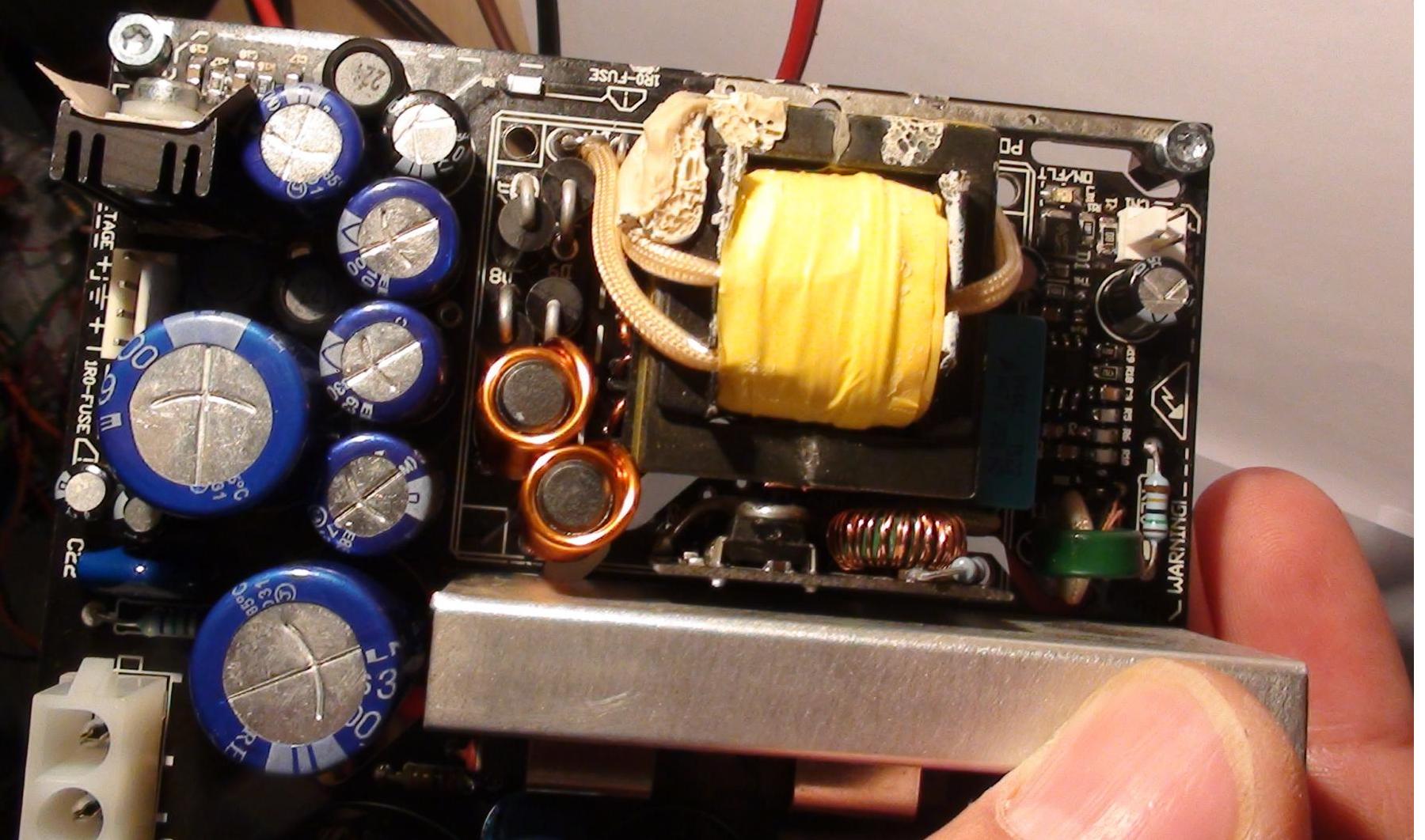

Last year I think it was a thread on diysmps. Somebody tried reverse engineering of SMPS400 and DPS-400 Powersupply. Thread is deleted maybe, cannot be found but I kept some of the pictures and remember the comments about poor assembly and quality in general.

Thank for show, what is wrong? components low cost? Not see.
poor assembled? not see.
GoldAmp reloaded?....pcb have printed date, it's 2005/08.
a part this is old version but...no problem. at short I show the complete doc and photo of this magic smps (last release, as buyed on GB).

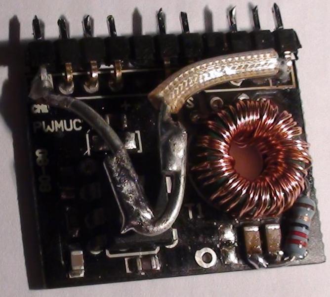

Yes there is very poor assembly! Please see the picture I posted with the red arrows.
On the right side there is a through hole resistor directly soldered to a smd pad. Not a good connection.
On the left side there is a uninsulated wire directly soldered to the right angle connector. 2 problems: no insulation on the wire and bad soldering practice.
In the middle there are two other solder joints between wires. Also 2 problems, no insulation and mechanical weakness. If there is too much heat the solder joint can break apart and cause all sorts of problems...
Also, this small board has no insulation from the transformer or the metal heatsink in the third picture, maybe it was removed by the person making the photos, but if it is like this from production, and no insulation in a small 2-3mm gap then it is also a very poor standard of assembly...

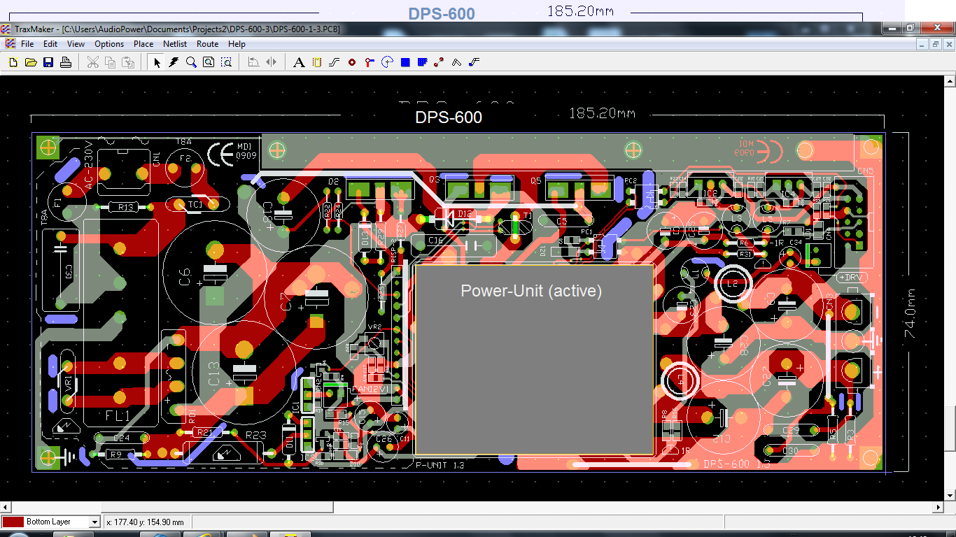

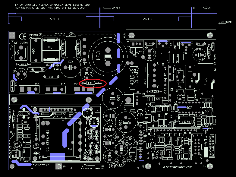

You can invent everything about these products except 2 things.
AudioPower quality, well-known and also visible.
MDI is the team search for AudioPower, I can assure you that smps for audio, are for Audio, not for lamps.
with the GB, I wanted to show that with very little money, you can have great products, as the new DPS-400 ELNA capacitora bank at € 65. I help some competitors to change the Philosofy and stop to sell a smps which costs 10 € at € 150 with poor performance for audio amps.
