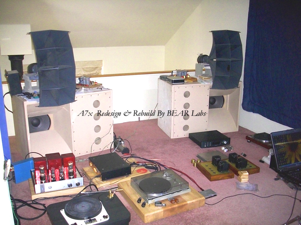

One thing I was not clear on, is that I replace the big open "vent' with a baffle board, sealed that includes 4 large diameter ports... this way they can be tuned.
The Great & Mighty BEAR Labs A7x
This is one that I did up now more than a decade back, iirc.
Still kickin' butte today!
Not in this system, or location - this picture not my place either.
But note the ports instead of the open box vent?
