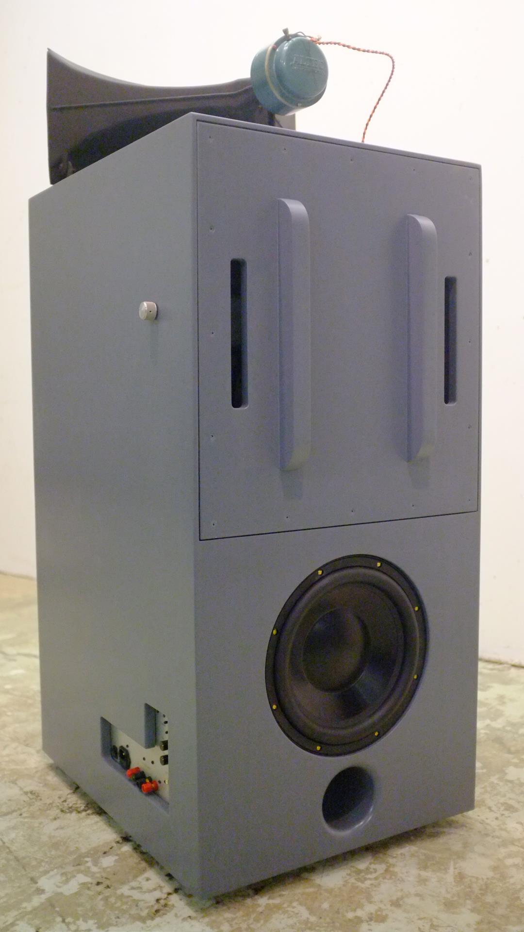

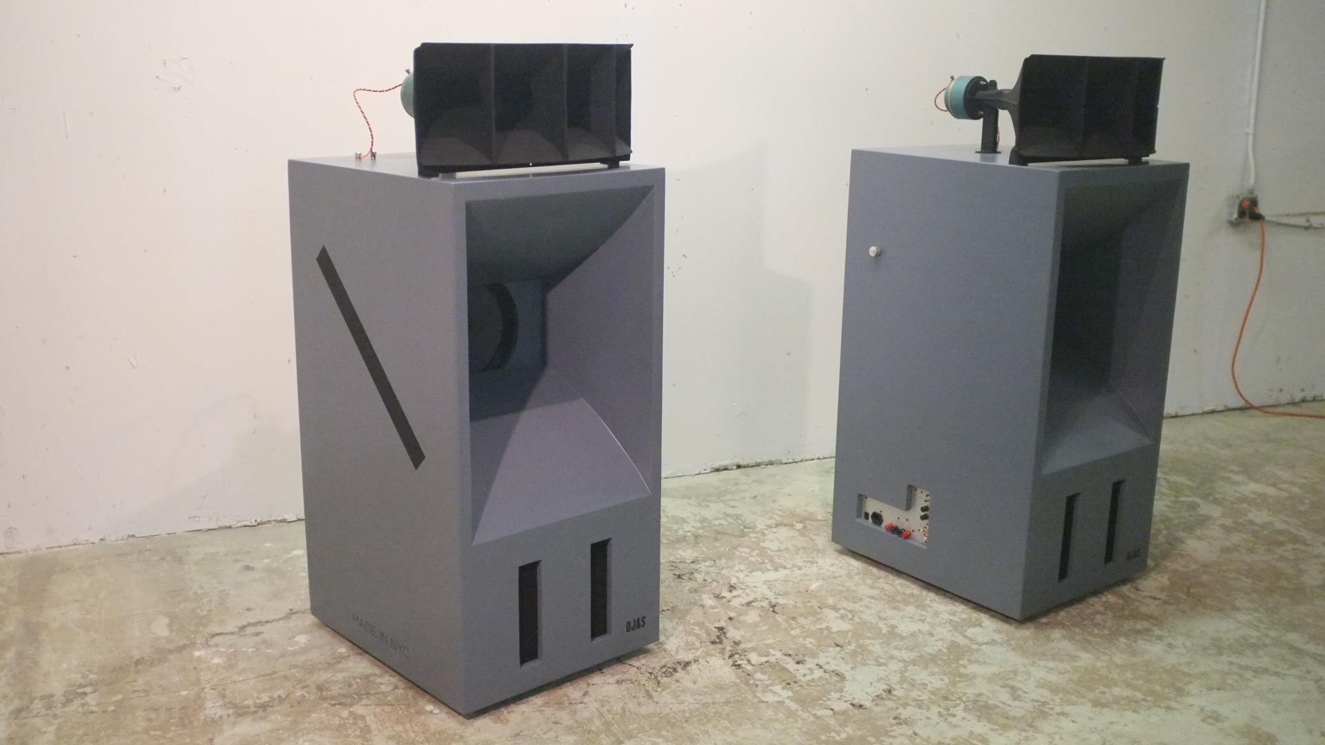

Built a 2/3 scale reproduction of A7 cabinets designed for 10" drivers. Horn is a Heil AMT transformer with an extended waveguide. This project has been assembled from items I have accumulated, so not a big budget production. Nonetheless, I did pay careful attention to the plans I found online and am proud of the outcome. Problem is that the only 10" drivers I have are lower quality and designed for sealed cabinet. I have a 2 LR crossovers built for 1200Hz and 1500Hz that I have tried, but the mid-bass seems muddy and I suspect it is due to the driver not liking the vented design.
Any recommendations for a mid-bass that won't break the bank, yet provide better clarity? Amplifiers are in the 25W range.
TIA
TIA

The genuine design was made with a the 16" Altec 416-8B if I'm correct : it has a low resonance frequency but the cabinet didn't allowed to go lower than F3 80-60 Hz, maybe a little less in some rooms. So you must choose something close in the T/S parameters. Could a 2/3 sized cabinet will match is an other story, the load should match the driver you choose !
The Heil 1 is better upon 1k6, but maybe your horn will allow to us it lower : measurement will tell you !
The game with the FLH of the cabinet and the one designed for the AMT should be a smooth transition at the XO...
As for the wood : a thicker or another wood will not give you surely a better result !
Trained designers or experienced guys with the genuine A7 will have more accurate inputs !

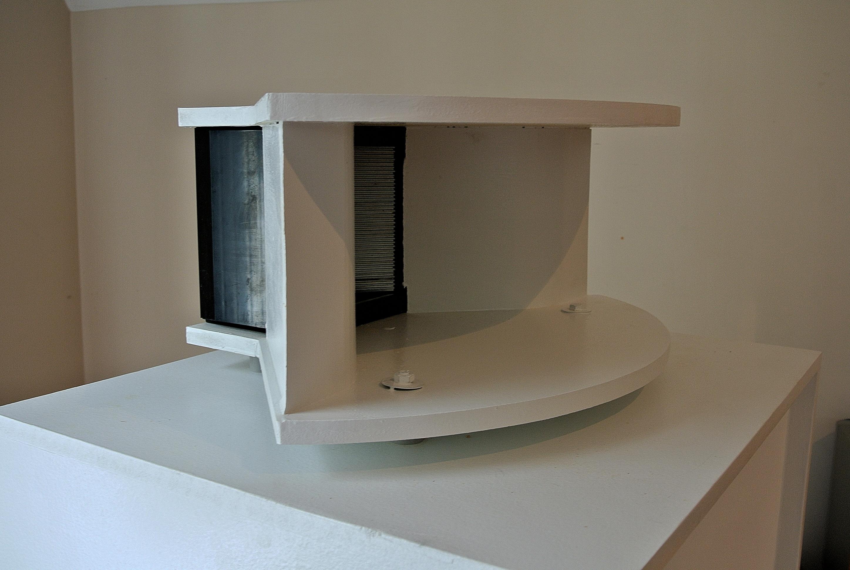

BTW, I couldn't be happier with the add on horn. Thanks to Jeff Poth for his inspiration. The AMT has always impressed me in whatever design I hear it in. They really are easy to work with and this modification seems to make it even more versatile.

Heil waveguide
A variation on this: Heil AMT1 And The Heil Horn Article By Jeff Poth
His design a is a bit more complex. I was just aiming a some improvement to an otherwise awesome driver.
Some thoughts : you should use an active design to save money because it is hard to find the correct XO and slope : a 2 way MiniDSP may save your wallet ! And also allow to apply some EQ as making bi-amp easier !
You have also the possibility to tune the "port" with a moving piece of wood to close more or less this apperture in relation to your room !
No, just was one of many drivers with similar specs used with the assumption that each app would be EQ'd as desired. The 803 was the original driver, which had a 50-60 Hz Fs, ~25 ft^3 Vas, ~0.2 Qts, which when coupled to a period correct amp with variable damping tone controls had an effective Qts up to ~0.38.
Regardless, a 2/3 scaled cab will have a frequency response, horn BW, cab Fb shifted up in BW, so guessing your Beyma might work well enough frequency response wise, though its Vas spec is probably too low to properly load the cab.

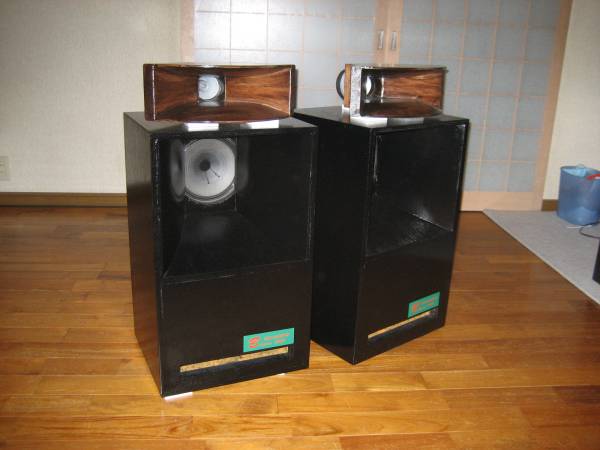

a coupe of years back(6 maybe) i designed a version with a 12 inch altec driver, i sealed the bottom of the wave-guide and used the bottom volume for a 12 inch sub
the altec driver was sealed and had a f3 of 80hz and the same a7 flare at 140hz
it was about 2/3 the size of the a7 and kicked *** as the sub was tuned to a f3 of 25 hz with a 300 watt bash amp, top was a 811 crossed at 800hz
presently its in a store in tokyo
i once saw a miniature a7 with a 5 inch fr driver and a 3/4, and one day i will build one for my desktop

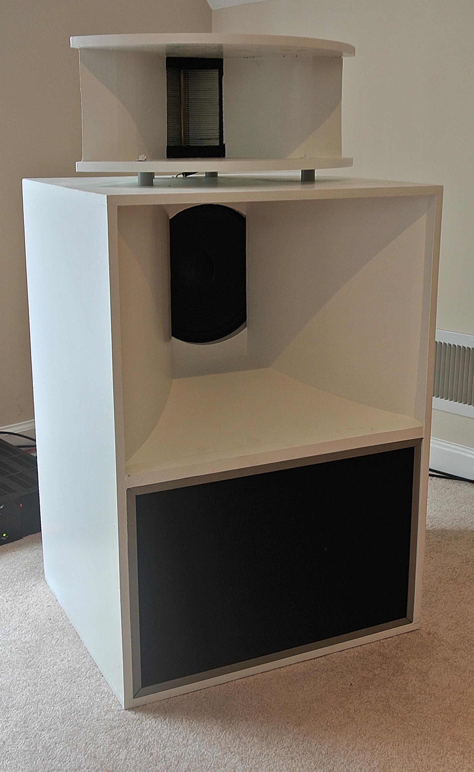

This is really fairly simple.
Two key points to understand.
First, the A7 was designed as a PA speaker.
Second, the front loaded horn was designed to increase the SPL above the direct radiator's (the speaker's) normal output level so that it might nearly reach the LF limit of the horn above at about the same SPL.
Not hi-fi.
Never going to be hifi IF used per the original design.
Can't be.
So, skip the horn part for the moment.
You have a box of some volume. Figure out the volume.
Now you need to run box simulation programs and see what TS parameters will produce LF output down to some frequency you can live with.
My 2 cents worth says that is 40Hz or lower.
Next you need to figure out what relative sensitivity you need for that driver.
Of course you are fighting the parameters. Bigger drivers have higher sensitivity (all other things being the same), but have a larger VAS, which means LESS LF extension, in the same volume.
IF you are biamping - DEFINITELY a very good idea. Otherwise you will need to pad the HF section down considerably to meet the LF.
So now you have the balance points, VAS vs. Vb, and F3 vs Fb all vs. SPL.
Next you have to consider the effect of the acoustic response of potential driver candidates WRT to the effect of the front loaded horn. Usually this is a disaster for hifi.
You can compensate for the HF rise due to the front loaded horn in the x-over, of course defeating the whole point of front loading, but that's the price to pay for this box.
The advantage of the design originally is A) the rising HF response of the bass driver due to the front horn loading and B) the set back of the LF driver, permitting the acoustic center of the driver to be close to the acoustic center of the HF horn.
You don't have quite the same situation with the AMT as you would with an Altec 803 or 1003, or 805/1005 horn on top. Or even the 811 cast horn (ick, imo).
So you'll need to balance these factors to make this box usable.
I have done this box up, but used a JBL driver that was the modern equivalent of the one used in their classic 50's home horn. It had the benefit of a better VAS, lower F3 and so was loadable down to ~40Hz in the FULL size A7 box, without the open "vent" and with 4 tuned ports. Also I chose to make a hyper sharp cutoff low pass x-over which flattened the response of the horn rise. Then the client used a high power solid state amp (eventually...) for the bottom end. The result was fairly spectacular in a normal size room. We met the horn at ~300Hz. Higher up the problems become more difficult due to the polar response of the driver and the way the front loaded horn behaves.
short version on driver selection for the smaller box, you probably want a 12" driver to keep the VAS down to a manageable value, so that you can get some LF out.
Edit: You designed it for 10" drivers, so best start by looking there. Due to the design, assuming enough space you could
change the throat board and use a 12" IF you found one that simulated better. The choices amongst 10" drivers may be
somewhat limited, but there are still quite many to pick from.
Edit 2: forgot to mention Qt. I'd aim for higher than usual Qt for your enclosure. Maybe ~0.30 - 0.35 will work out well. Low Qt drivers will likely fight you with F3 and VAS - again the balance thing, plus watch the response above that ~100Hz point - not the idealized one that some mfrs show, the real one.
