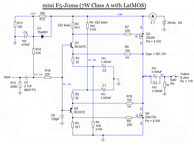

Hi EricWell, after some digging I found a way to test both type of lateral MOSFET. With a 24Vdc supply, I adjusted the Vgs to get a static Id of 100mA and then wrote down the required Vgs. Most 2SK134 require 0.7V to get Id of 100mA while most of my 2SJ49 require 0.8V to get 100mA.
I have found some matching pair of 2SK134/2SJ49 but I had a much easier time matching a bunch of 2SK176/2SJ56. Most 2SK176/2SJ56 needed a smaller Vgs to get an Id of 100mA.
Would it be OK to use the 176/56 instead of the 134/49 ?? They do not seem to be as popular on the web so I wonder if they sound OK.

Short circuit the input and put 10R resistor between the - pin of the output capacitor and the ground and measure the DC voltage across that 10R resistor. If it still shows some DC voltage it means that that you have very bad (high leakage) output cap.
If there is no DC in that setup then everything is OK, you can connect the speaker but instead that 10R use the few hundred Ohms resistor.
Input is now shorted.
Output has 8 ohm resistive load.
DC voltage at output is down to about 10mV DC.
Even with input shorted my load is warming up...I think I have some oscillation somewhere, my Id is up to 1.5A and it's not stable...
I haven't soldered C6 yet...could that be the issue ?

Load that heats up with input shorted clearly shows some mischief happening and the oscilloscope would help. In this situation 10mV reading is not reliable.Input is now shorted.
Thanks,
Eric
Install C6=330p and see what happens. If it doesn't settle down add 330pF-1nF parallel to each 150R feedback resistor.

Hi Fab,
I think I made some progress.
IF I leave the input floating (not tied to gnd) and I connect an 8 ohm load there is no oscillation, the Id goes and stays at about 600mA and the DC voltage is 3mV.
As soon as I touch the input with my finger or trying to connect a music source the Id goes wacko up to nearly 1.6A
My problem seems to come from the VAS, I will try with a smaller cap. as you recommend.

Eric,
since our bodies are big conductors, touching the input means introducing the signal induced in our bodies (mostly 50/60Hz and harmonics) to the amp so the behavior you observed is normal.
Did you solve oscillation problem (heating of the load without a signal at the input) and how does the amp sound to you (are any anomalies present) ?
Hi Juma,
Oscillation problem was due to some sort of ground loop I created with my bird nest set-up, by changing 2 gnd locations solved the issue, not even sure if I need C6 but I will add it. I'm using and will be using a SMPS for this amp, it's like a laptop supply (brick) but rated 24Vdc, 5A. Worked like a charm with my ACA and JLH (floating outputs to create a bipolar supply) so I didn't see a reason not to work with a similar rated output class A amp. Your amp which I call 'mini F5-Juma' is dead silent, just as it should be. There is no anomaly with this amp.
The amp sounds quite good but it's hard to tell with a mono set-up and an inefficient spkr (EL-70 in BR enclosure), it does indeed plays nicely but once the stereo unit is built and connected to my FE-206E I will report back.

Good - a false alarm 🙂 I was a bit surprised because I didn't have any oscillations problem even with a point-to-point prototype. Darn those spaghetti wires... 😉
Had the pleasure to listen in stereo tonight ;-)
How did the bias of 0.7A came about, trying to understand it. My JLH which works at +/- 14Vdc (28V total) needs a bias of 1.3A to provide an output of 10W into 8 ohm, the JLH amp dissipates 36W/channel at idle but your slightly less powerful amp which is rated about 7W has a bias of 0,7A and dissipate only about 17W at idle...smaller power supply and heatsink therefore overall reduced cost for about the same power...this is great but how is this possible..I'm scratching my head since the few SS Class A I have built are normally about 25% efficient. Yours is more like 40%.
Schematic I have used is attached.

(MOS)FET's transfer curve follows the square law which enables it to stay "longer" in class A (when undegenerated) compared to BJTs used in JLH (exponential law transfer curve) - read more about it here (pages 6-8):
