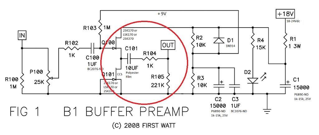

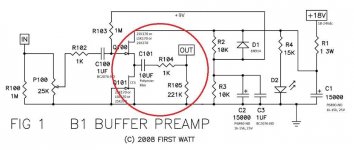

Question : If I was going to insert the B1 in there what JFET could I use instead of 2SK170, LSK170 or 2SK370...these seems to be very hard to get, is there any new component that are easier to buy (buying 2SK170 now is risky, I like genuine stuff)
Would I only need to add the 5 circled components to buffer my volume, the rest seems to be already in the amp ?
Eric

I would save that for later. Right now it would be OK to test the 10k pot at the amp's input (I suppose you want your pot inside the amp, without long cables between the pot and the amp) and if you have no complaints, the buffer might not be needed...
Juma has given details of a bf862 version of a buffer that is almost identical to the B1.
A jFET source follower with jFET CCS load.
